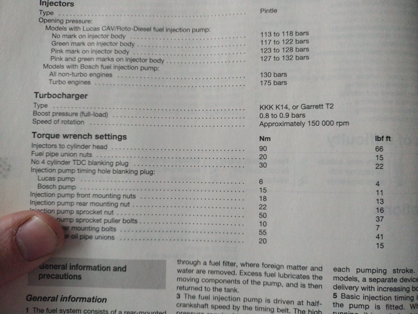

Rhothgar wrote: 07 Jun 2023, 19:55 Just wondering whether to give the injectors a good tweak?
Does anyone know the torque they are supposed to be done up to? I’m pretty sure I will have replaced the fire washers when I did the head.
Whilst I have it open:
Injector to cylinder head 90Nm
From the Haynes for ZX diesel

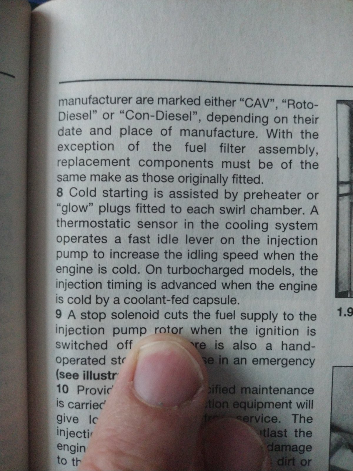

But reason I opened it was this bit:
Cold timing advance
Cold timing advance
Which reading again confuses me as sounds like a separate device raises the cold idle speed (on all diesels) to a "capsule" that advance the turbo variant timing too
