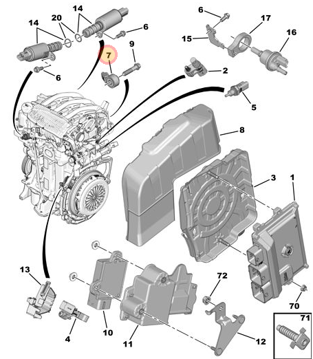

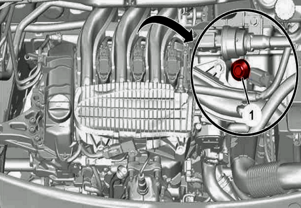

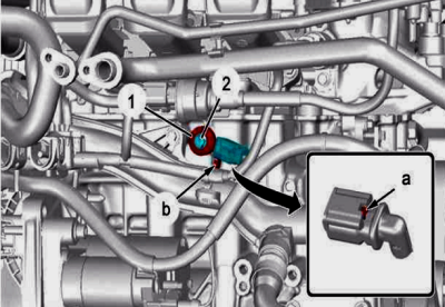

Here's the knock sensor:
Item (7) Engine Knock Detector, part: 594631, £27.53

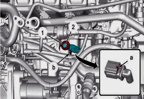

Dismantling
Location
Disconnect the battery following the BSI Reset / Battery Disconnect / Reconnect Procedure
Chock and lift the vehicle on a column lift.
Remove:
  • The (2) bolt
  • Knock sensor (1)
Disconnect the connector (Press the tab at "a").
Refitting
Connect the connector (at "a").
Refit:
  • Knock sensor (1)(Check that the lug is positioned correctly in relation to the notch ) (at "b")
  • The (2) bolt
Tighten the Knock detector bolt to 2 daNm.
Reconnect the battery following the reconnection part of the BSI Reset / Battery Disconnect / Reconnect Procedure.

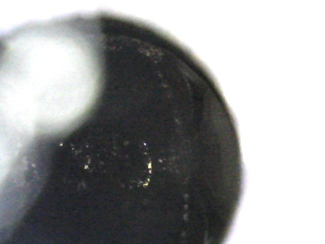

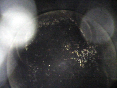

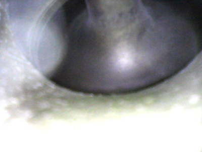

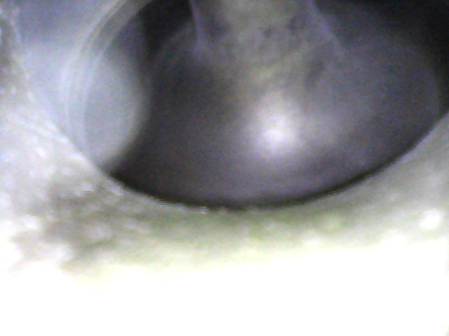

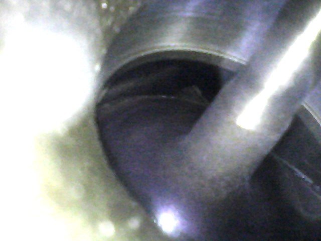

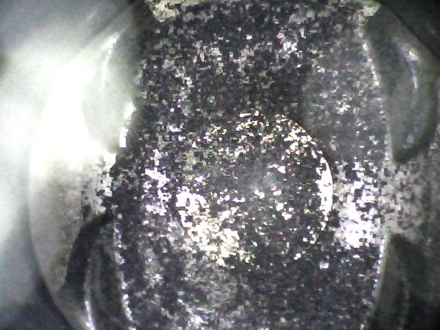

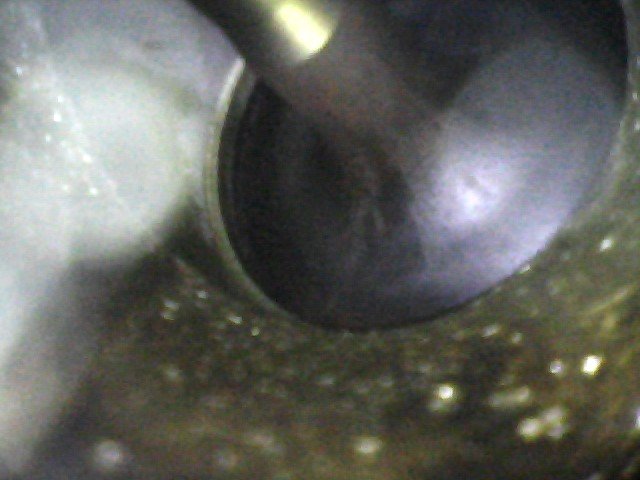

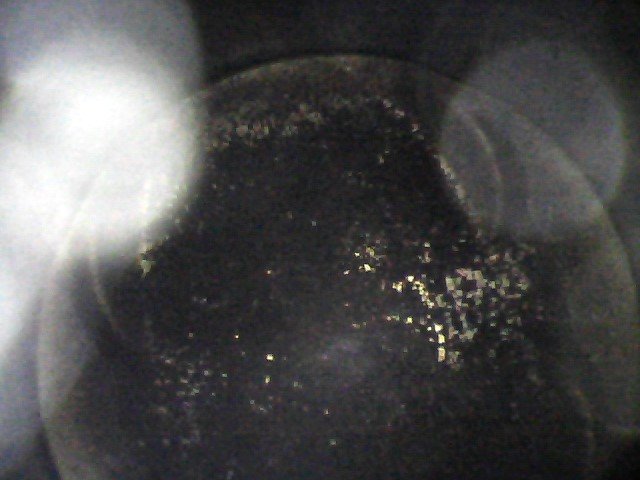

I grabbed some snaps with a cheap usb borescope, down the bores and into the inlets. Piston crown 2 looks a bit cleaner, as expected. Valves look all pretty similar to me.
timing end
timing end
middle
middle
gearbox end
gearbox end
timing end
timing end
middle
middle
gearbox end
gearbox end

Re: 208 1.2 petrol wont rev over idle
Unread post by tmead »
I'm a little worried that the high oil level may be because the lack of compression in #2 means the fuel has been running past the rings down to the sump. There is little point in doing much with this unless I take a look at the bore I think, that amount of fuel must have washed any oil off long ago ! The diluted oil in the sump will also have been doing a poor job of lubricating big end bearings etc too.
Trouble is even though there must be thousands of these 1.2 engines out there, they dont seem to pop up too often on ebay. The ones on there are crazy expensive (around the grand mark or even more). theres a few breakers with damaged complete cars that I will message to try to get a more sensible price. I'm not limited to a 100 quid clunker, but I'm hoping for around the 500 quid mark.

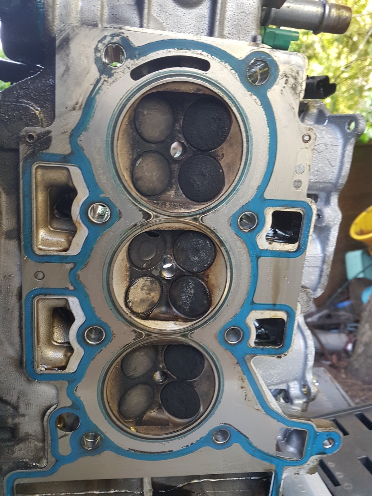

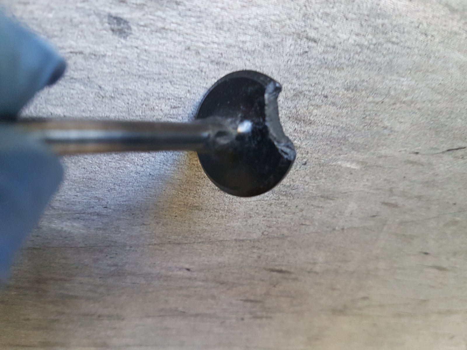

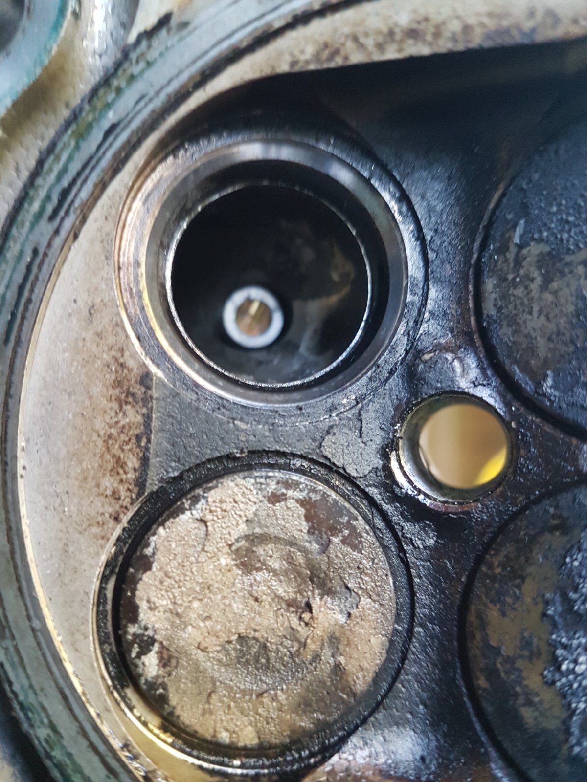

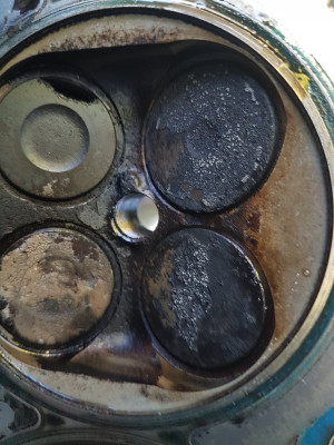

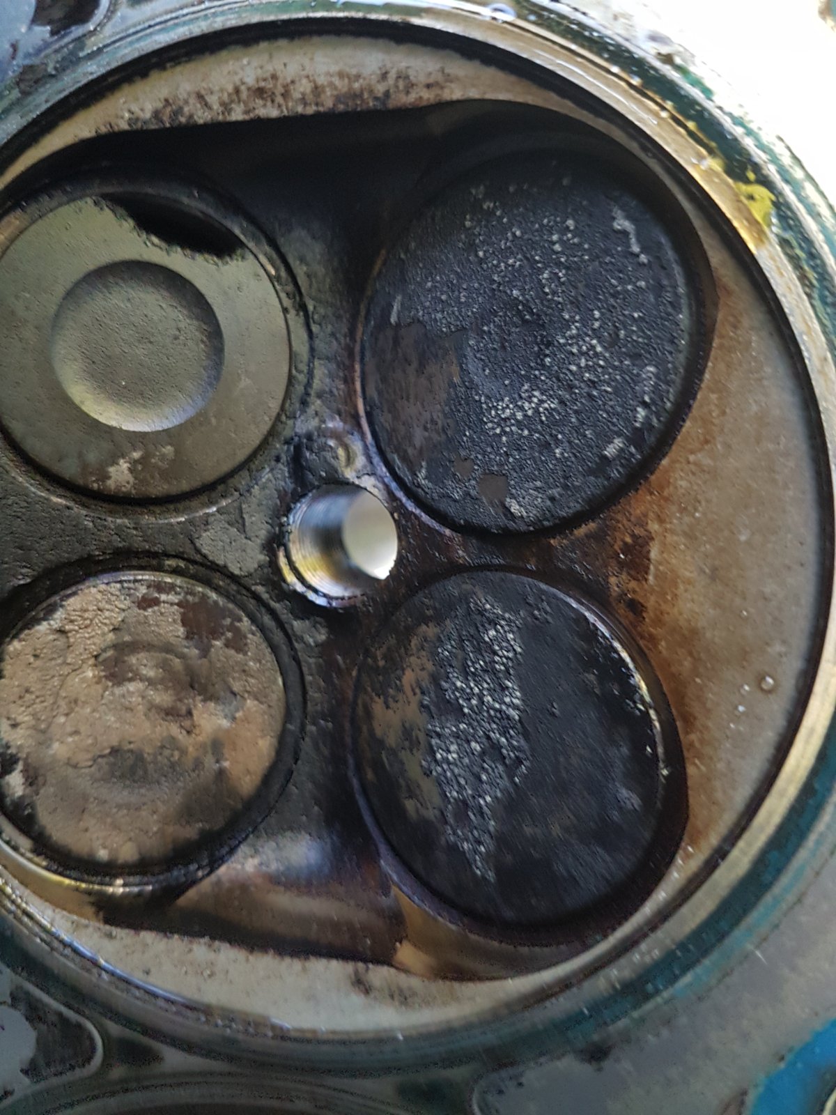

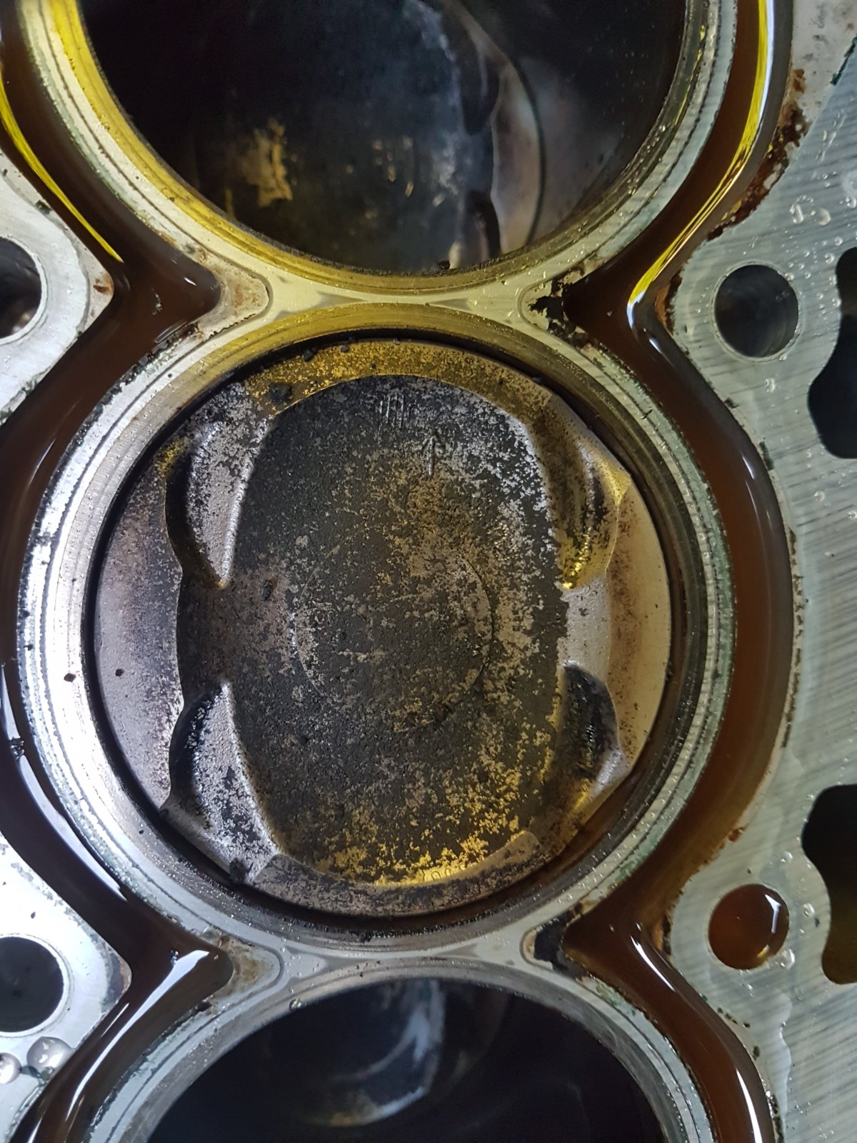

well I guess this answers the question !
Can you see the problem ?
head view
head view
There doesnt seem to be any marking on the piston, cylinder, valve seat or head, so I cannot figure out where the part of the valve went.
I don't think I will take on replacing the valve, with associated rafting around with setting clearance and lapping it in. Also I have too many concerns about where the piece went, and what the bottom end is like with the possible thinned oil. Time to look for a replacement engine.

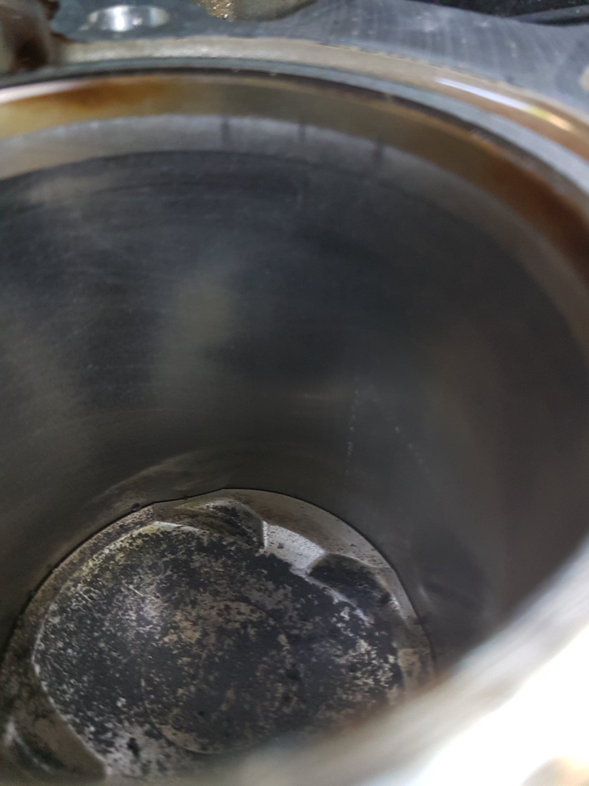

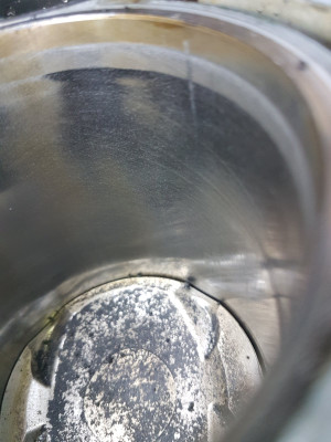

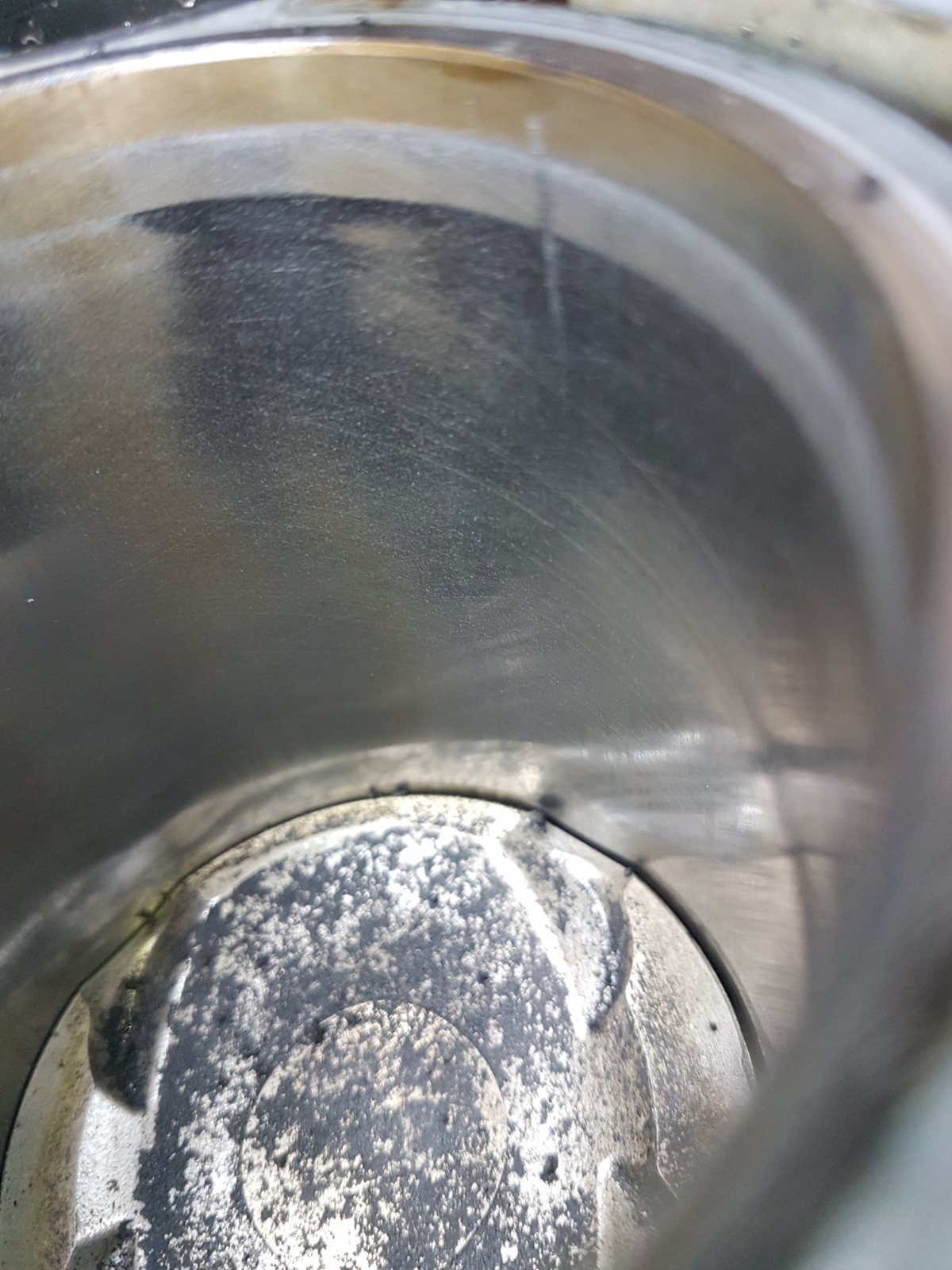

Just wondering what people think - I can feel movement in the pistons front to back when i push on the piston crowns, and see them move a little. There doesnt look to be massive wear in the bores, I can almost see the honing marks ?
I was expecting a piston/bore clearance of only a few thou, and the pistons look to move more than that.
I think the engine is going to be swapped out, as I can't take the time to rebuild it.
ozvtr
Posts: 853
Joined: 13 Oct 2020, 01:11
x 234
Unread post by ozvtr »
The honing marks are clearly visable in the pictures.
I dont know what the piston to liner clearance would be but most of the compression is contained by the rings.
If you can rock the pistons backwards and forwards then the rings are free and not "gummed up".
Apart from the scoring on the liners, the cylinders and pistons look good. Can you catch a fingernail on the score marks?
The tops of the inlet valves are super clean!!
The bizarre thing I find is that there is no carbon build up on the back of that valve and the valve seat looks very good (well from the photos anyway).
Have you looked on the top of the catalytic converter for any chunks?
How many miles has this engine done?
Does the engine run a chain or belt?
Unread post by moizeau »
I can't help you regarding your specific engine but to give you an idea of piston and cylinder wear limits these are from my genuine Kawasaki Zephyr 1100 workshop manual.
Cylinder, standard measurement = 73.5mm, service limit = 73.6mm
Piston, standard = 73.442mm, service limit = 73.29
So with both being on the service limit to piston to cylinder gap would be 0.31mm
Piston ring end gap, standard = 0.2 / 0.3mm, service limit = 0.6mm (Top ring)
On some engines you can remove the pistons with the engine still in by removing the sump and pushing them out the top with the conrod.
Thanks @moizeau, that is comforting ! The only info I saw in a quick web search showed much less clearance, so i was worried about the thinned oil having lead to excessive wear. Looks liike it may be pretty much in line with a 70K engine. I'm still not sure about faffing with a valve and setting up clearance etc. I've a few irons in the fire about a replacement engine, so lets see how that works out.
