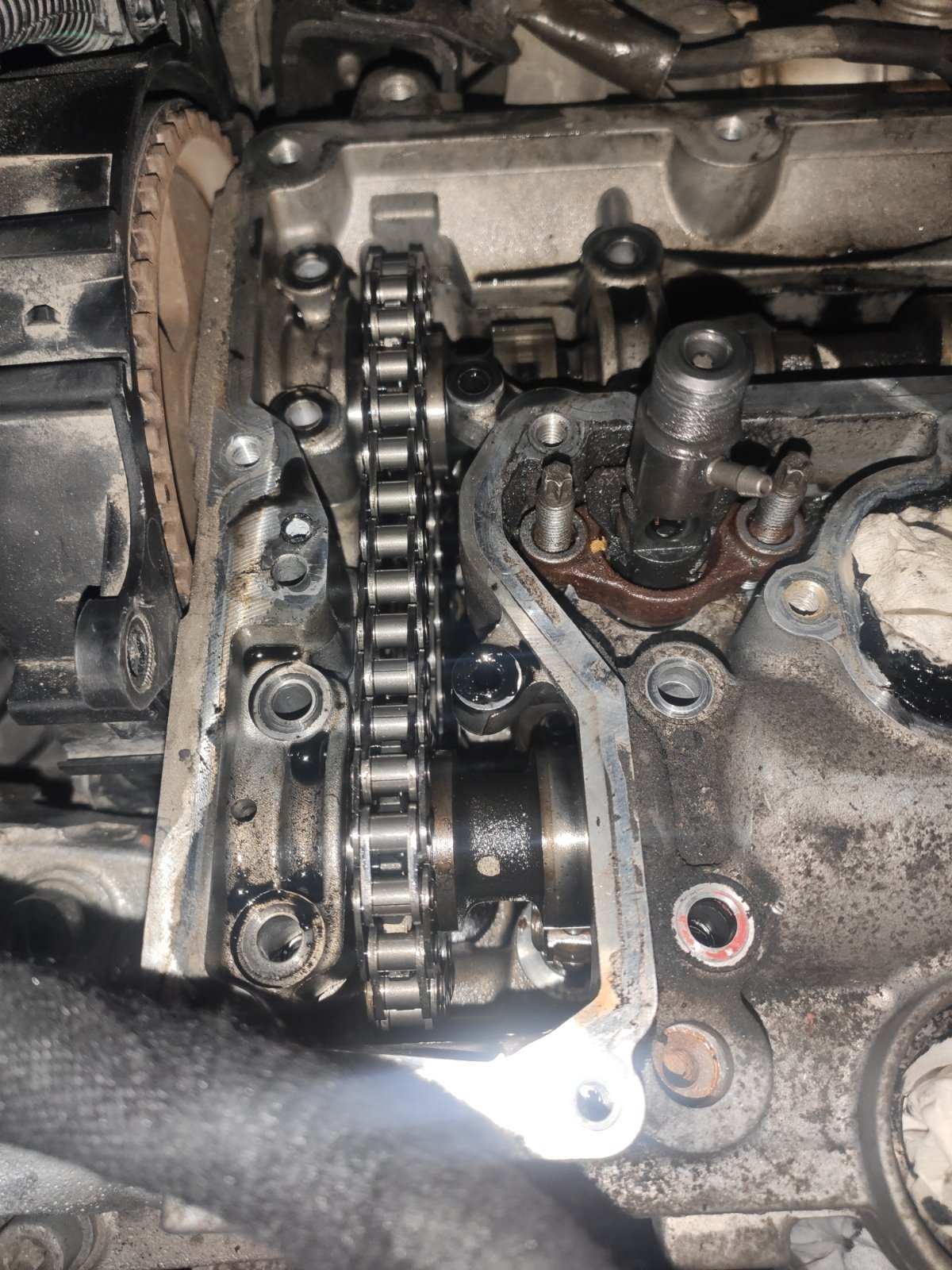

Extractor tool finally arrived, unfortunately it's the wrong one. I picked this one on autodoc because it explicitly stated for DW10 coded engines but apparently not mine. Does anyone have any hint on the tool required for the job? (or any alternative to get those injectors out)

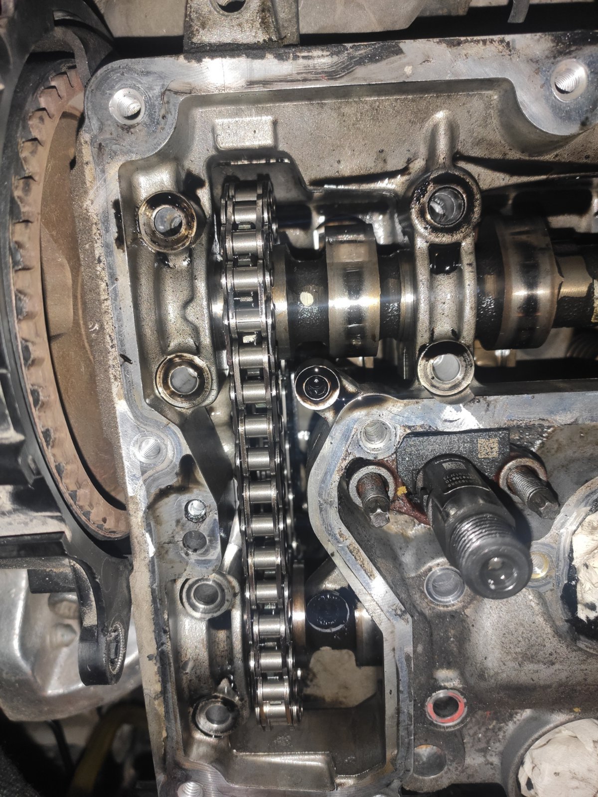

Have you got any pics of the top of the injectors

I managed to remove 3 bit the fourth is very stuck, a blow hammer didn't help muc (probably moved it half a millimetre)

If I see it correctly you still have timing belt and chain on it. Bolt the chain tensioner on, wind injector holding nuts to the half and crank the car (with additional power supply / battery). See if compression is enoug for injector to be pushed / fly out...

Thanks for suggesting this but (un?)fortunately I managed to pull the injector out for about 1mm. The cilinder is not tight anymorekantica wrote: 09 May 2023, 17:23 If I see it correctly you still have timing belt and chain on it. Bolt the chain tensioner on, wind injector holding nuts to the half and crank the car (with additional power supply / battery). See if compression is enoug for injector to be pushed / fly out...
