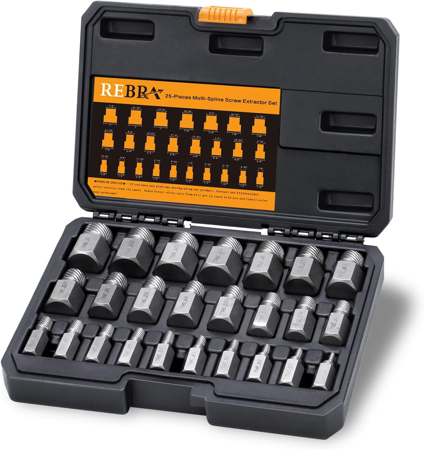

Doo wrote: 30 Mar 2023, 20:45 I recently experienced gorilla stupidity when helping a friend with her BMW Mini (T50 torx were chewed no end :roll: ).
This prompted me to buy a torx/Allen equivalent to the Irwin sockets (the flats are replaced with a screw type surface which grip the damaged bolt head) which have a screw shape to bite into the damaged torx or Allen insert. They cost almost £60 so I'm expecting decent results.

Jay-Bruce wrote: 02 Apr 2023, 13:22
NEVER understood these absolute MORONS who get a spanner and a 30ft scaffold pole (well, you'd "think" that was how they applied torque) to do up nuts & bolts #-o
Those sockets sound gucci AF, could you post a link to them?
I can't find the link (Amazon being a male part..) but I believe they are called Rebra 25 piece screw extractor set. The box is black & orange and cost £60. There's a cheaper set, but I just went with the Rebra as they looked great. I used these on a friends Ford (from Hell) and got out several rotten torx head screws.

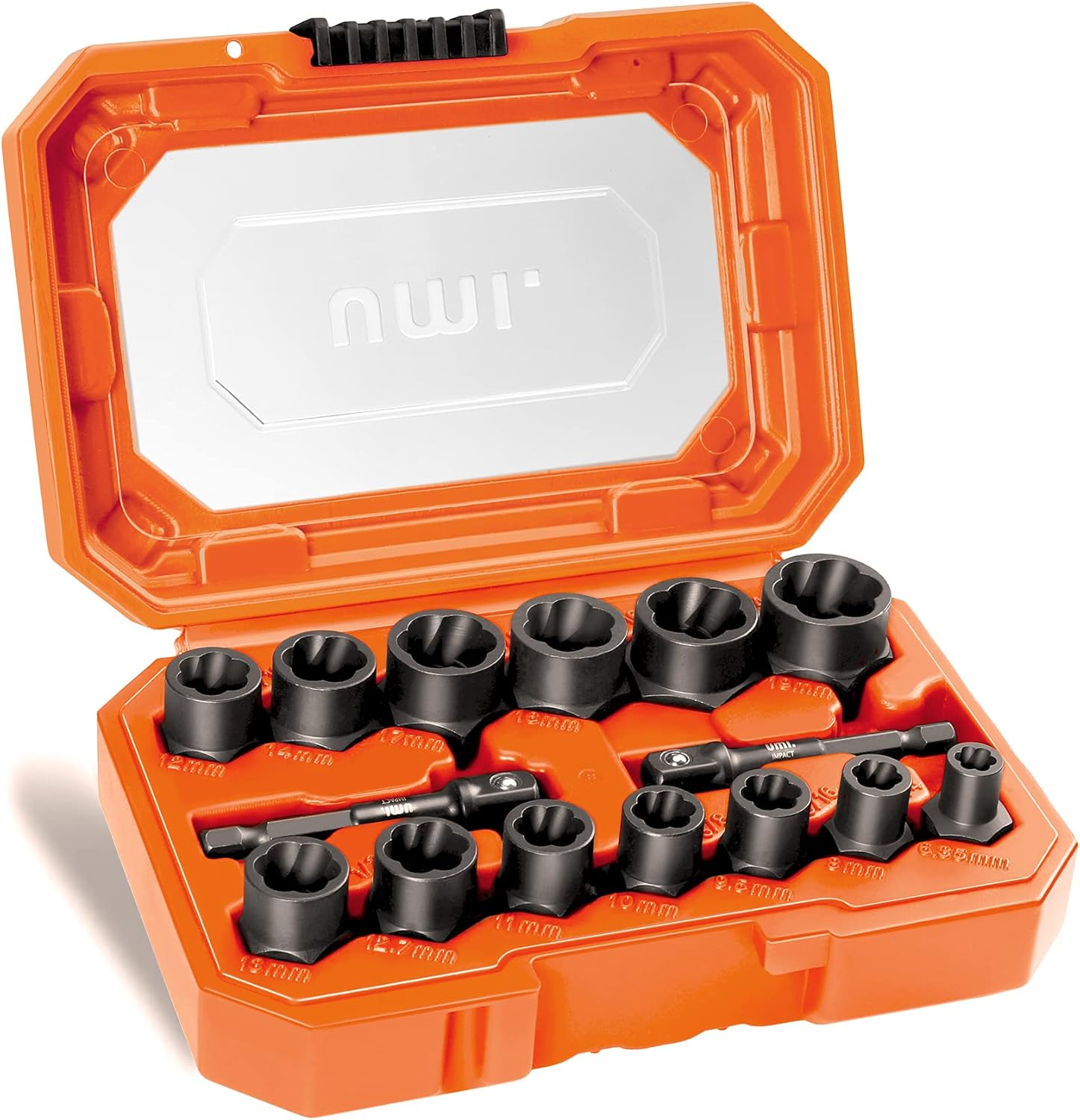

Edit, also, I bought sockets too. Sockets are called bolt extractor set and there's a choice, but Amazon brand, Umi 15 piece impact bolt nut remover set is what I went for. They are pretty decent and I managed a few tough jobs with them despite being 3/8 drive.

Cheers Doo, with that information I was able to find it, the link for the male set is: https://www.amazon.co.uk/gp/product/B0B5ZNWC5Y which is now in my basket :-)
I already have the Irwin equivalent of the other tool you describe, but in case anyone else needs it, as these things are a godsend, the link for it is: https://www.amazon.co.uk/Amazon-Brand-1 ... B08XJMYCW4

Irwin "knackered head" bolt extractors/nut removers have been mentioned favourably on this site before.

Paul-R wrote: 04 Apr 2023, 13:43 Irwin "knackered head" bolt extractors/nut removers have been mentioned favourably on this site before.
I have a set of those, not yet actually used them in anger! (Read as: not yet remembered that I have a set of them and tried them ahead of reaching for the angle grinder instead :-D )
Posts: 55172
x 8437
Re: Brake disk bolts
I've a set of Irwins and they're great...
Now very seriously considering getting the Rebra ones...
