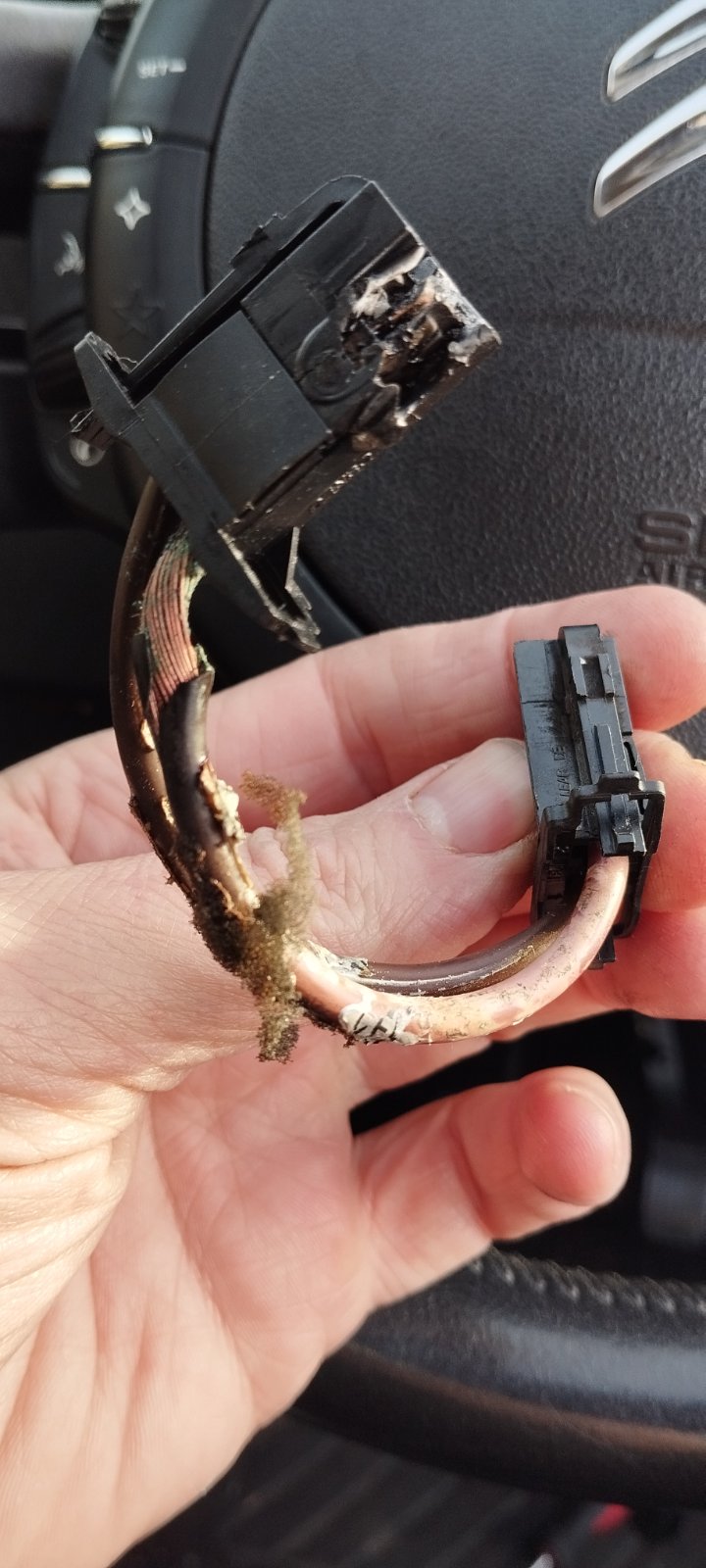

Is this the same plug that melted on your car. I have just removed this from mine as the blower has completely stopped working after being stuck on full speed for the last few months. If so could you please let me know where to buy it as I'm having trouble finding the correct part.
Thanks in advance for any help.
