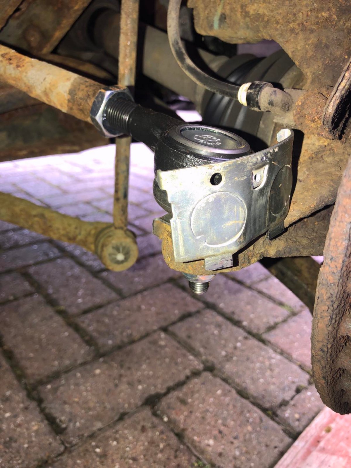

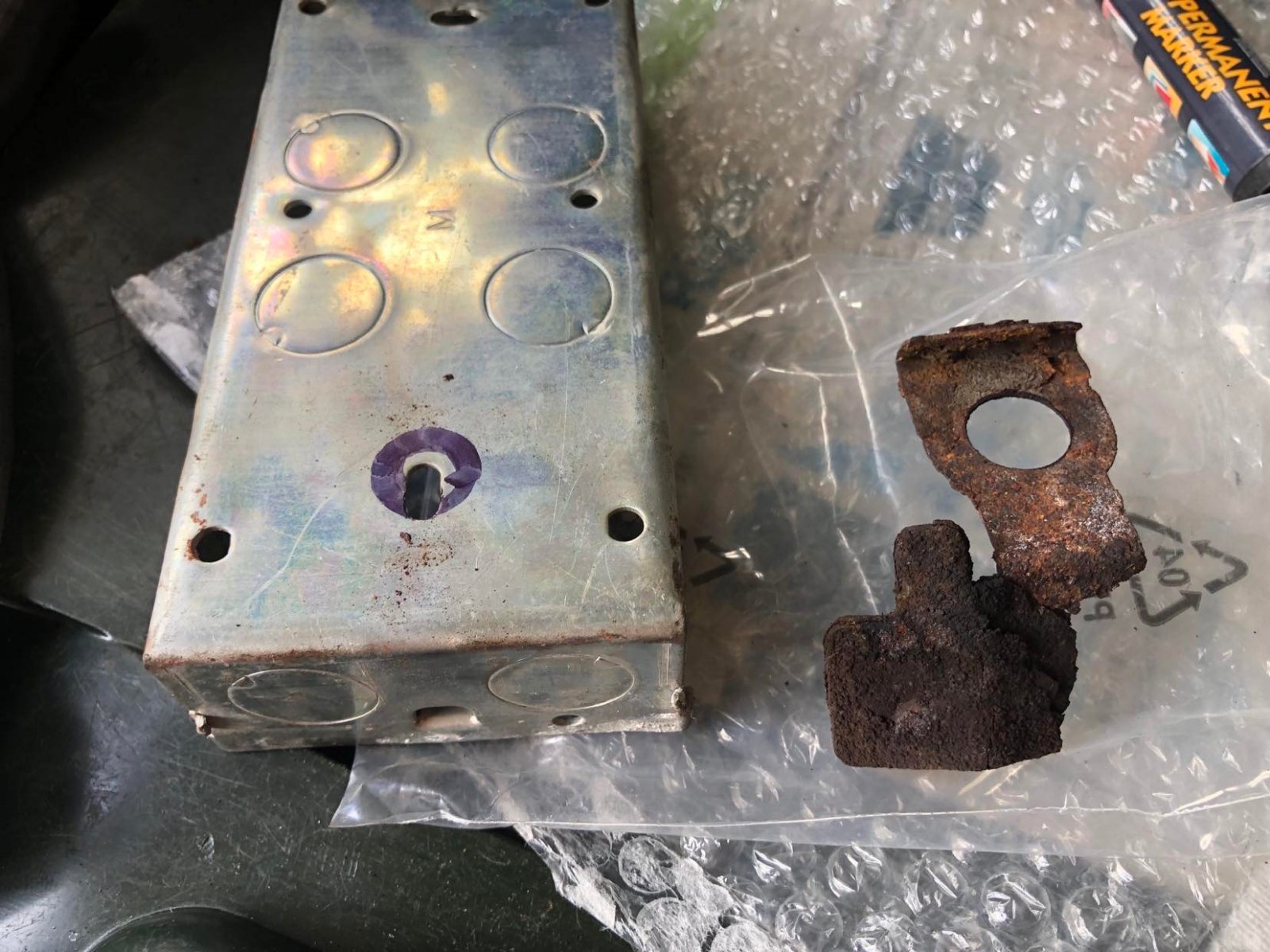

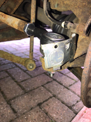

I took it home and re-aligned my steering wheel by 1 spline :yeah: I also made a dust/heat shield as the old one broke in half on removal :oops:

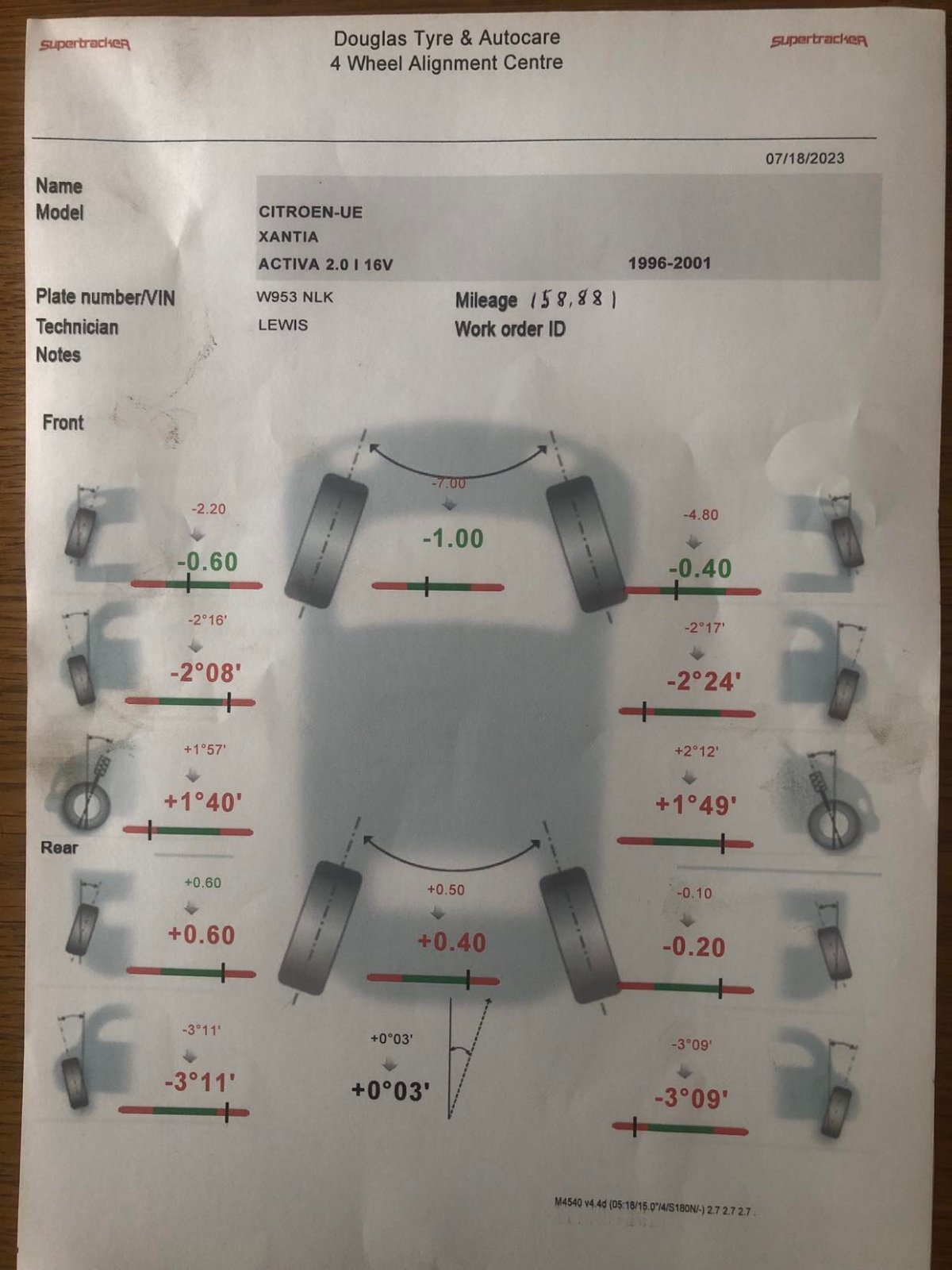

I got a printout of before (-2.20 [-7.00] -4.80) and after as well (-0.60 [-1.00] -0.40) (only noticed 'Activa' :dunno: after I got home)
Skull's Tracking
Skull's Tracking
My Haynes manual states Xantia Toe Out = 0 to +3mm but it looks like I am set at Toe In -1mm :?: If I've understood the diagram correctly :roll:
No doubt it will be a big improvement on the tracking I had previously, especially combined with all the recent parts fitted ....if I'm not happy I can always take it back for a tweek

Appears to be an angular measurement they have used although they are not showing degrees and seconds symbols on the toe in.
They are showing an angular diagram where the -7 is though...
ODD!
