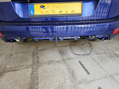

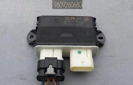

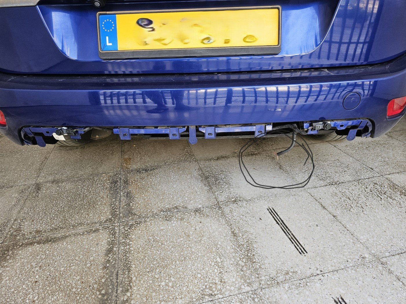

Good afternoon everyone,
I'm experiencing a similar issue with my 2017 C4 Grand Picasso. During a trip, I lost the lower black part of the rear bumper that holds the center parking sensors. Unfortunately, I later discovered that the "hands-full" feature no longer works. I noticed the parking sensors are intact but hanging from their connectors, and a three-cable connector is missing. I suspect this missing part is the sensor for the tailgate opening system, which I have already ordered and received as a used part.
However, I'm unsure about the meaning of the colors on these cables to connect them correctly without replacing the entire wiring harness. The three cables are pink, red, and green. Using a multimeter, I identified the positive, negative, and signaling cables as pink, red, and green, respectively. What I don't know is the correct position on the sensor itself. I would greatly appreciate any suggestions regarding this.
