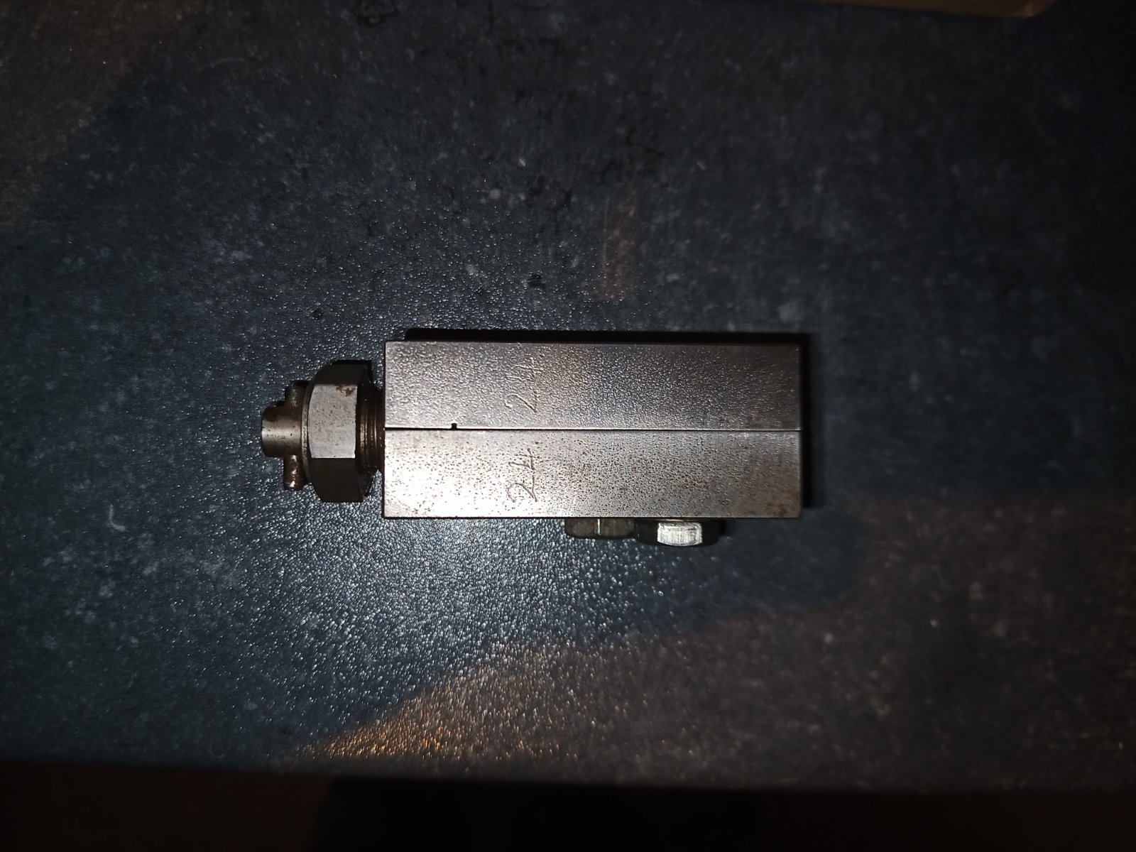

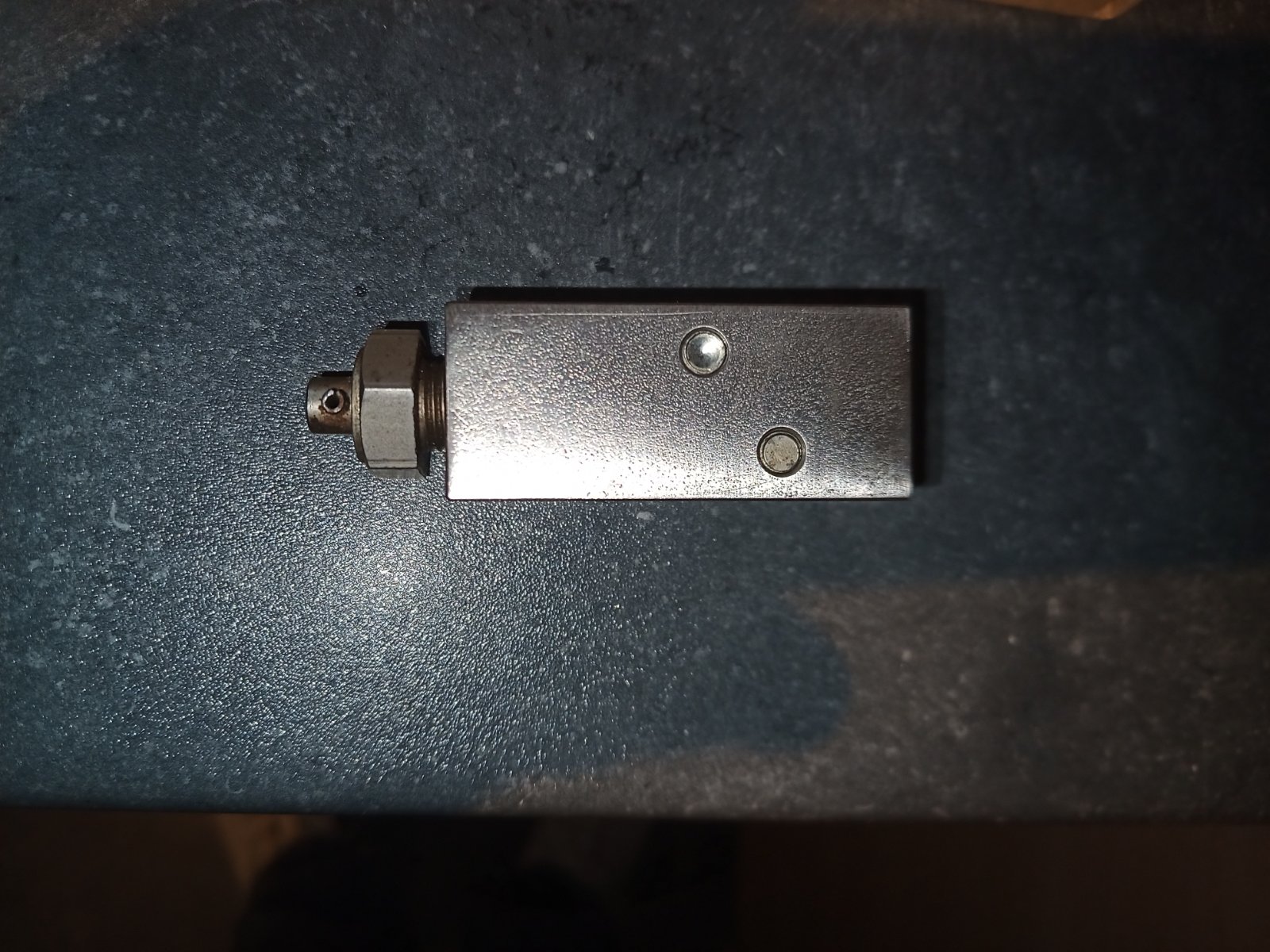

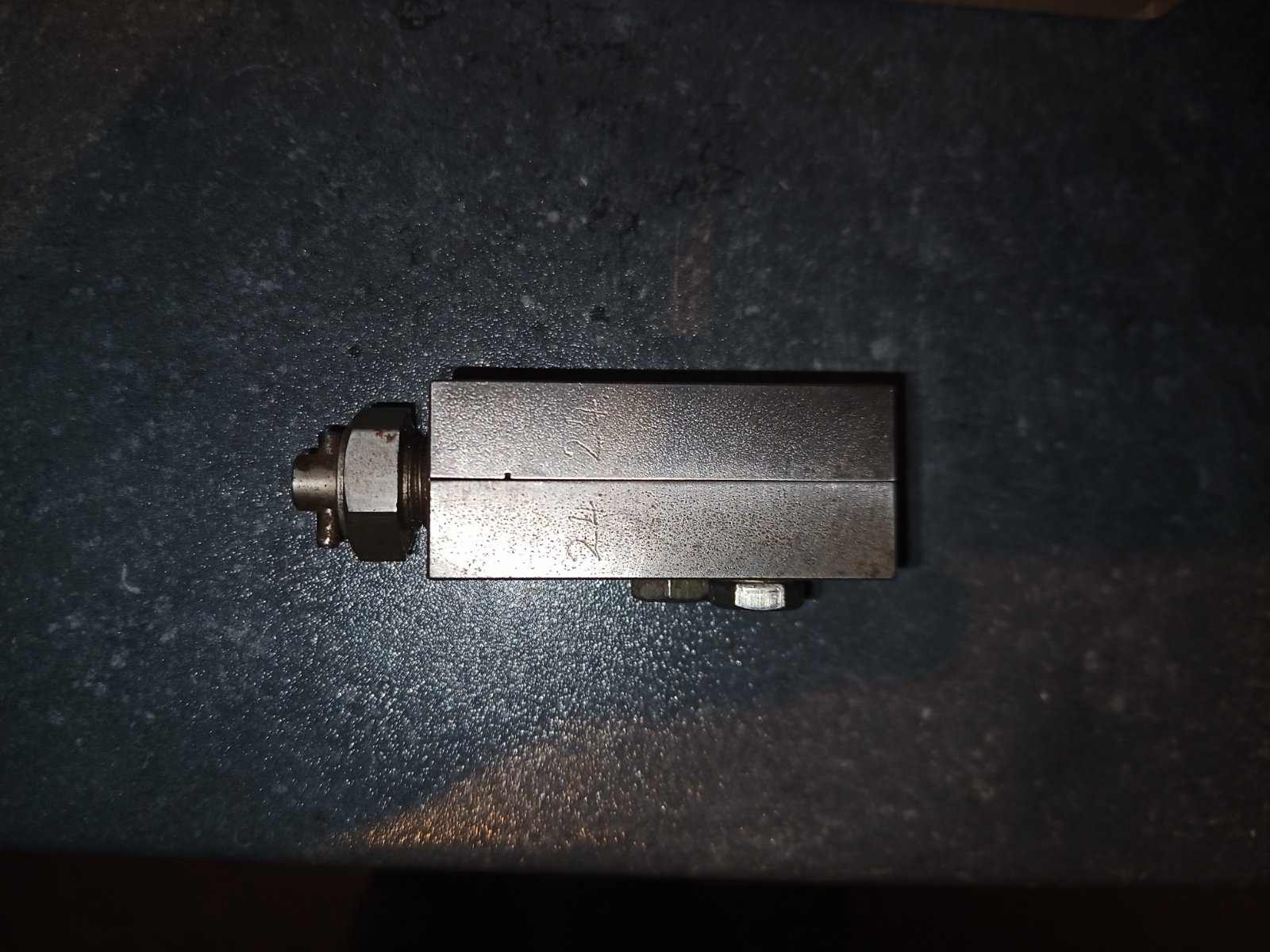

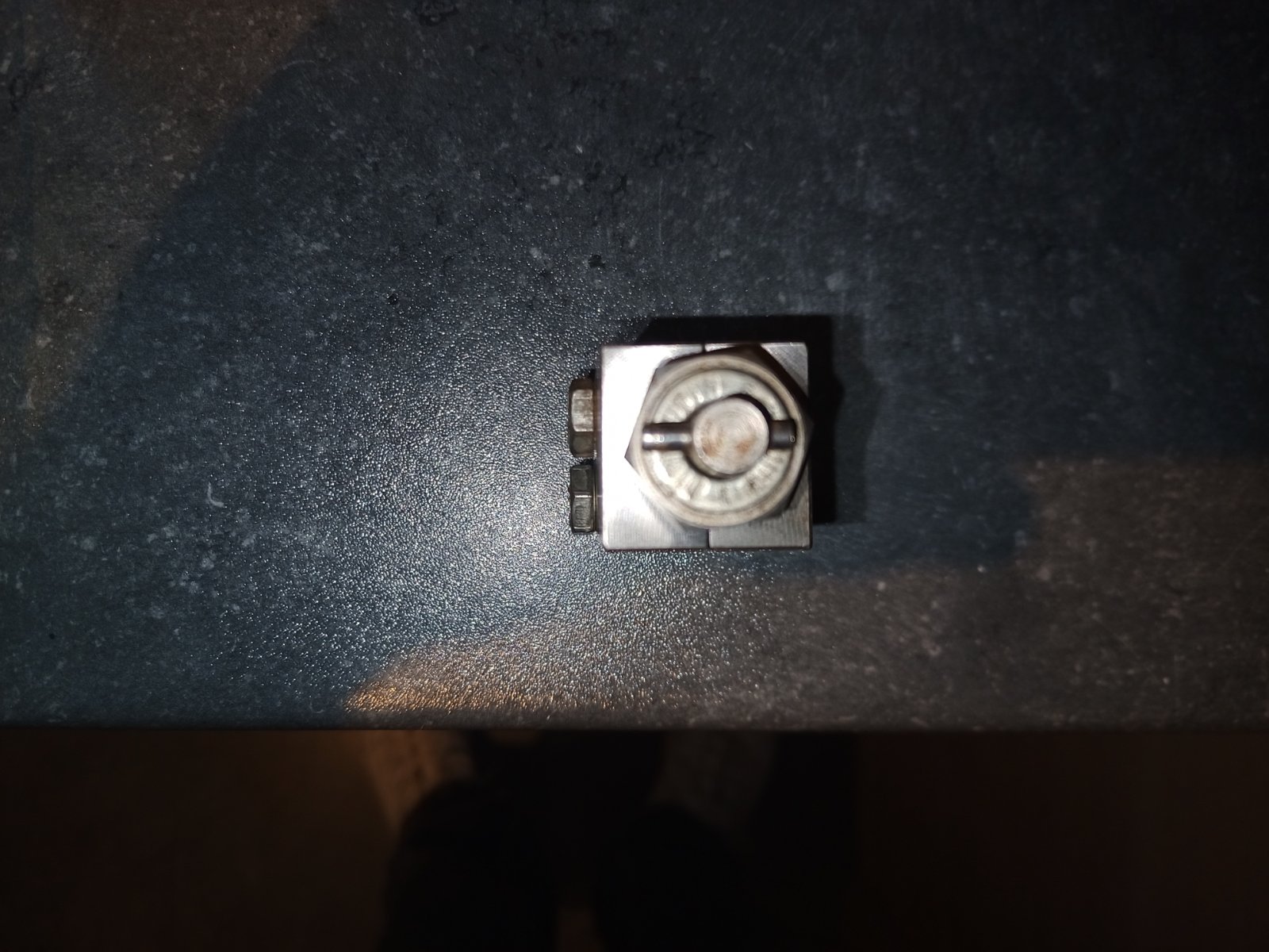

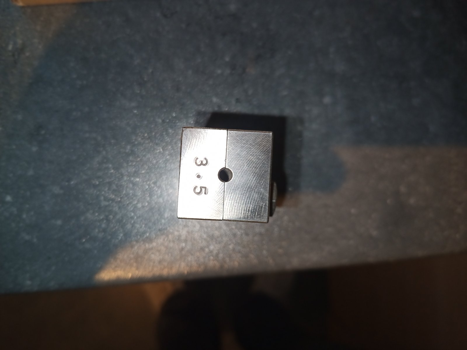

Afternoon all, Roger, Jim probably knows more about hydro-pneumatic Citroens than I do, so feel free to take Jim up on his very kind offer of advice. Roger already knows this, but the tool has had a mini clean-up:
and is now winging it's way to him, so currently unavailable.

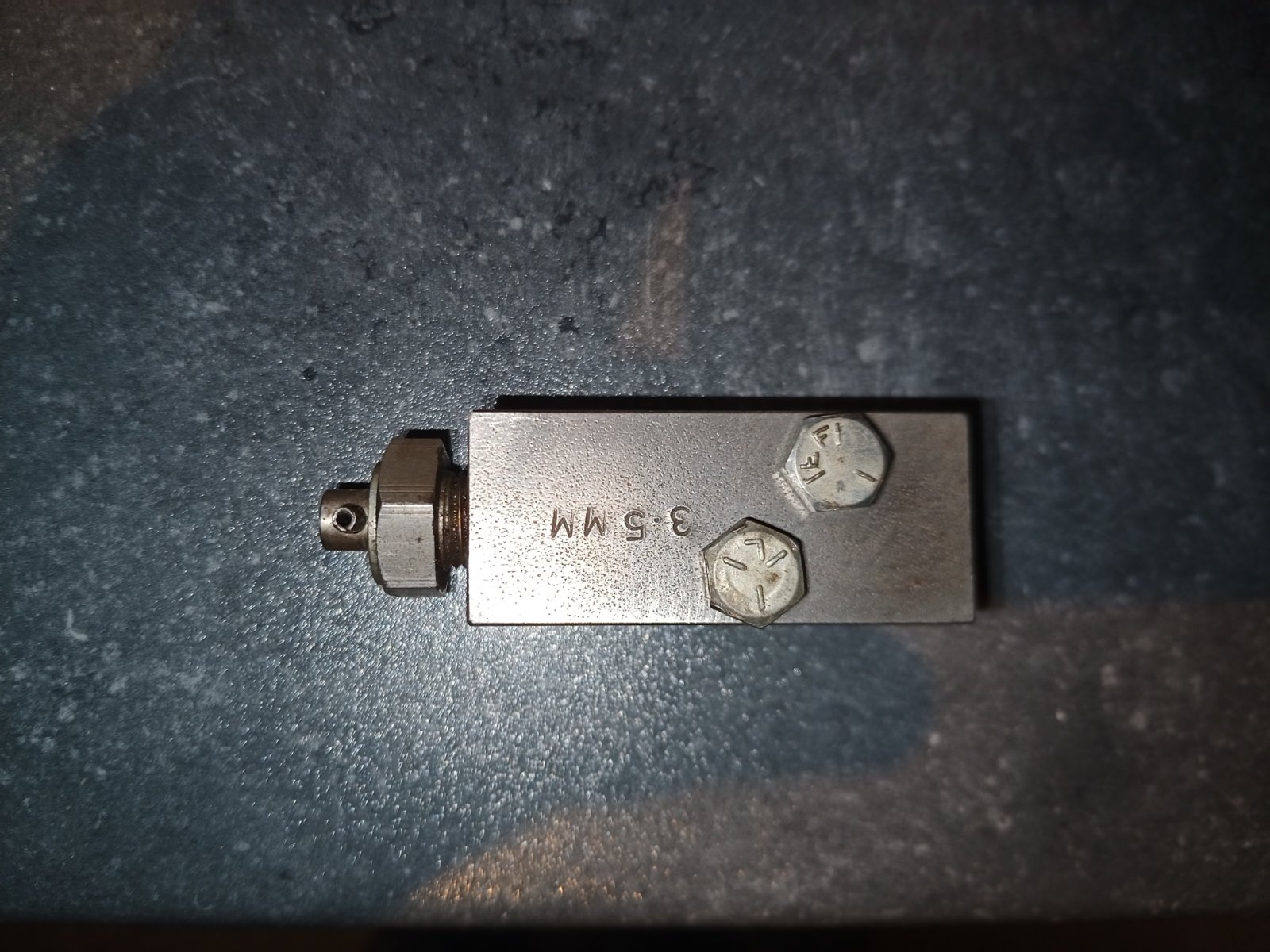

Apologies for my ignorance on imperial stuff - grade 5 is that a high tensile grade?
If I come across any UNC stuff I'll bear it in mind (my Grandad's garage is a treasure trove of all sorts, so potential source there perhaps.)
Jay-Bruce
- Posts: 544
- Joined: 20 Mar 2019, 00:30
- x 280
Re: Equipment loan pool
Yankee grade 5 is about metric 8.8, so they are reasonably robust.
- Posts: 5325
- Joined: 25 Apr 2022, 09:03
- x 2347
Ah, ok. Not high tensile (10.2) but not mash potato (5.6)Jay-Bruce wrote: 29 Mar 2023, 18:13 Yankee grade 5 is about metric 8.8, so they are reasonably robust.
Can't make any promises but if I do lay my hands on some I'll shout up. I do have some UNC taps and dies so should be able to confirm what I stumble upon in there easily enough. Or for that matter easily make some replacements with the die.
Jay-Bruce
- Posts: 544
- x 280
And not cheese like the 4.4 bolts B&Q sell. Don't worry about procuring replacement bolts, they can be gotten off of eBay, or from local suppliers up here, the main thing is that if anyone using this tool loses the bolts, they're snookered as it's 99% they won't have a suitable bolt in their garage/shed/workshop/toolbox. I also made it clear that they are UNC so that if anyone does borrow the tool and needs to replace the bolts, they don't try and force a m6 in there and mash the threads.

Oh Jim most definitely will. I was referring to care of your tool which is of utmost importance.Jay-Bruce wrote: 29 Mar 2023, 17:14 Afternoon all, Roger, Jim probably knows more about hydro-pneumatic Citroens than I do, so feel free to take Jim up on his very kind offer of advice. Roger already knows this, but the tool has had a mini clean-up:
Thanks for sorting this today and your time.

Seeing this tool in detail got my imagination wandering, as to the potential to create one of these.
Someone has done similar:
http://www.schaalbouw.nl/citroen/flaring.htm
But that lacks the refinement of the threaded tubular bolt which creates the pressure to form the flare on Jay's tool.
If I were to make one like Jay's, I think a couple more holes drilled and a couple of smooth unthreaded pins between the two halves would be a good upgrade, that way the two half threads would more easily be aligned.
It did tickle me a little that Jay's tool is made up of all imperial dimensions, of a piece of inch bar etc, to then be used on a completely metric Citroen!
I suppose if you were to have those UNC threads mangled, drilling out and tapping at M7 would be a nice Citroen appropriate way forward!

The imperial measurements are because the die standards are English (typically 1” x 1.75” - approx 25.4 x 44.5). I think this is because England used to be the world leader in tooling and therefore we set the standards.

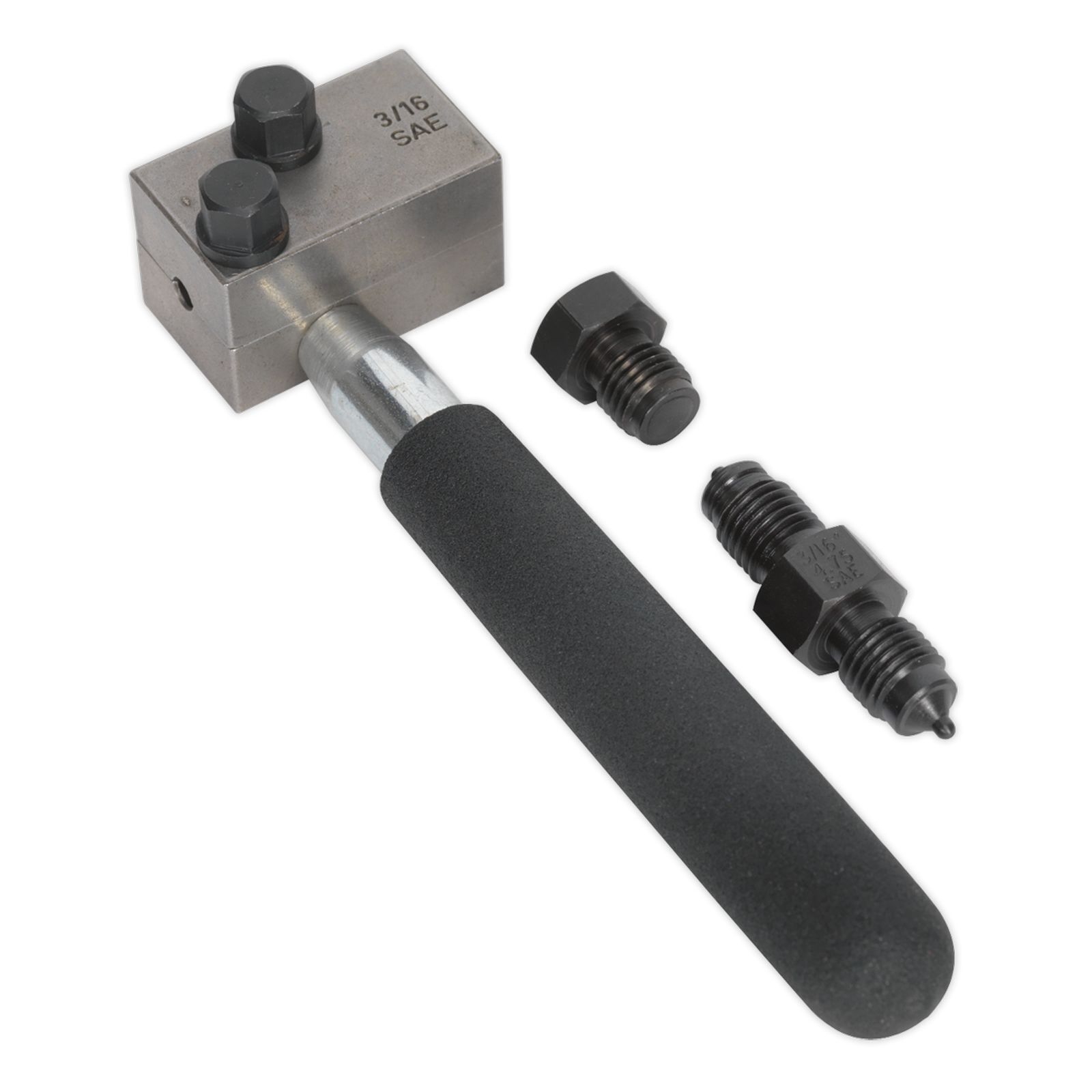

Hi Matt, just a FYI, M7 is an obscure, almost propriatery thread, the logical "upgrade" would be M8. I didn't make the tool, I bought it, and a small fortune of other bits from Pleiades ~20 years ago, and I believe Martin still sells them. I personally think that as long as Martin @ Pleaides is selling these tools, there's no point "reinventing the wheel" The only other thing I'd be tempted to do to the tool would be to drill and tap a hole into the back of one of the die blocks, to enable me to screw a handle on there for on vehicle work, making it something more akin to this sort of thing:

Sorry Jay, I should have stuck anotherJay-Bruce wrote: 29 Mar 2023, 23:34 Hi Matt, just a FYI, M7 is an obscure, almost propriatery thread, the logical "upgrade" would be M8. I didn't make the tool, I bought it, and a small fortune of other bits from Pleiades ~20 years ago, and I believe Martin still sells them. I personally think that as long as Martin @ Pleaides is selling these tools, there's no point "reinventing the wheel" The only other thing I'd be tempted to do to the tool would be to drill and tap a hole into the back of one of the die blocks, to enable me to screw a handle on there for on vehicle work, making it something more akin to this sort of thing:
Was meant tongue in cheek that the Citroen specific tool should be fitted with "Citroen specific" M7
A handle in the side does look a good upgrade.
