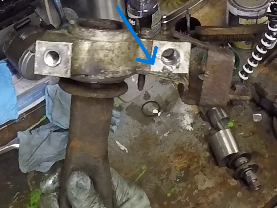

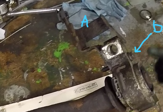

Hi Kenny, I mean the outer bushes at the hub. The arm end bolts either side of it and it twists. It's actually fitted in the hub carrier and not the arm end. On the Xantia it was only a lower balljoint but the inner bush on a Xantia was similar to this and prone to the same failure. The confusion is that I discovered my outer lower bush was failing again during the job to replace the inner rubber bushes of the arm - one of these is much like the Xantia P bush . Annoyingly these seemed in good condition so it was a lot of work to carry out to still have a floppy bush at the outer end... You can feel it a bit as it drives at times.
As for your suspension heights, I found that the LH P bush actually also serves as the mounting for the steel bracket that holds the front height sensor. It made it very difficult to remove the LH arm because I couldn't remove the sensor bracket first due to the M6 screw that holds it being completely seized solid. I got the lot out eventually but it was difficult. When I came to replace the P bush of the LH arm on the workbench removing the bracket to refit it on to the new P bush revealed several millimeters of corrosion product had built up between the alloy casting of the P bush and the metal bracket. Over years it had pushed the bracket out and distorted it's shape and it had moved the height sensor's position with it. When I reassembled it with all new P bush and front bush and the repaired and cleaned up height sensor bracket, the car would not raise at the front. I checked thoroughly that the dogbone link was attached correctly and it was. It would raise 'a bit' if you selected the higher positions but not enough to even suggest getting it off the axle stands. I then realised the cause was that metal mounting bracket being bent back had effectively changed the normal position for the front height. I got it off the stands with a trolley jack but on ramps at the front the normal ride height was now pretty much as low as it goes. I had to readjust the front height by carefully moving the anti roll bar collar that connects to the dog bone link. I assume the car had been creeping up higher over the years due to the corrosion build up and a garage had adjusted the front height down to compensate. My repair of the shape of the bracket had effectively moved it back the other way - too low. I think I took a photo of it.
A is the height sensor bracket, b. is the seized screw. Had to snap it in the end - it was corroded not where it screws into the metal bracket but inside the alloy casting where it travels through a clearance hole. This hole was full of the corrosion product again.
You can see how much corrosion 'product' built up and pushed the bracket out of shape.
Looking at that second picture the bracket should be straight in line with the P bush casting but it's gone all 'trapeze' ..

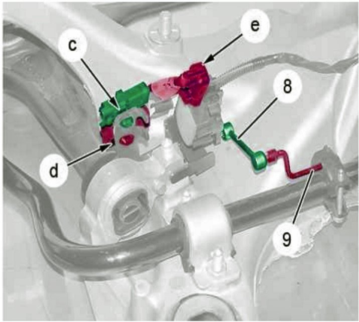

Here's a pic I have of the assembly from Citroen so you can see what/ where I'm talking about:
Here you can see how straight the bracket is meant to be. Mine had been compensated by being adjusted at item 9. the anti roll bar clamp.

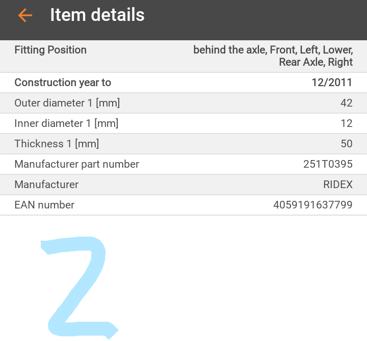

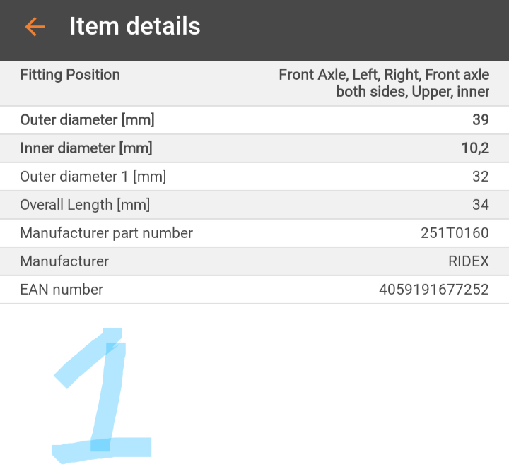

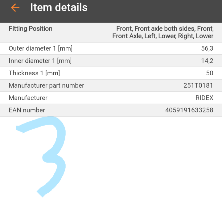

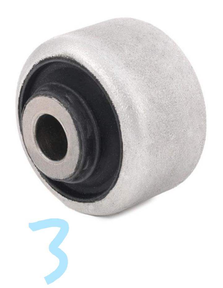

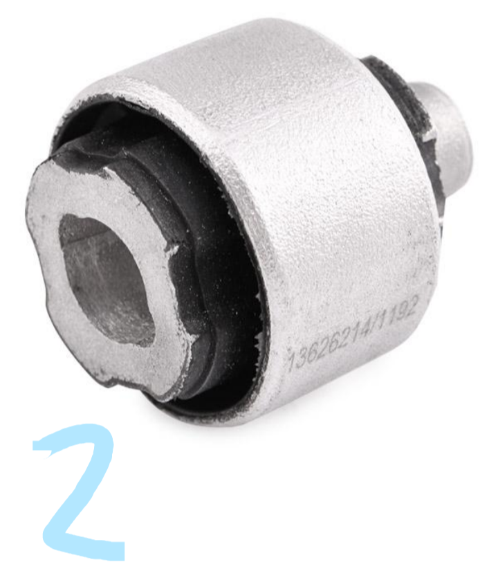

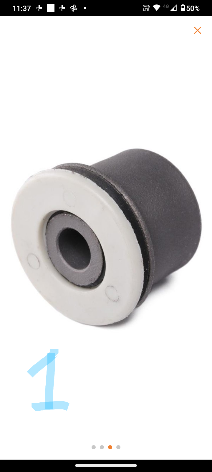

Are these a good candidate for polybushes? I can't help but think that this application doesn't benefit from a rubber bush's twist resisting abilities in this location, as such the rubber is resisting the forces pulling and pushing the hub into and out of the wheel arch (cornering forces)
As such a polybush freely able to spin on the central tube wouldn't be a big negative. Indeed the ability to spin meaning polybush wouldn't actually need to be tighten up only once weight on the wheels again.
Can anyone confirm the inner and outer, width dimensions of these bushes?
I can have a look what is in Poweflex universal range at dinner time.
There's a few contenders listed on Autodoc as "wishbone bushes"
1
1
1 details
1 details
Or
2
2
2 details
2 details
Or
3
3
3 details
3 details
Thanks,
Matt

Better replacement Vs Poweflex = no problem, I've done some digging anyway, so will list my findings just for future reference
Posts: 5308
Joined: 25 Apr 2022, 09:03
x 2341
Re: year old bushings already need replaced
Unread post by MattBLancs »
For future reference:
1
1
Nearest match is top hat bush PF99-106
Body outside diameter 32mm, body length 32
Sleeve inside diameter 8mm, OD 16mm = needs drilling out to 10.2mm.
Lip length 7mm (not enough data to know if this an issue)
2
2
Top hat bush PF99-112
Body OD 43.2mm would need to be turned down to 42mm
Length 24.5mm
Lip OD 50.74 and lip length 7.5mm again not enough info to be certain
3
3
None big enough top hat or parallel bushes. Of the "washers" type, PF99-205 is 50mm OD, next up PF99-206 is 75mm (only seems appropriate at this point on the French Car Forum to sagely state "a big difference between a 205 and a 206" !!) So nothing there.
Overall, no easy option whichever of those bushes is correct one!
Source:
https://www.powerflex.co.uk/products/Wa ... 788/1.html
