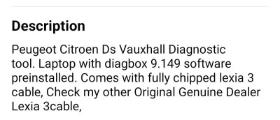

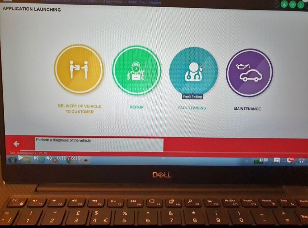

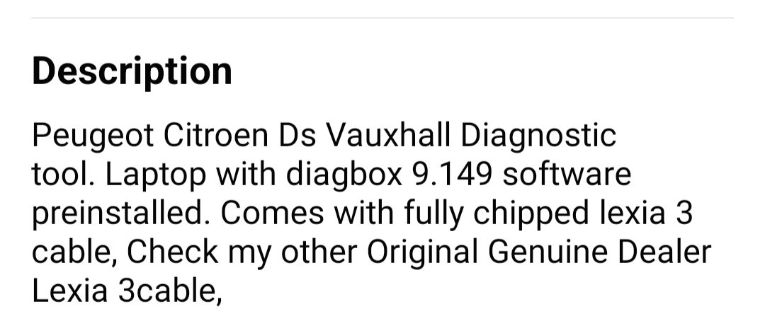

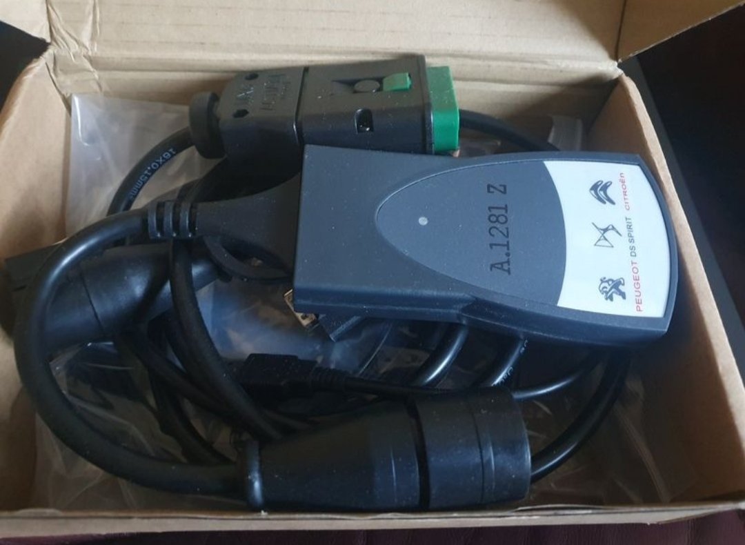

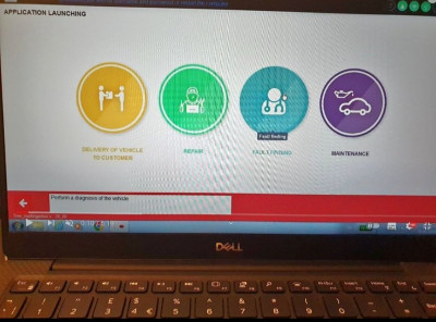

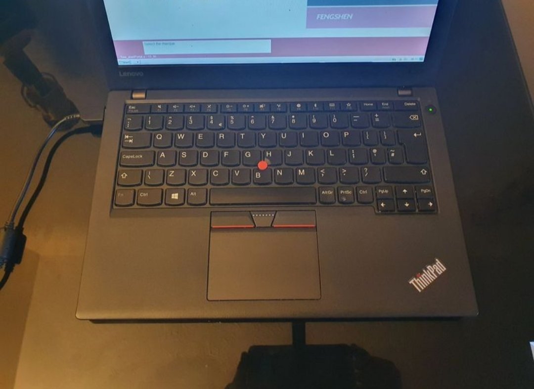

Here's the description and some photos of the lexia for sale with a laptop. I did try easy diagnostics but appears they're out of of stock. Where is recommended fmto source a reliable set up. I believe I need a full chip? What shall I look out for?
