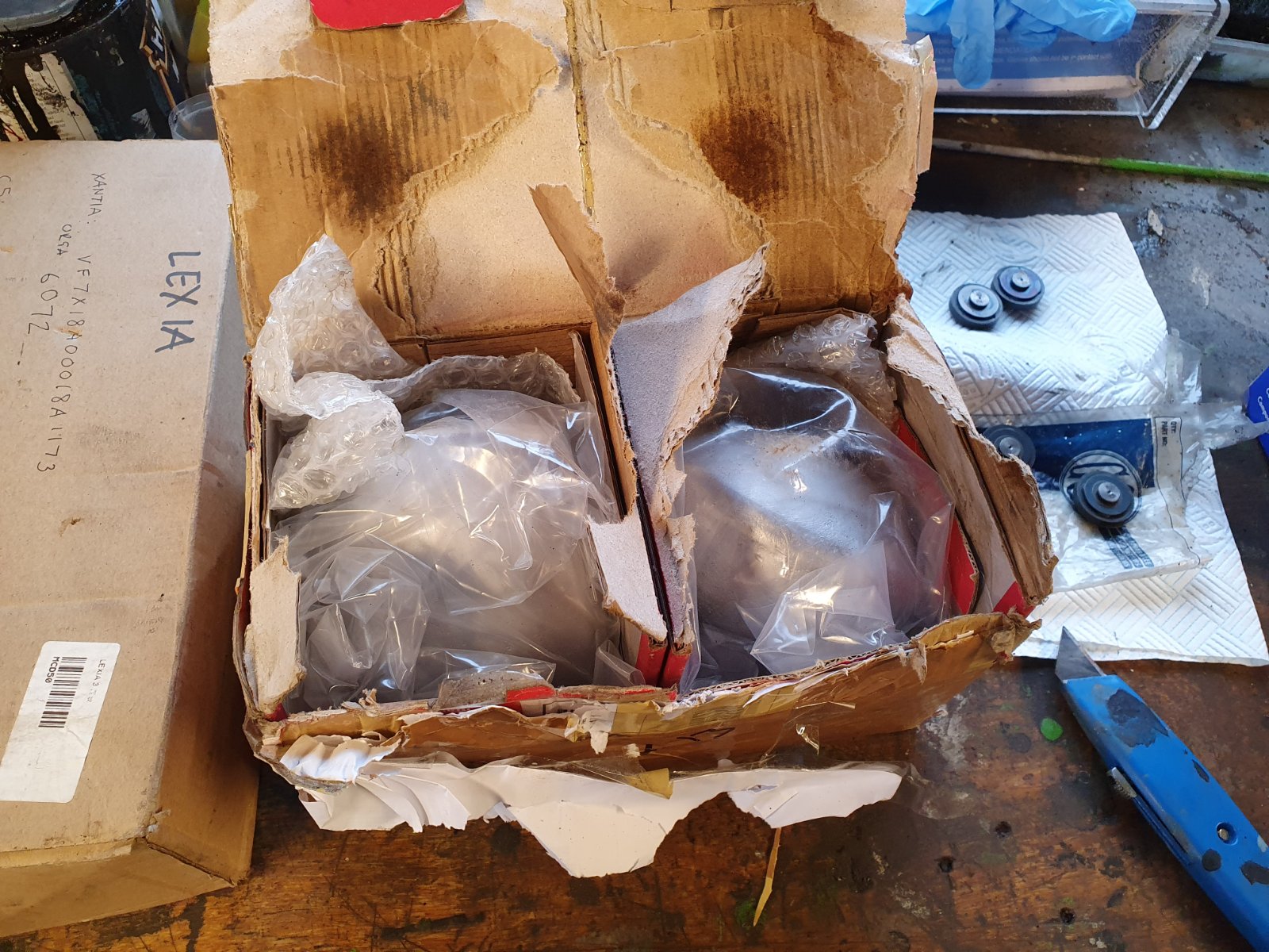

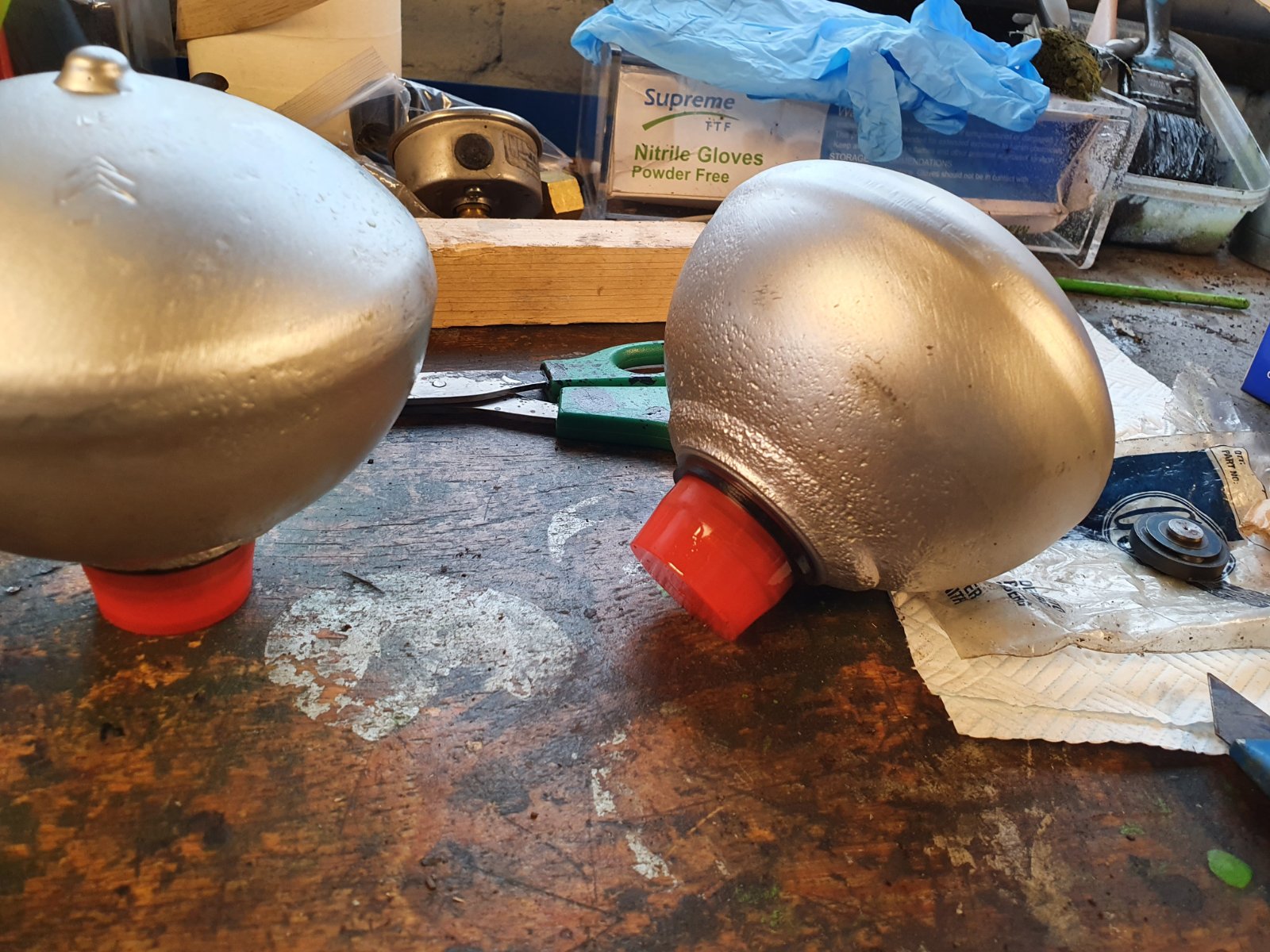

Update: C5 X7 rear struts L&R removal - new spheres
I now have the regassed spheres back from Plieades and fitted - been looking forward to fitting the final pair of renewed spheres. That's all 7 spheres done now and I hope they last out.
The temporary green LHM spheres came off very easily And to do the best job, fully depressurised and LDS topped up. It took just over half a litre Hopefully all bled and I noticed the BHI pump was pretty quiet this time after I'd noticed on occasion it was louder when making any raising to the rear.... possibly caused by air trapped. I think it's purged of air now.
The ride back home with 7 spheres renewed was pretty serene. A real difference at the rear and showed how firm the temporary spheres had been over the last week. Quite chuffed with how it rides now. Next.... front control arm inner bushes.....

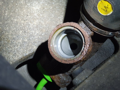

I'd wait until the spring Kenny. You need to be able to deal with possible problems concerning those or strut spheres- really can't see how they'd come off without removing the struts and then that means disconnecting the pipes all before the epic effort to get the spheres of the struts. Then you can get problems with the strut mating face corroding so these things can see the car of the road for weeks. I'd already chosen to replace the pipes so I was ready to cut them off if I needed to..
The 2 middle spheres however are reachable if you have enough space underneath for a BIG breaker bar. Front middle sphere is impossible though - full regulator has to come out after lowering the sub frame.. at least you've done that before!
If you're really keen on getting the middle spheres off I could come over with a selection of persuaders... success is far from certain though. It has taken me 11 months now I think of it to get to this stage...

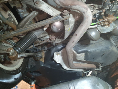

I actually found the X7 easier to change the spheres on than the BX; on the BX for the rears you had to crack them with the system fully pressurised as there was nothing locating the cylinder and stopping it rotating, but the X7's cylinder design keeps the sphere's socket fixed. In fairness, I was doing this on a two-poster, so had a fair bit of height and room to get cheater bars on it whereas on the BX I was doing that on axle stands.
The front "middle" sphere wasn't too bad to do when I eventually found it, as it's not in the flipping middle
By virtue of being tucked in behind arch liners and kept cosy by the engine, it wasn't anywhere near as rusty as the back spheres. The backs did take gorilla force to get them undone, but as I've said, because they didn't have the added complication of locating the cylinder, weren't as bad as my memories of BX back spheres were...
When I start that little triflingly insignificant job on her X7, I'm going to have a pair of serviceable cylinders going spare, you can have a loan of them as a standby-option, if you cannot get the sphere off, stick on my cylinders, send me your original cylinders, and I'll gorilla them off in a vice with my 4ft chain tong, and you can swap back.
