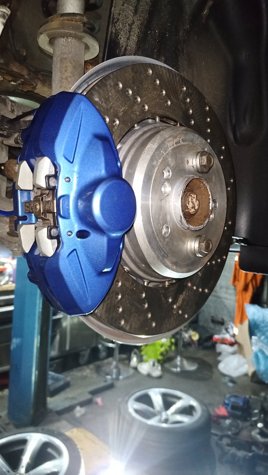

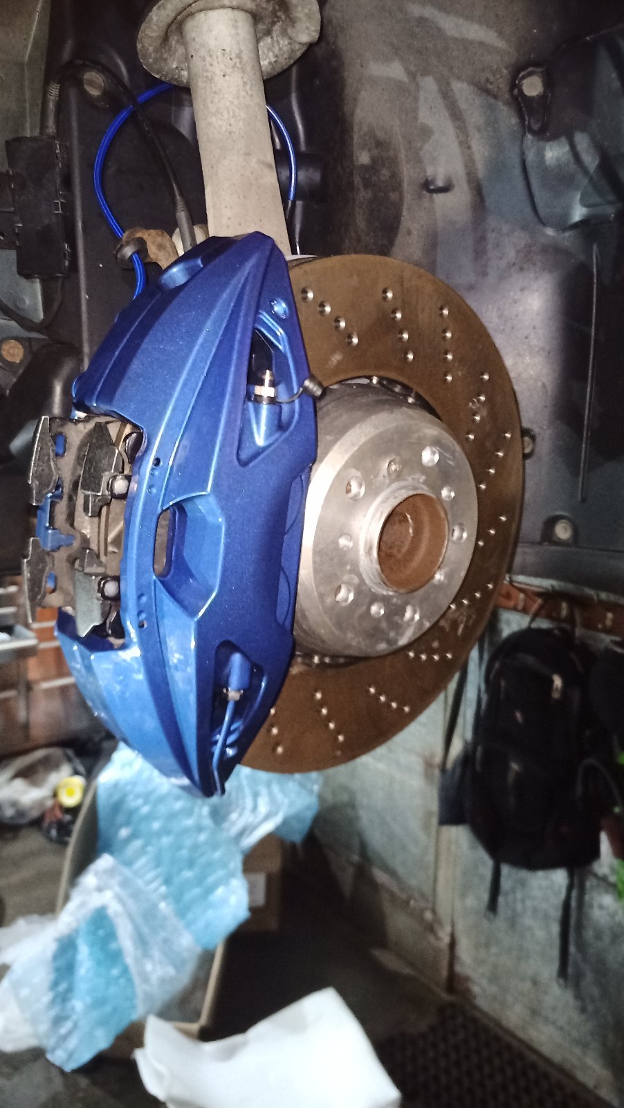

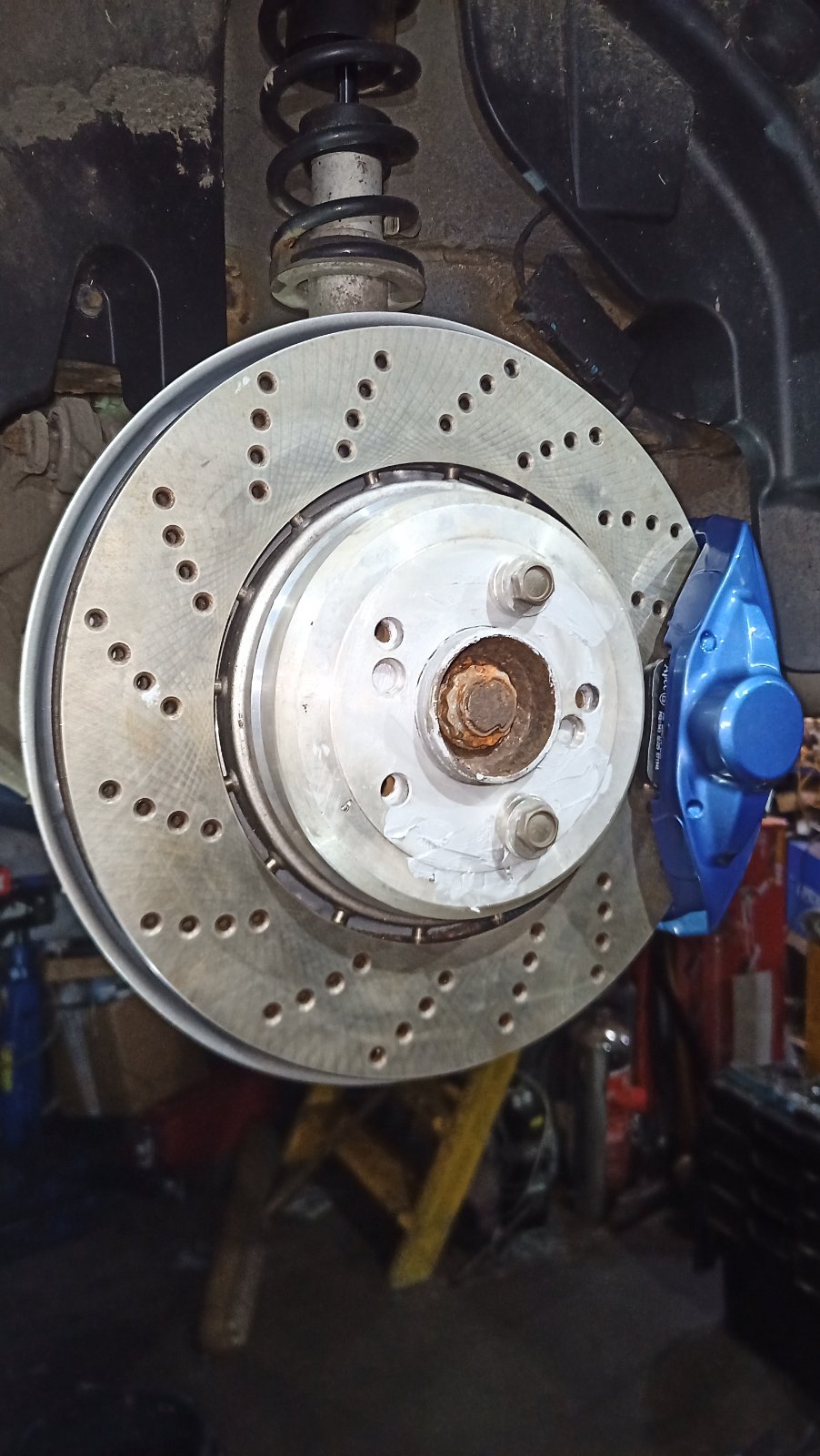

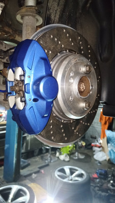

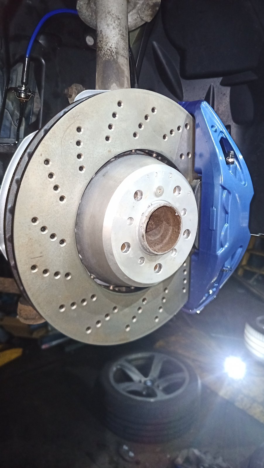

The best I can work with is web resources covering the galvanic series, and anecdotal experience based observations; an example of which would be I've recently upgraded the brakes on my BMW with brmbo calipers, bigger disks, matching backplates, braided lines:
And in the process of fitting the rears, I had to remove the old (braided) brake hoses I had to disturb the rear brake pipes, fortunately, I had replaced the rear hardlines with Stainless Steel ends on Cunifer pipe, so they undone easily, no binding of nut on pipe or deterioration of the tube nuts. That's uncommon to see given they have spent their time running about a coastal town in the North East of Scotland. (Insane amounts of salt exposure)

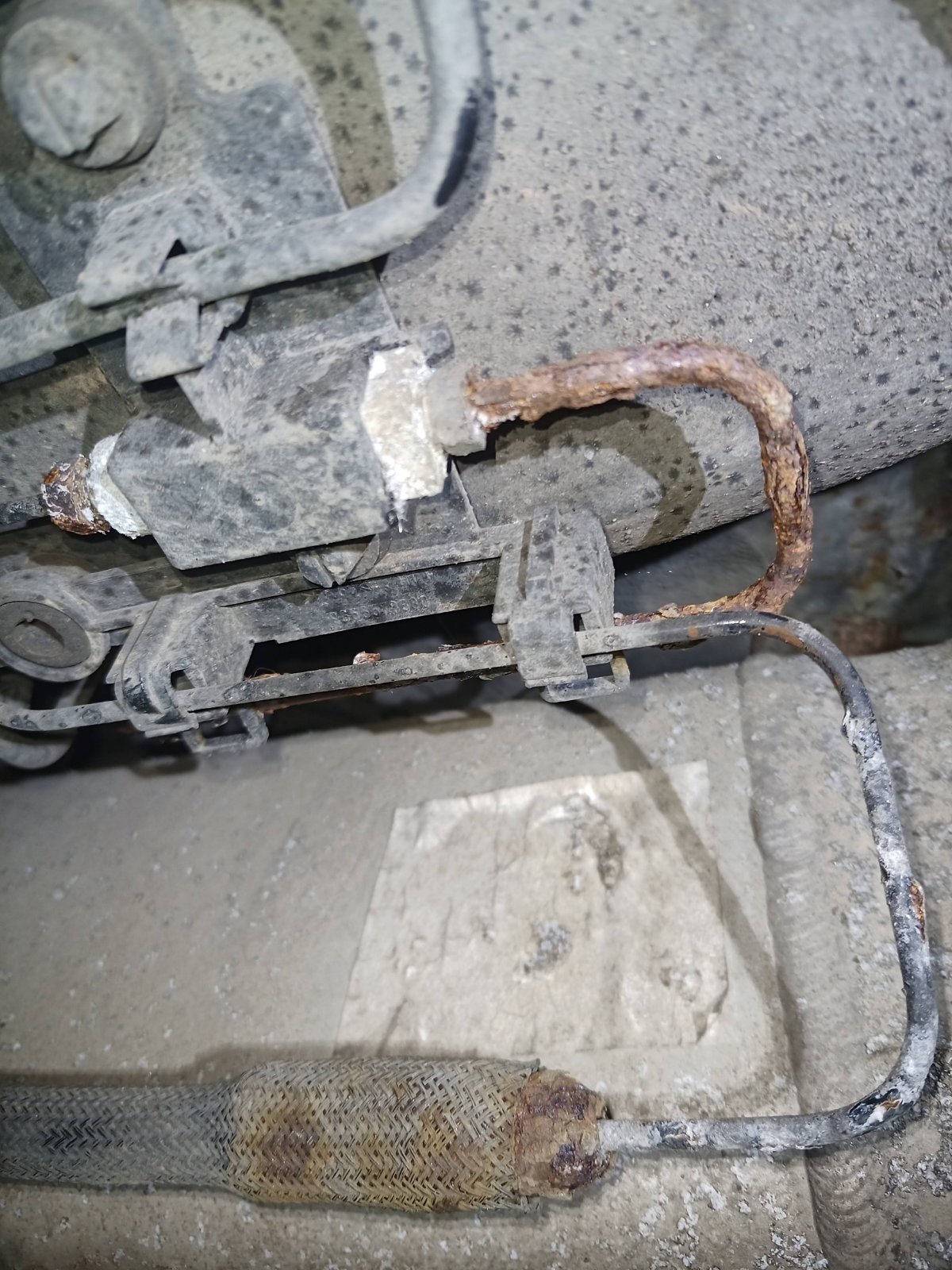

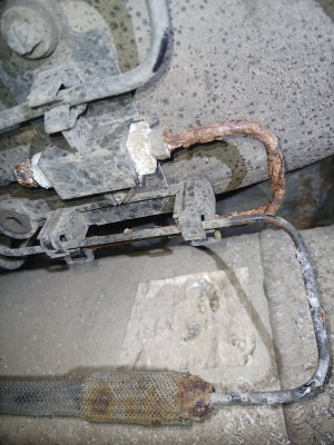

That arrangement on my brake pipes had Cuni pip into stainless ends, into stainless hose, into ally calipers, so I'm quite happy with Cuni and stainless as the materials of choice for my LDS pipe ends. The only cavaets being the aluminium BHI valve body, and the troublesome aluminium union on the fore to aft BHI to rear firmness regulator:
However, I'm doing away with the troublesome aluminium galvanic generator union, replacing it with a stainless F/F Joiner, so I'm sidestepping the galvanic corrosion issue there, and the BHI is tucked up on top of the offside inner wing (under the LDS tank), so there's no road spray salty water getting to it to act as an electrolyte. I think we should be golden with those materials in those locations, in light of their environment, whats your thoughts?
