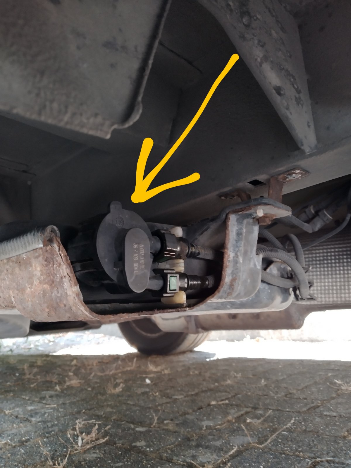

Sooooooo what's that part? I only ask as outlet had a big puff of smoke when I disconnected it before I refilled the system.

What part?Rp0thejester wrote: 17 Jul 2022, 19:26 Sooooooo what's that part? I only ask as outlet had a big puff of smoke when I disconnected it before I refilled the system.

Think he means the connectors to the dpf fluid tank

If he means the circled part in his previous post, then that is the additive pump attached to the additive tank.

Pump? I have major issues then as there was nothing else connected to it

From memory two pipes one goes up to the top of the tank the other goes further up , was over a year ago now, Marc may well have a diagram of this system id like to see it for myself as its a clever design. Marc where are you

Yeah theres 2 pipes but that's it, no electrical connection or anything to say it's a pump of some sort.

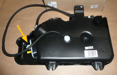

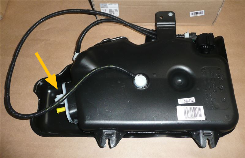

- x 6945
Re: C8 DPF Additive
Stop panicking!
The electrical connection is at the opposite end.
Here, where I've marked in yellow arrow

Its in such position you can't see if you look for it, my unit has a plate over it so all you really see is the pipe/filling end. Hes a bit like me blind panic till the fog clears, or regen clears lol.
