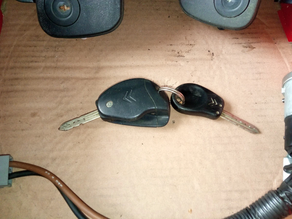

@citoyen x
If you would like to PM me the details you have for the key I will go into town tomorrow and see what the price and availability for a new key would be.
In the meantime a photo of what a correct key looks like would be good. Both standard key and remote locking types please.

citoyen x
- Posts: 13
- Joined: 31 Jul 2023, 18:39
- x 2
Re: Only key lost! Can this be replaced DIY using Diagbox?
Thank you both so much.
I've found a set on eBay which look right. Hopefully this link will work: https://i.ebayimg.com/images/g/lOMAAOSw ... l1200.webp
Paul, I have PMed you.
