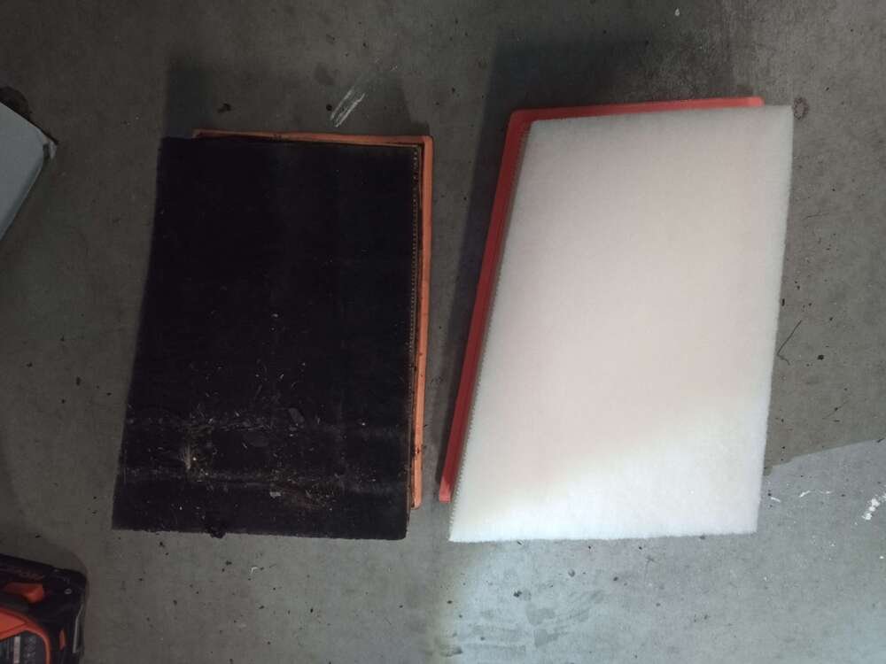

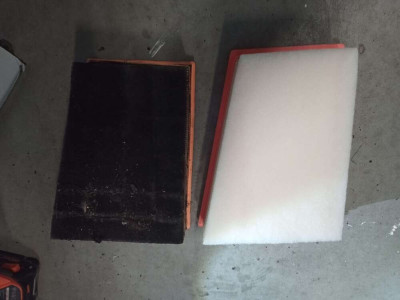

Kangoo- I've been getting around to doing the pollen filters for quite sometime as it mean taking the part of the dash to bits-
looking at the air filter I expect to to be quite bad ?

Was the previous owner an open cast coalmine?
You should get a few bhp extra after changing that.
Back in my younger days I had a K&N filter, basically a cotton sheet impregnated with sticky oil. They supposedly allow more air to flow as they rely on stickiness rather than obstruction as a paper filter does. There are lots of debates about whether they're an improvement, but I thought so and they definitely sound lovely, as more airflow noise gets back out of the air inlet. Kind of a sucking/whooshing noise. Also some debate about whether they may ruin airflow sensors due to the oil residue, entirely possible but I never had issues. But I'd suggest treating them as disposable, washing them makes a right mess, leaving basically red-dyed animal fat and mineral oil all over the place. Definitely not good for the drains or soil (or the bath in my case!). Plus the cleaner and oil spray costs only a bit less than a new one anyway.
