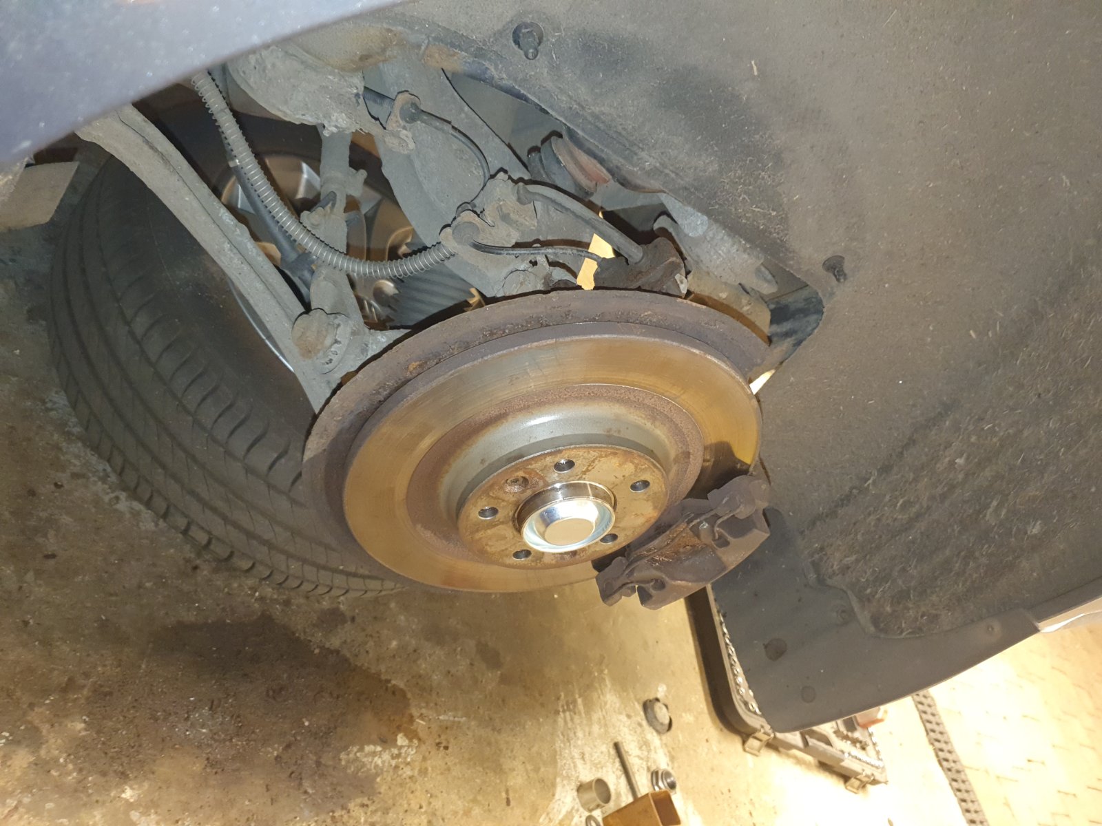

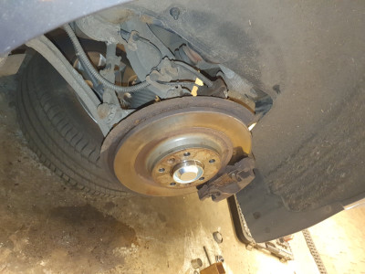

So I discovered that the Lexia works to release the brake and keep it off. I hadn't read Richard's post though! When the brake is in the released position the cable end is surprisingly easy to remove from the caliper lever end.
Wheel bearing is changed and not too hard. You need a 40mm socket that I had to order. A 3 - leg puller that's quite long - I had to borrow one because my puller was too short.
Fairly straightforward job and everything came off without trauma.

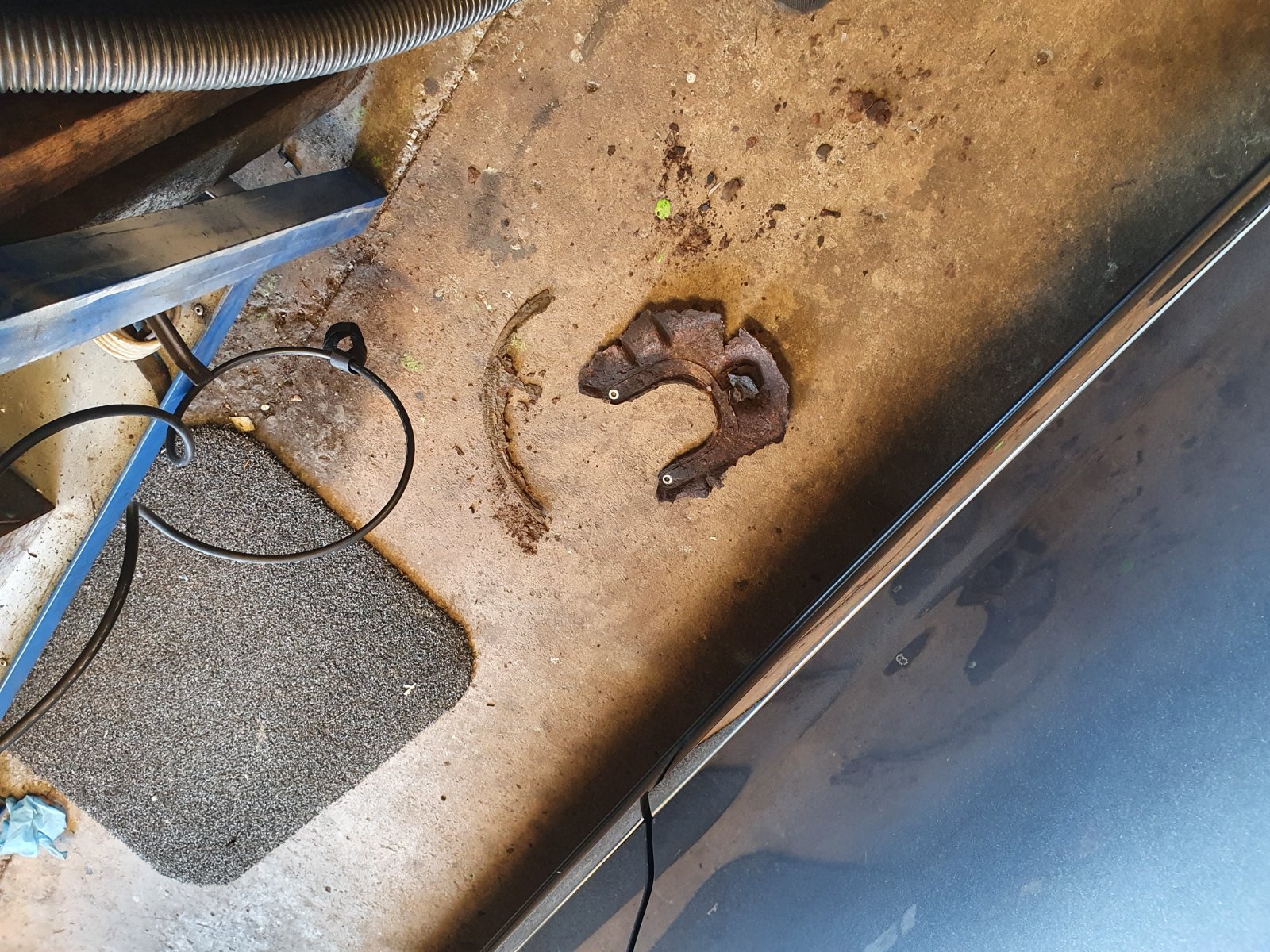

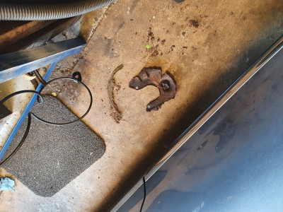

But my god, the inner brake shield was so rusty I just removed it. Dropping it caused it to shatter like a meringue..
So I have a nice smooth rear right hand wheel bearing now. After traveling up to the Isle of Skye last week and a bit of driving around Skye, the sound of the duff wheel bearing was annoying. It was coming from the rear right, and stopping up and touching each hub showed the right rear was warmer then the left.
A test drive yesterday revealed NO CHANGE in the noise
I have changed the wrong side!! It is the left rear that's noisy. Really annoying. It still sounds like the right hand side but it must be some auditory quirk. I had noticed the old bearing when removed was low on grease and the inner race detached from the assembly upon removal but the bearing race only had a tiny amount of pitting and not enough I'd have thought to make the noise at around 40mph. Anyway, I've ordered another rear wheel bearing for the left so that's another Saturday written off..
To be fair though the RH rear bearing was beginning to go anyway so would have to replace in due course anyway.. That's my positive spin! no pun intended

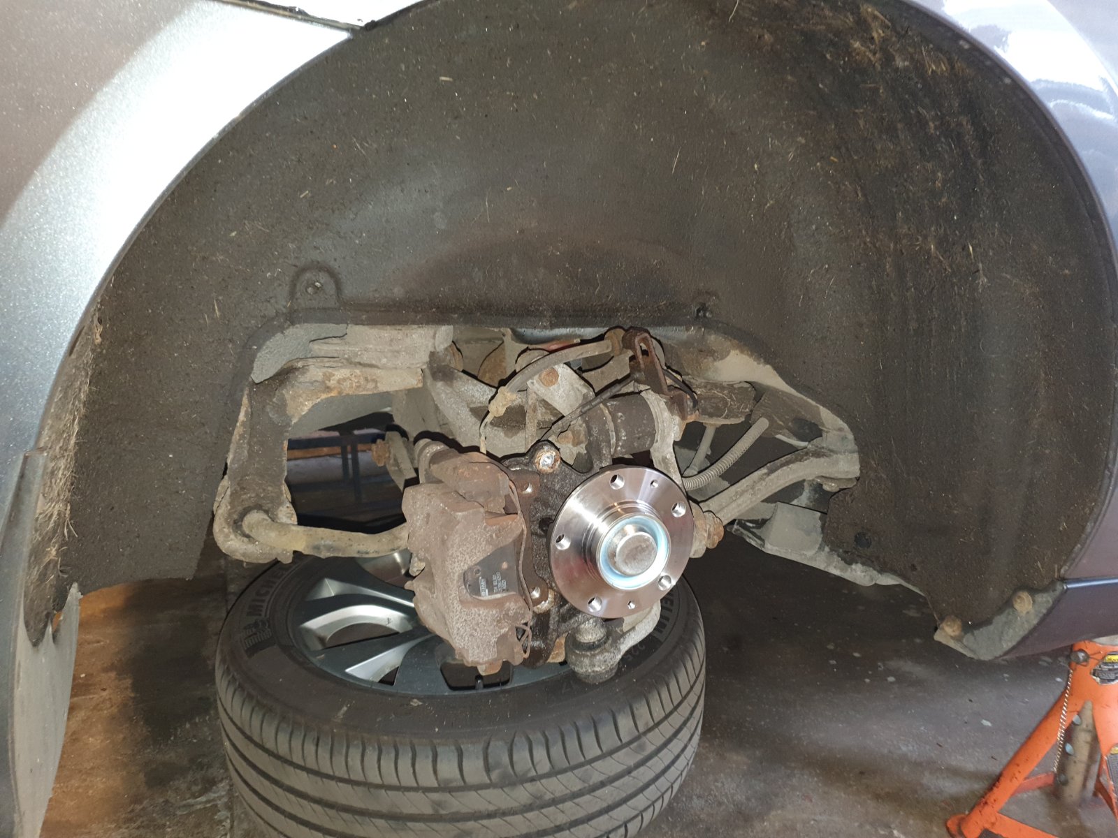

Finally changed the other rear wheel bearing! Just as straightforward as the other side and thanks to Richard W I was able to simply release the parking brake....
After the disaster of the RH side I was a bit dismayed to view the old wheel bearing didn't look that bad.... but after changing the result is very smooth and quiet running. The bad bearing was like a regular heavy throbbing above 40mph.
All good and vice the brake and all rear links a good inspection. The many links of the C5, C6 and Peugeots rear axle look to have a lot of potential to have worn out bushings. Apparently all OK on mine so far and if anything I'd say the trailing link lower end is the most likely to wear (was the only one with a bit of movement) when I checked. Anyone have experience of this? Is it the most likely to need replaced in time?
Everything else looking in good order at the rear axle.
