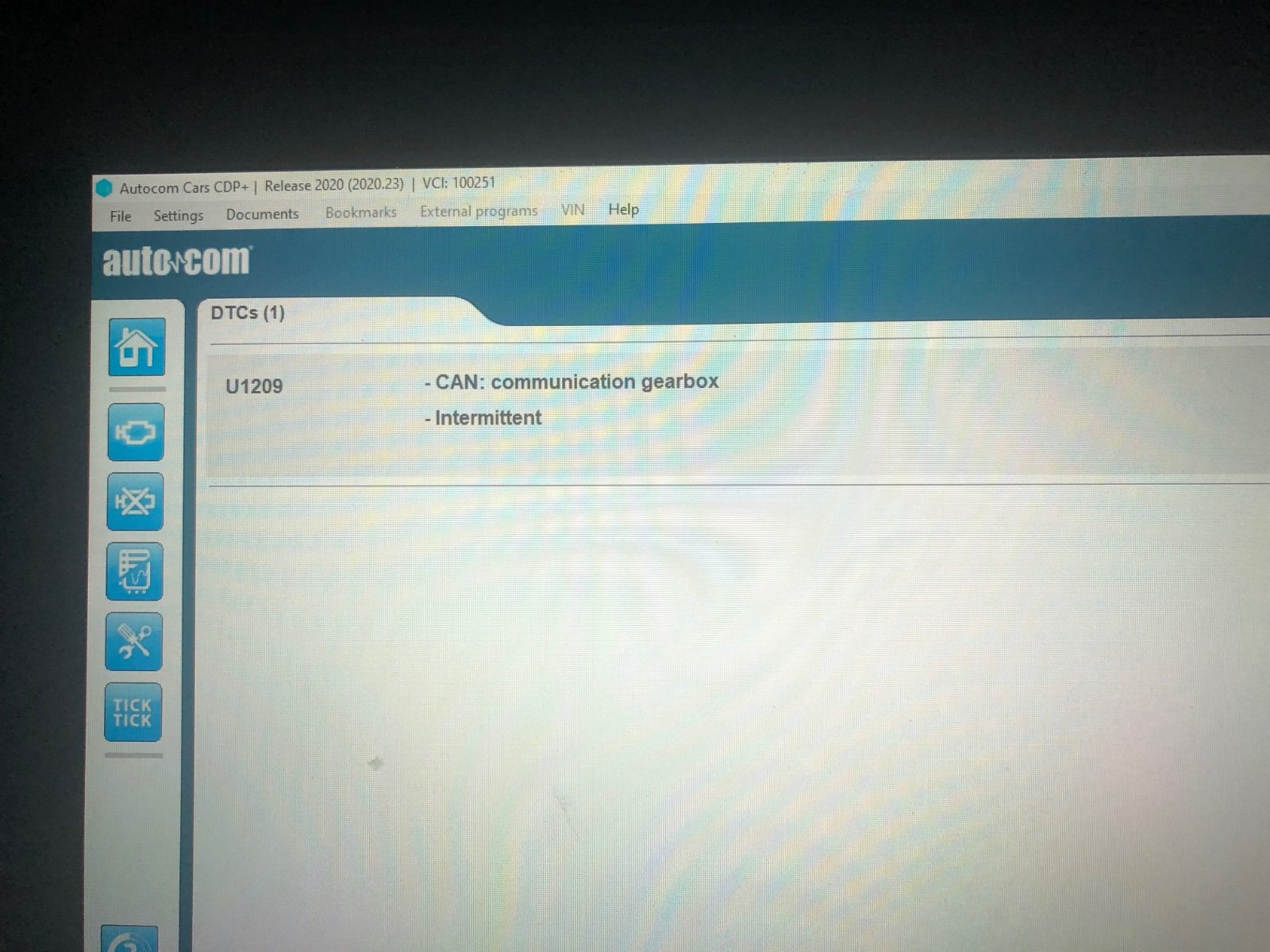

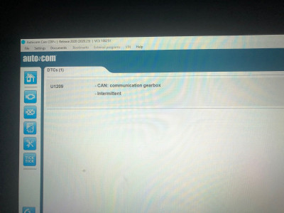

Dragon4331
- Posts: 7
- Joined: 21 Dec 2022, 20:43
Re: ECU Gearbox Fault code U1209 (DS3 Citroen) Auto & Limp mode
Hi mate any luck with the problem you was having as i have a ds3 1.6 automatic i run a diagnostic on it got fault code U1209 communication gearbox intermittent no lights on dashboard or anything just when i drive it goes in the 1st gear the holds back in 2nd then goes in 3rd any advice for me please

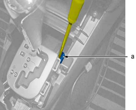

Could you help with another problem please.
I've got to the stage where no one could fix the issues so the car has been sold as spares and repairs, Its being collected tomorrow but now I have another problem, It won't start, no power, looks like a short somewhere because the dash lights come on when I turn the ignition key but the then dies before the engine even tries to turn. Is there anyway to get the car out of PARK mode with no power?
Regards
Regards
- x 6945
It's probably the Shift-Lock preventing this and with no power it will need manually unlocking.
Unlock the "shift lock" by pressing at "a" with a screwdriver. You'll first need to remove the surrounding centre console trim.
Move the selector lever to disengage it from the "P" position.
