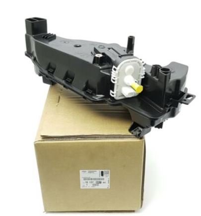

Re: C4 Cactus 2014 EOLYS tank replacement
I've never been near a cactus but that tank look pretty similar to other models like the Berlingo etc. The picture of that tank above is upside down so you can't see the filler but yes its on the top of the tank. If its that type of tank then you remove it to fill it, they are really easy to remove. Remove the heat shield first then there are only 3 bolts holding it & it kind of hooked onto some clips on the underside of the fuel tank.martin_b wrote: 03 Mar 2022, 12:40 Hmm... but the filler is on top of the tank, not exposed unless you take the tank down. Right?
Thanks for that info. That confirms the picture I got when I was under the car the other day. Will remove it tomorrow and give it a little shake to determine whether it's empty or not.wheeler wrote: 03 Mar 2022, 18:25I've never been near a cactus but that tank look pretty similar to other models like the Berlingo etc. The picture of that tank above is upside down so you can't see the filler but yes its on the top of the tank. If its that type of tank then you remove it to fill it, they are really easy to remove. Remove the heat shield first then there are only 3 bolts holding it & it kind of hooked onto some clips on the underside of the fuel tank.martin_b wrote: 03 Mar 2022, 12:40 Hmm... but the filler is on top of the tank, not exposed unless you take the tank down. Right?
