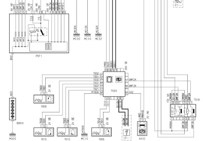

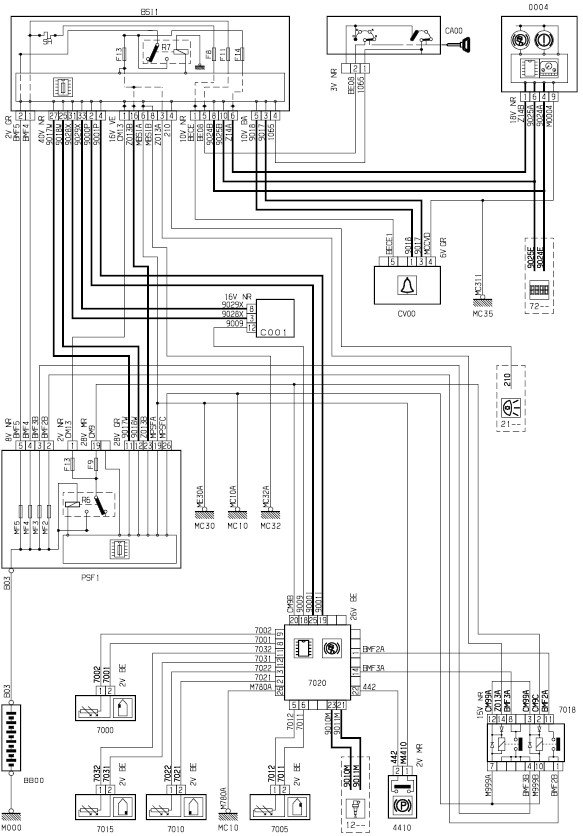

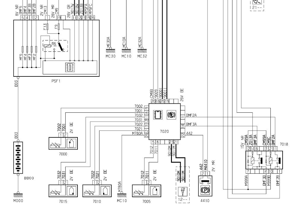

OK i have attached including an enlarged section of the ABS ECU for better clarity.
As i suspected the ABS system is in 'series' on the CAN network so unplugging it will break the CAN lines.
How i would now proceed is to resistance check the CAN lines at the ABS ECU first.
Make sure that there is nothing plugged into the OBD socket and that all ECU's are plugged back in as the should be apart from the ABS ECU.
Measure the resistance across pins 19 & 25 of the ABS plug then same again across pins 21 & 23. You should get 120 ohms on each.
If the resistance checks are good next i would bridge a piece of wire (ideally with a fuse) across the CAN high wires pins 23 & 25 then another separate wire across the CAN low wires on pins 19 &21. This wil bypass the ABS unit. In theory if the ABS unit is the cause of the problem the car should start normally although expect multiple warning lights/beeps about the ABS & braking system faults.
I would recommend that you check the codes printed on the wires correspond to the pin numbers on the ECU plug.
