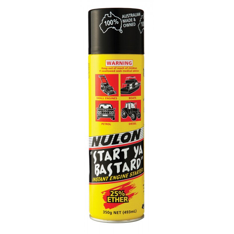

You may need the extra-strength antipodean formula

give it double that and see what happens, you wont harm anythig
