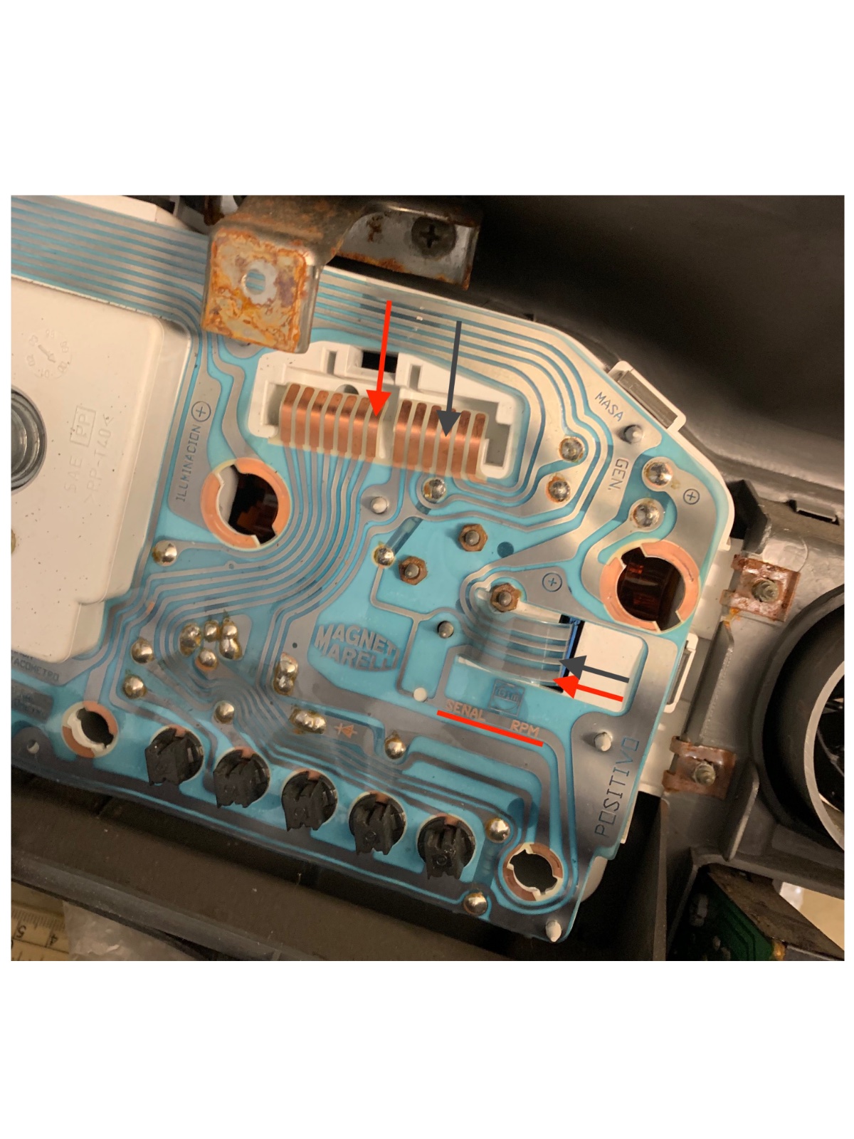

Measuring the harness side with engine running I have 0 volts.
I have traced the wires back to their sources
Black - GND
Red - goes to "SENAL RPM" rpm signal
Grey Yellow - goes to?
