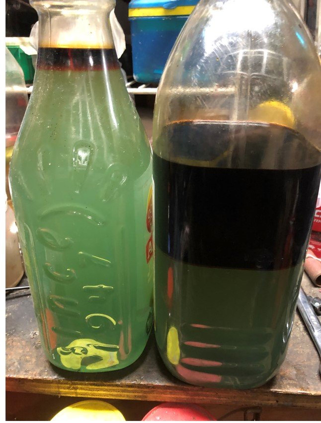

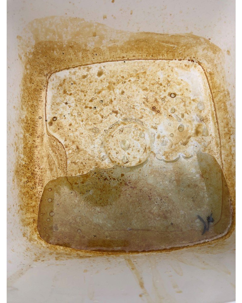

Contents of the Eolys tank - all up around 4 litres (2 litre bottle on the left and 3 litre on the right)
Seems the clear mixture has a green tinge which is denser / heavier than the brown liquid, which I assume was the original remaining Eolys
The clear mixture also leaves a yellow stain (see ice cream container). It does not smell like diesel and diesel would not leave a yellow stain.
Any guesses as to what it might be ? Could it be one of the other DPF fluids put in by mistake ?

Oh dear, looks like Kiwi flavour Mad Dog 😬
x 6961
Re: 407 Hdi 2.7 DPF tank and Eolys union plug
I dread to hazard a guess, but whatever it is you won't want any of that injected into your fuel tank.
Whether this has affected the pump operation previously I don't know, but even mixing the wrong Eolys additive can cause pump failure.

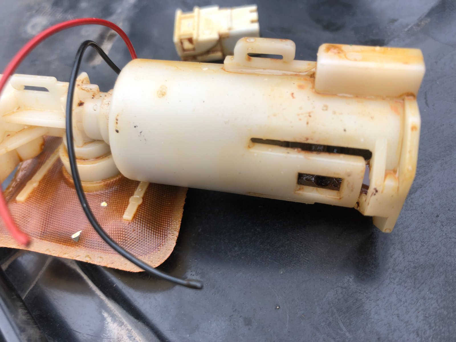

Finally pulled the additive tank out and tested the pump.
Not pumping so suspect it is a goner - I 've read it is a solenoid dosing pump (eg 1 pulse is say 1 ml so when the tank flap opens the ECU pumps it a few times to release the 10 ml or so of Eolys into the tank)
There is also a rattle inside so suspect something is loose.
Tank unit is sealed so i might cut it open for a look see - I suspect you might be able to jerry rig a pump from a CITROEN C4 Picasso Additive Tank Pump 9658411580 1525lk
I've found a spare unit so will see if that works and fixes the issues (or will just add a syringe of 10ml of Eolys per tank fill up as a bypass)

I suspect the clear liquid added was a DEF fluid / Ad Blue ( injected into the exhaust to lower nitrogen oxides), which is a mix of urea (32.5%) and water (67.5%) (which is also explains why the Eolys floats on top)
The yellow stain is just iron oxide

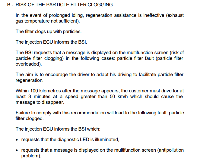

Also Bosch manual (at http://citroeny.cz/navody/c5/System_Bos ... cky%20.pdf) within 100km of the DPF risk of blocking warning, drive for minimum of 3 mins at speed greater that 50 kms to generate exhaust temp (and exhaust pressure to blow the burnt ash out) to start DPF regeneration

Soak some of the clear liquid on a rag & leave is for a few days, if it's adblue it will start to crystallise.

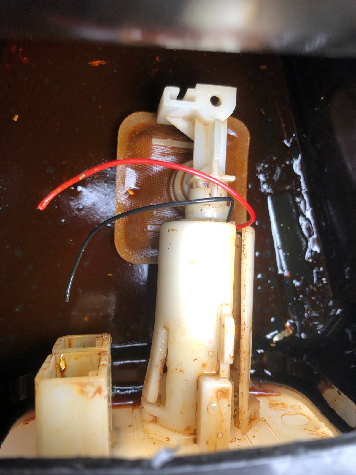

a) decided to test if the car would run and also regenerate without the additive tank connected. So, bolted the diesel tank back up, plugged the tube to the tank and mixed around 10 mm of Eolys with diesel and poured into the tank (mine was just filled up). Took it for a high speed run (80-90 kms) in 3rd gear and after around 15 mins the "risk of blockage" warnings stopped coming up. Also the MIL light cleared it self. Seems the car does not care if the tank is there or not, given there is only one electrical connection to the pump.
My theory is the Eolys gets burned with the diesel and the cerium / iron oxide is "soaked" up in the ashes in the DPF - when it gets hot enough (eg high speed runs or 450 degrees), it triggers a burn (think thermite reaction) and clean / unblocks the DPF.

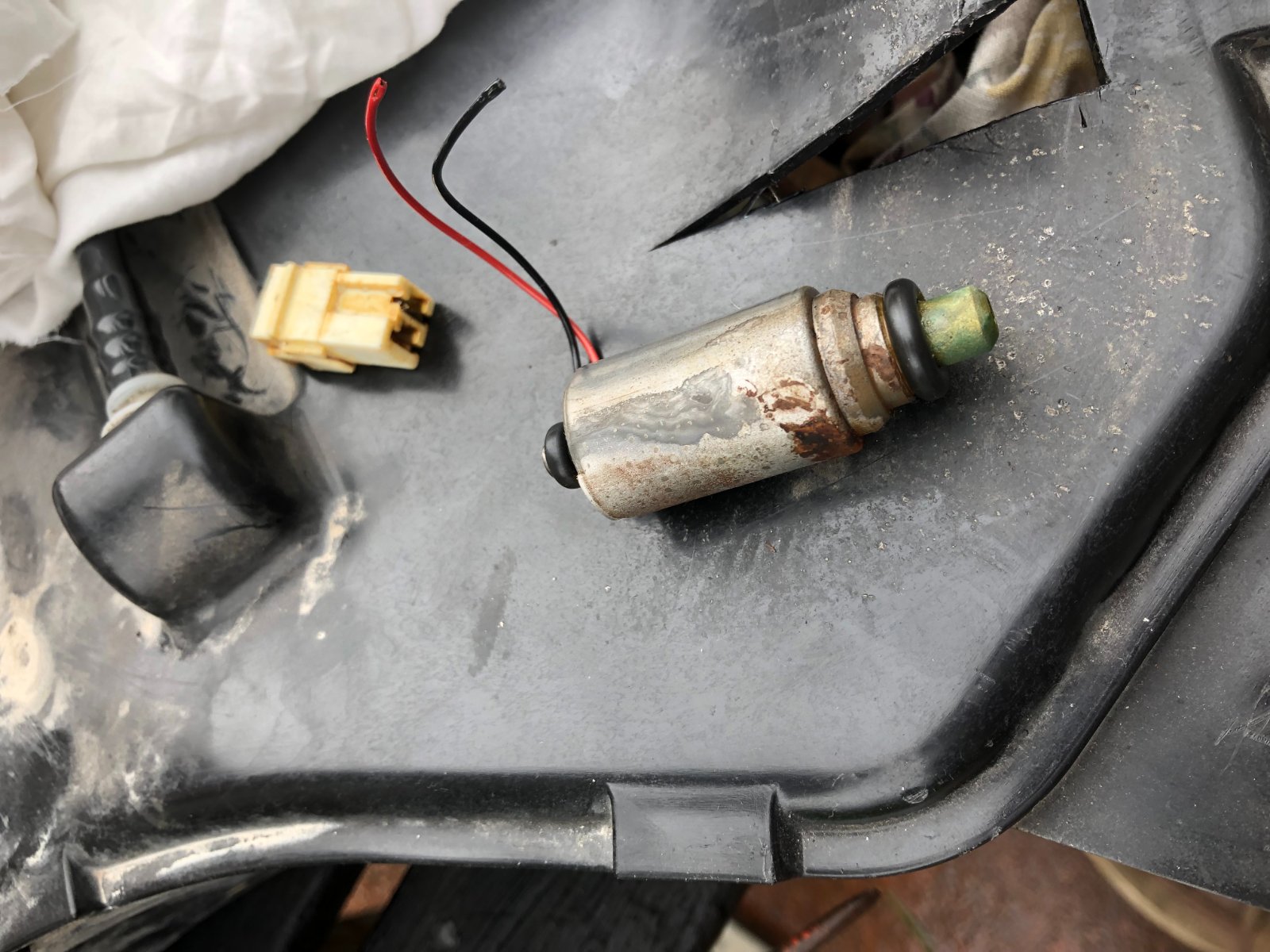

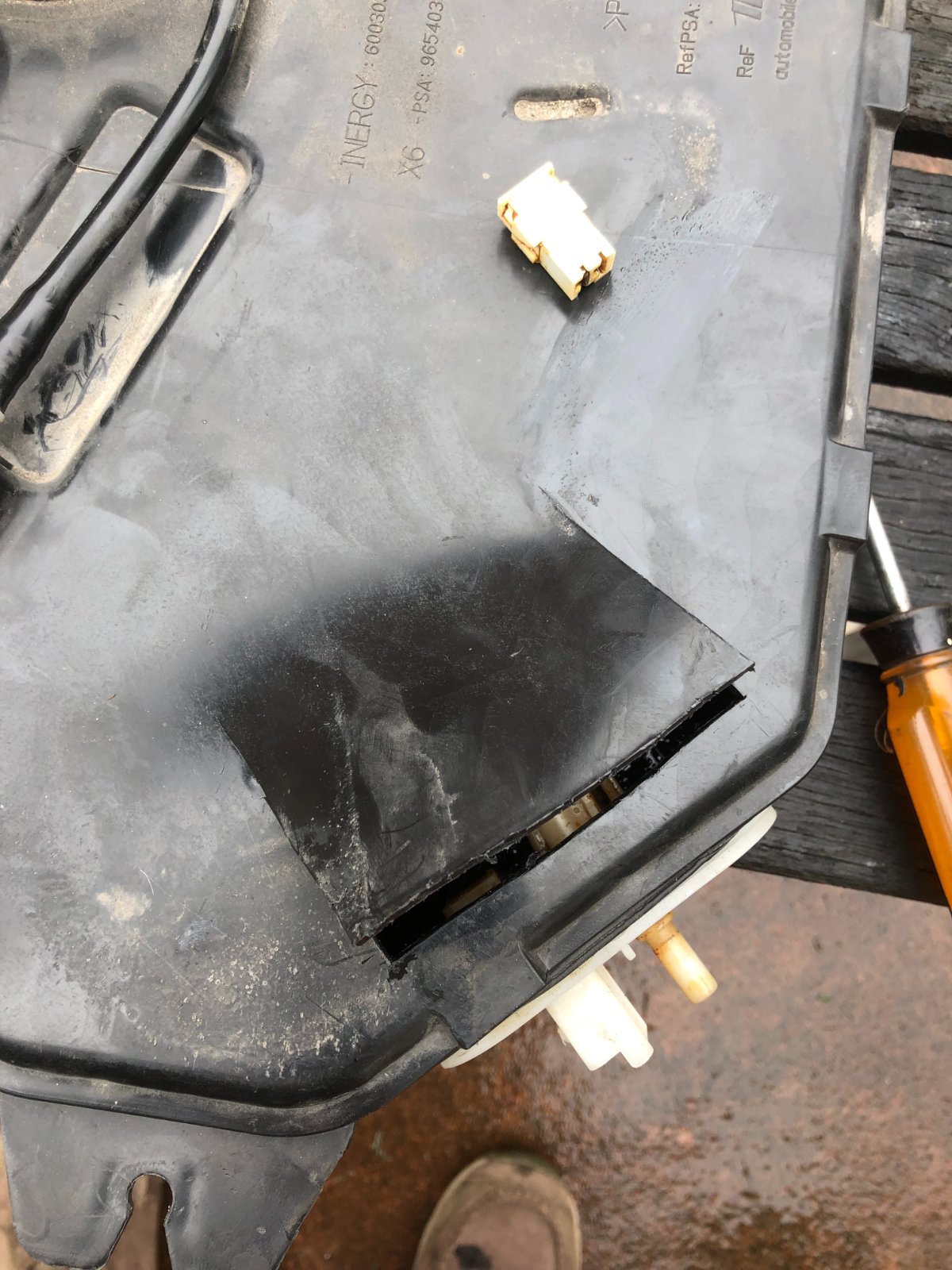

b) I cut an opening into the DPF tank (sharp stanley knife worked) to see what was inside

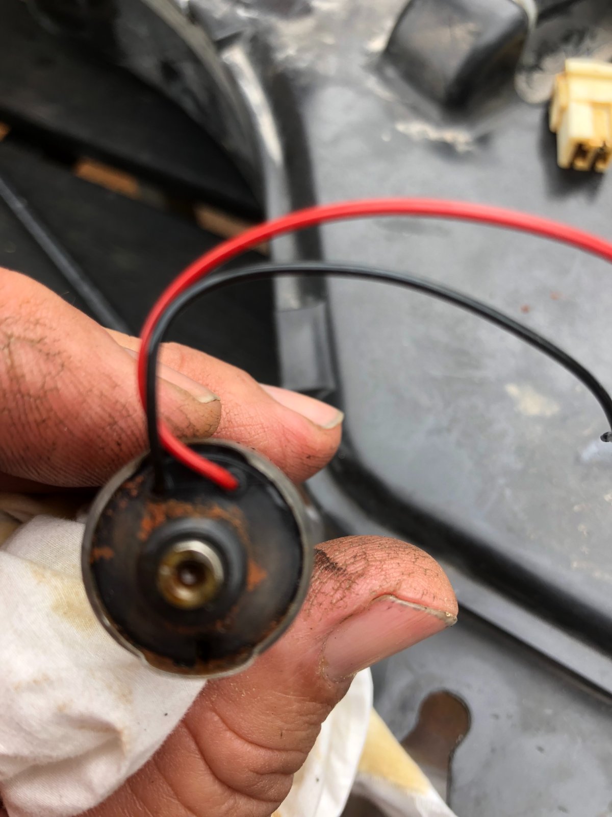

Surprise, surprise the two wires to the pump where loose - I suspect the Ad blue water and the connectors did not like each other. The loose rattle was the electrical plastic plug that came loose.

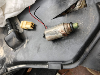

I unclipped and removed / cleaned the pump with contact spray and after a few hits / air compressor blows, could get it to pump - its a pulse type will only pump once for every touch to the battery. Again, I suspect it did not like the Ad Blue water as there was a bit of rust.
The plan is to fix the electrical, refit and reweld the tank top and see if it works.
Fall back plan is top up the tank each refill with Eolys - nice
See happy snaps

naked pump
naked pump
the pump removed
the pump removed
realising that the wires were not connected in a sealed tank
cutting open the tank top

Finally, for fun, I pulled the Eolys additive solenoid pump apart. Seems the water did it no good as seized up the internal sliding plungers etc - a bit of fine grit sandpaper and it seems to be working again (eg clicking and moving the various components to suck and pump the oil).
