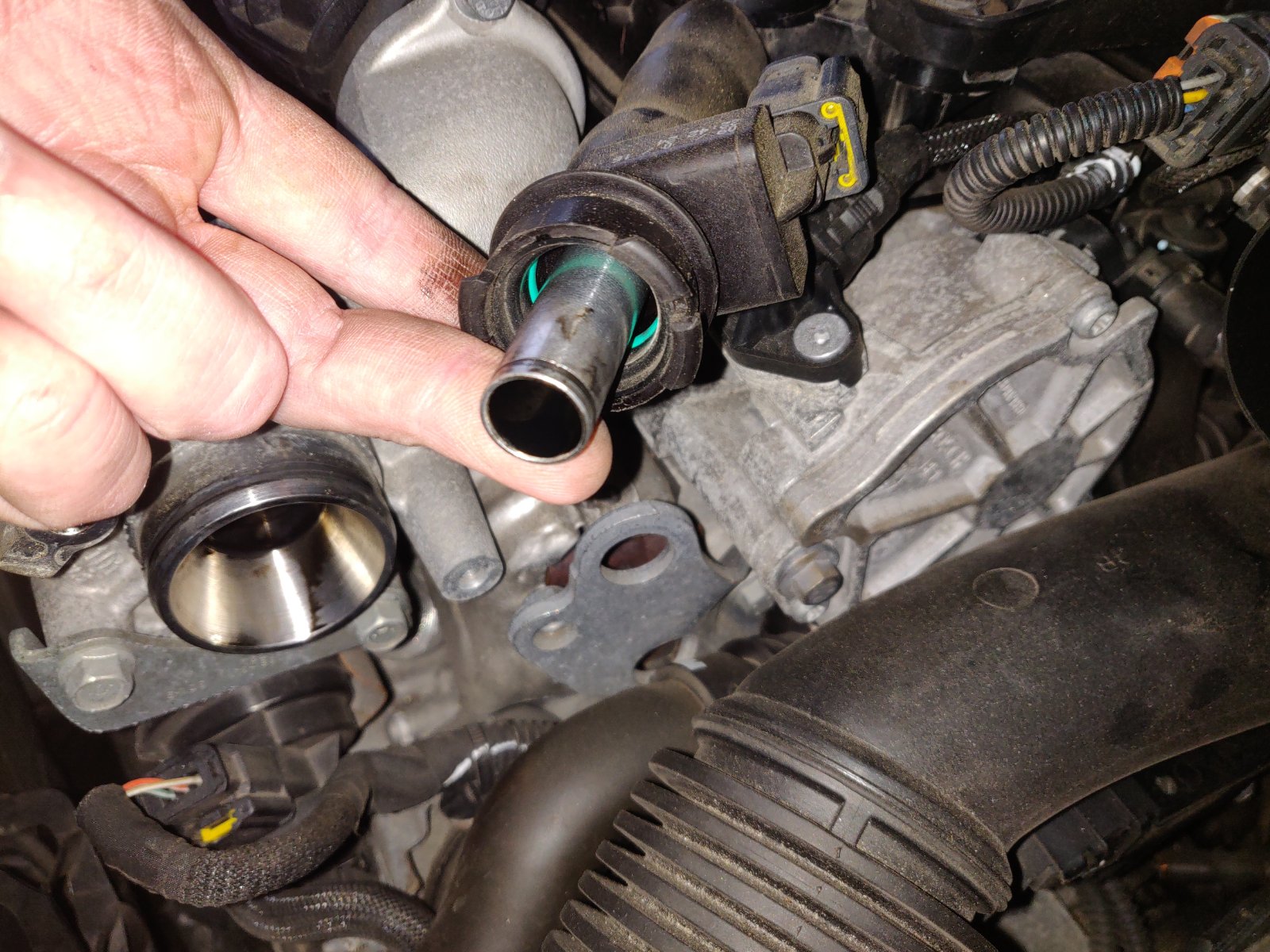

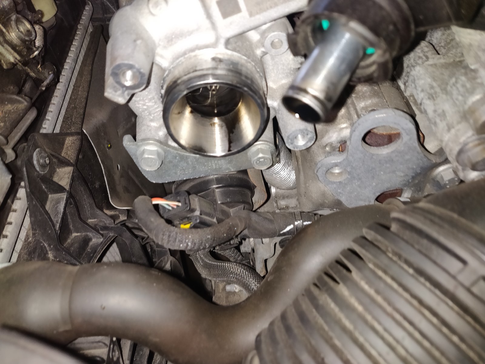

I've changed the oil and checked for oil leaks and I couldn't find anything. The only thing that looked weird to me was that the intake on the turbo was pretty oily and the breather tube from the crankcase was also dripping with oil.

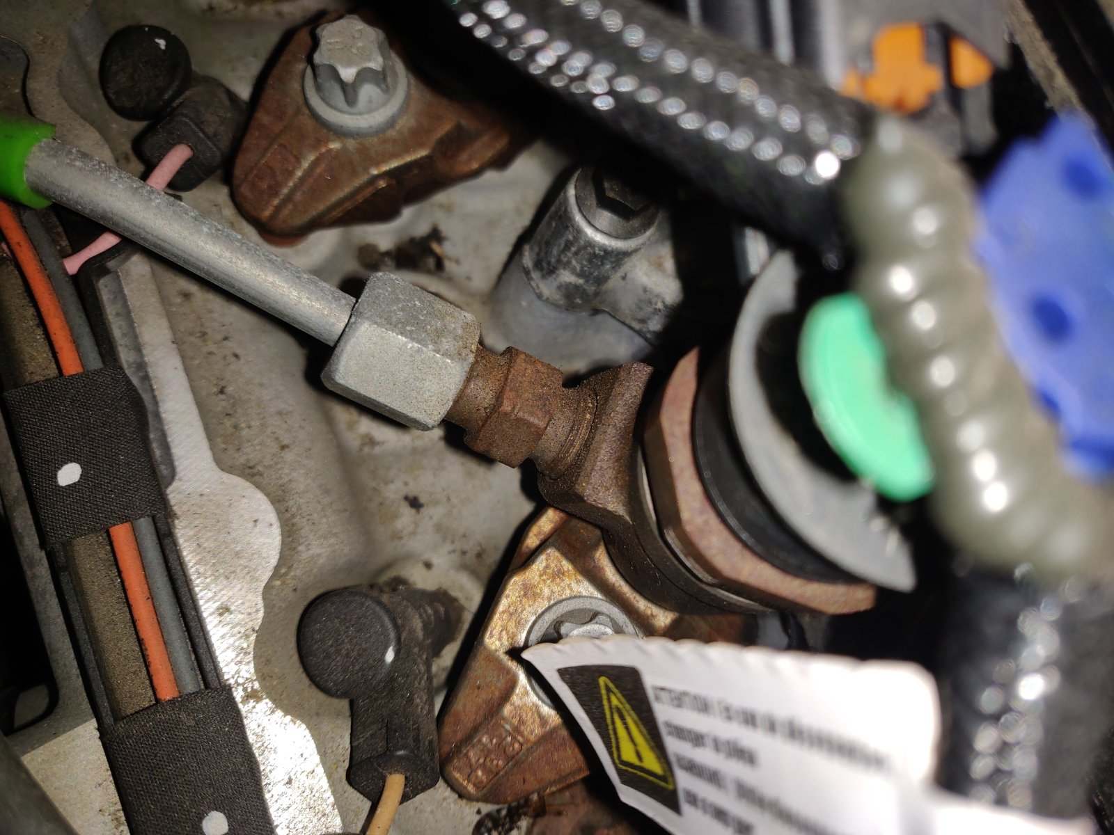

I took some pictures of injectors and there didn't seem to be any oil on the backside of the engine.
Here's some pictures of the breather tube and the back of the engine at the injectors.

Nego2403 wrote: 15 Dec 2021, 19:34 I've changed the oil and checked for oil leaks and I couldn't find anything. The only thing that looked weird to me was that the intake on the turbo was pretty oily and the breather tube from the crankcase was also dripping with oil.
