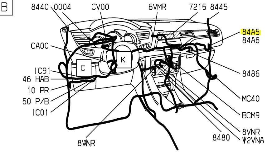

@GiveMeABreak:
Hi, Marc, thanks for the reply, but for me the main problem is, that this module is not behind the glove box. the only thing there is is the airbag and equliser.
I know about the integration and today as i mentiont i try to locate this module by follow the wiring and also the purple antenne wire.
The reason i want install this module is, on the diagbox i get a fault code about communication even that i switch of the MDS module.
it seems, that this thing is somewhere in the dashboard, but where......

Re: chance m/m to h/b ng4
Its behind and above the glovebox.
84A5 is the MDS unit - if you open the passenger (right) door, and take out the triangular end piece to access the insides, then you may see it.
Unread post by Kees »
@GiveMeABreak:
Thanks Marc, you help me a lot with this!!! youre great! thanks again.
