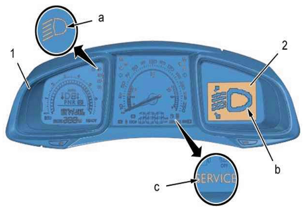

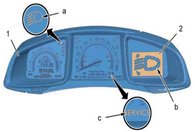

Ok so I can't be 100% sure on the DS5 that vertical levelling is maintained, but you will lose the directional function. I had exactly the same fault on my X7 with directional lighting. I had both height sensors replaced, problem sorted in my case. Although mine had Hydractive suspension, the same principle applies.
So there are several possibilities, depending on which warning lamp you have and message:
Key:
Key:
- (1) Instrument panel .
- (2) Matrix screen on the instrument panel.
- "a" Dipped headlamp indicator.
- "b" Automatic height correction fault symbol.
- "c" Service warning lamp.
- Flashing of the dipped beam indicator
- Appearance of a message on the instrument panel matrix screen
- Lighting of the "automatic height correction" fault symbol and message on the instrument panel matrix screen
- Lighting of the "service" warning lamp
- Emission of a sound signal at the steering wheel switch module

Well I know in my case the warning given consists of a combination of;
My fault is also somewhat intermittent as it will appear fine for upto an hour of driving with the lights on but then the message will be triggered, regardless of the dynamic function being enabled in vehicle settings.
