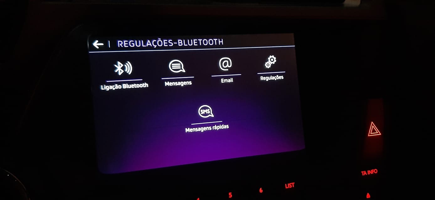

Could it really be Connected Services or geo-location related? The photo is from Portugal and with Conected services activated and available...

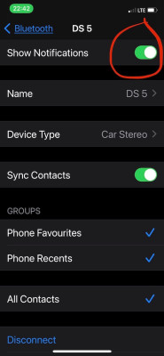

And it hasn't got anything to do with Services nor with location indeed! It's simply down to phone settings!

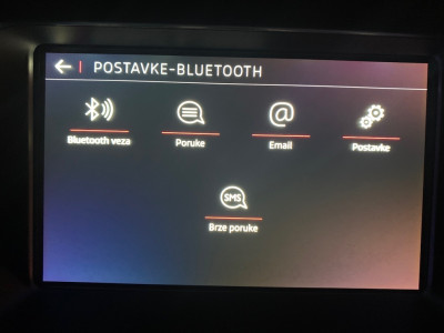

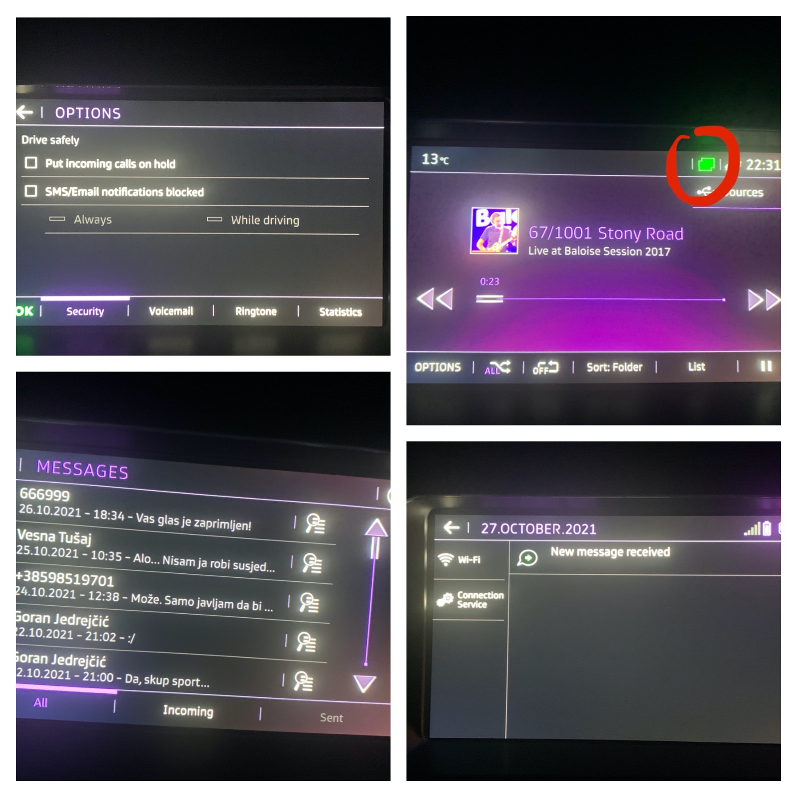

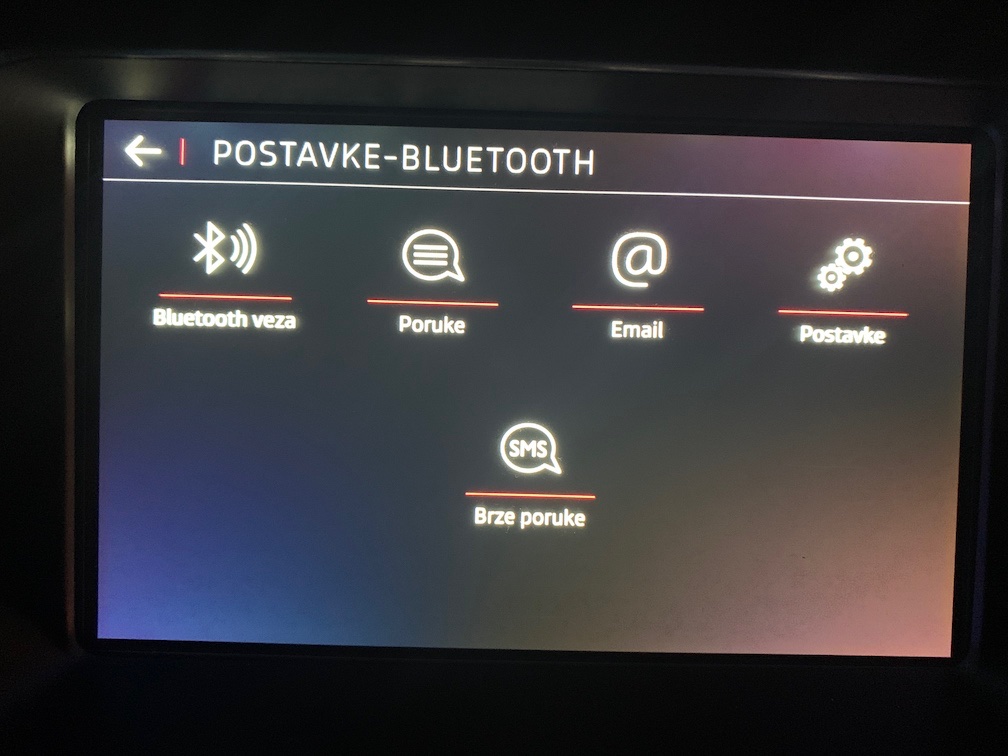

Just like you sespected (and with always helpful imput from DS Portugal FB group) I realised I hadn't got this option turned ON within my iPhone BT / DS 5 settings. Once enabled, two missing options appeared: And notifications for SMS work: Just can't yet get eMail notifications to work the same way!?

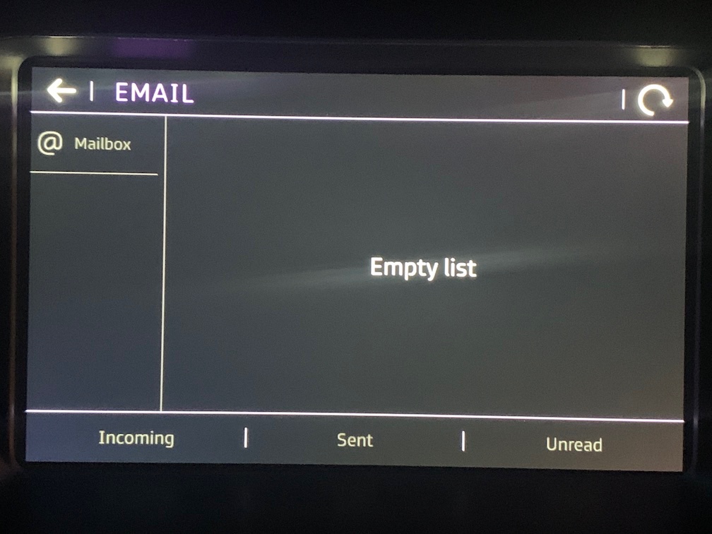

For some reason the list is empty and all the options in the bottom are irresponsive / greyed out. So this still needs some investiogation, but it must be within the phone settings somewhere... Even if I don't solve this bit, the main thing is that notifications for more important SMS work, so I'm mostly content with this find as it was bugging me ever since i retrofitted the NAC!!
