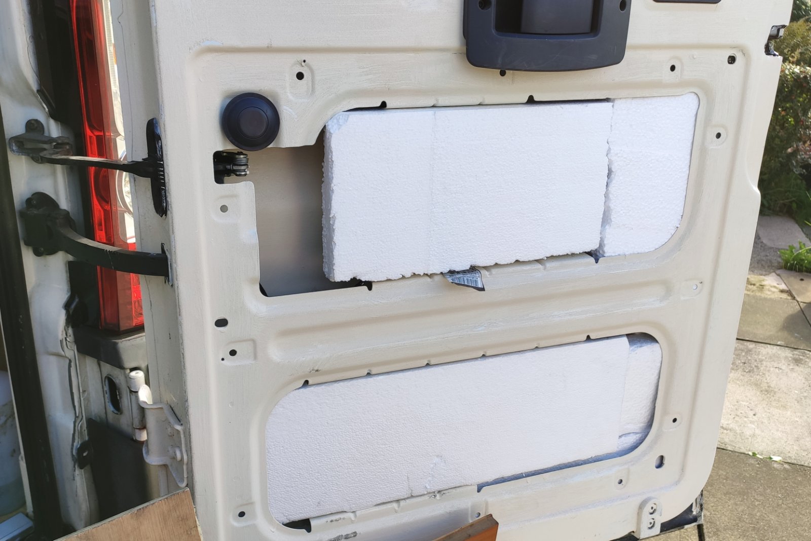

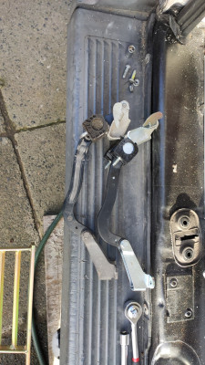

Fitted the new Rear Door Restraint Arm today. Lasted all of 1 second! The moulded in studs ripped out when I closed the door.
The arm scratched the insulated paint as well. I have refitted the old arm and await the reply from the supplier.
Started to trial fit the polystyrene insulation in the rear doors. I have created a "pocket" over the two arms - the door restraint and the cable feed. Both of these arms physically slide in and out of the door frame. By using 12mm and 30mm sheets in shaped layered panels I have filled the voids up to the level of the interior panel height. I have also started to make "pockets" out of Thermal Bubble Insulation to contain shaped pieces of Rock Wool for the upper parts if the door. Once everything is finessed I will put up pictures of what I have done.
