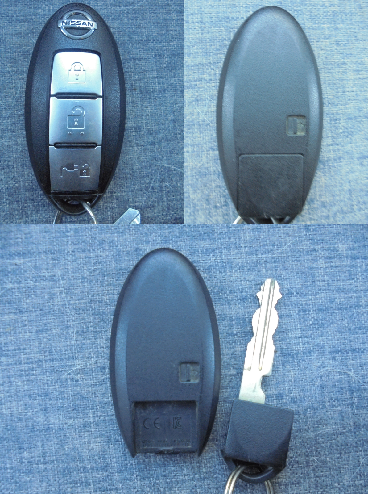

Ive just had a 12V battery flat, doors wont open scenario with My Nissan Leaf.dilby wrote: 20 Sep 2021, 11:03 I've also read that I should not remove the battery without another battery connected or else electronics get reset. How true is that and would it not have already happened?
Thanks so much for persisting with me!
One good thing and why isnt it compulsory for all these fancy locking fobs, to have a last resort key for one of the doors?
Thank goodness Nissan have one.....like this

I've never seen or known a car yet that doesn't have an emergency key blade tucked inside the remote somewhere.NewcastleFalcon wrote: 20 Sep 2021, 12:48

Good to know. I had no idea there was a key in mine hence the expletives, when I automatically shut the bonnet after confirming the flat battery, and all the doors had locked themselves overnight, and the battery and the fob between them didnt have the poke to open the doors. Very pleased the emergency key was therewheeler wrote: 20 Sep 2021, 18:19 I've never seen or known a car yet that doesn't have an emergency key blade tucked inside the remote somewhere.
The Leaf is the first car that has ever had a key hidden in the fob in my ownership. Previous cars and the current Micra, were all old fashioned key in the ignition jobs, also acting as an emergency key in one of the doors, after revealing the concealed keyhole, together with the normal "remote" fob, for normal opening and locking.
