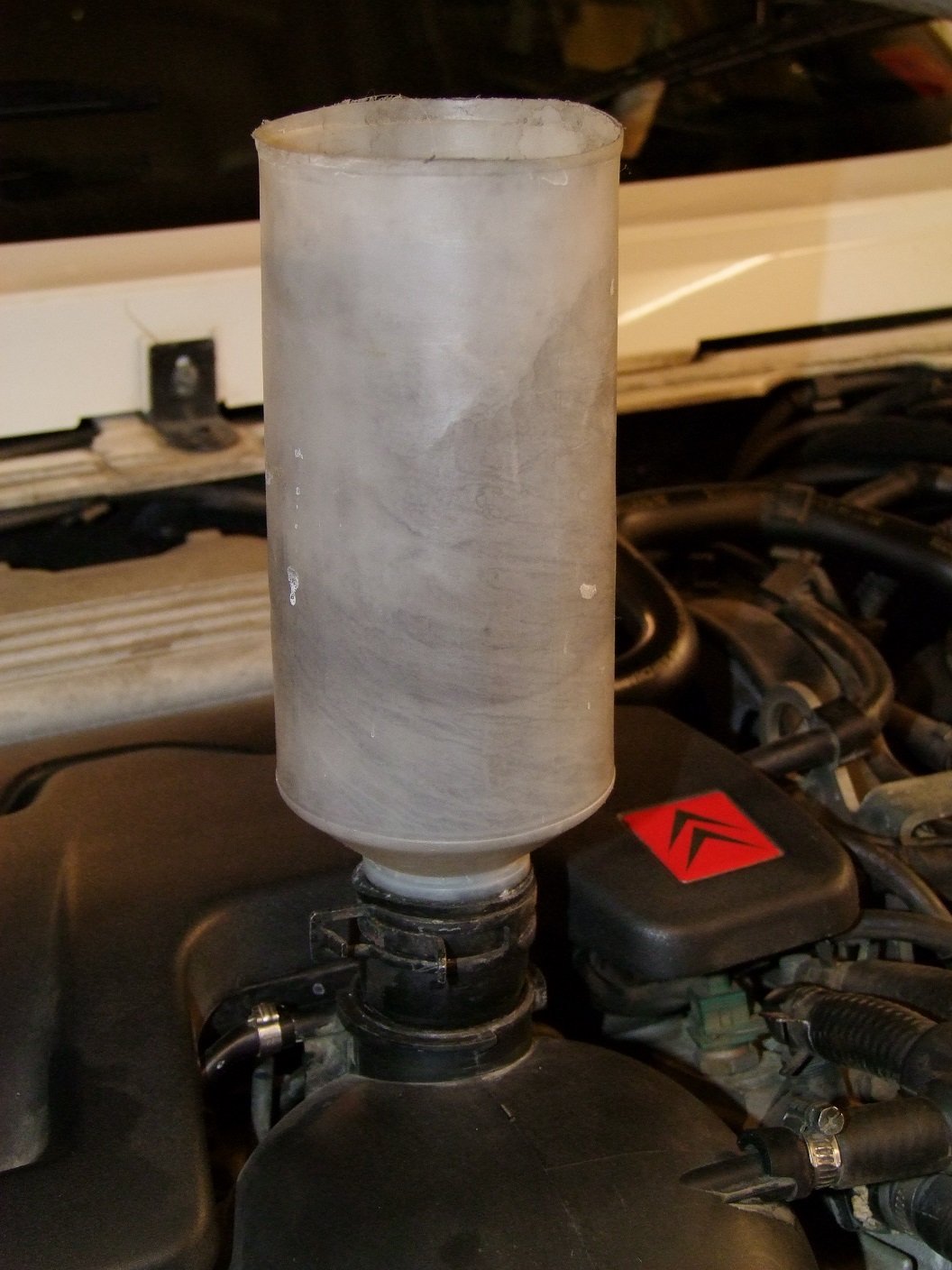

Bleeding the cooling system with a "header bottle"
Many of our cars have the coolant expansion tank not much higher (and some even lower) than some parts of the cooling system. When it comes to refilling the system, and bleeding air out, it is necessary to provide some extra pressure ('head') to help force air out of the bleed screws.
This is a DIY arrangement in place of the official service tool, and it works well.
Use a 1-litre plastic bottle, with the bottom removed, and a short length of rubber hose to connect the bottle into the neck of the expansion tank. For expansion tanks with a side overflow hole, the hose, if it fits snugly, will helpfully block off this hole. As an alternative, a spare expansion tank cap could be modified to allow the bottle to be connected. The short hose arrangement is probably the simplest.
Bleeding
Fit the header bottle, and use it for filling.
Open the bleed screws as you initially fill, and close each of them as coolant emerges.
With all the screws closed, top up the header bottle to at least half full, and try to keep it there.
Start the engine, and allow it to get up to full working temperature, indicated by cooling fans operating at least twice.
While getting up to temperature, firmly squeeze the top (or bottom) large radiator hose several times, to encourage air out.
Also raise engine revs periodically to around 2500, as this will help remove air.
Open each of the bleed screws to check for air-free fluid.
Displaced air (large and small bubbles) will be seen coming up into the bottle.
When no more air is removed, allow engine to cool with the bottle still in place.
When cold, remove contents of the bottle, the bottle itself, and set coolant level to normal.
Hope helpful.
Bleeding
Hope helpful.
