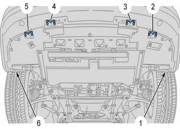

Hello everyone, i got my car back from a dumb mechanic, that has to take out the engine to do some work, he tooked all the front end, bumpers, lights etc... the car was there for a long time, now i just kinda recovered my car, because i was tired of the guy. the engine part was fixed according to him, but now i got all the errors on the dash, like parking assist error, airbag error, and the ldws because i turned on and the error just appeared, i dunno if he took them out, but my guess is yes. I think or he put them back in the wrong order or it needs to reprogram, my question is anyone can check the order from passenger side to driver side the order, since they are numbered from 1 to 6.
- x 6945
Re: 2006 C5 Ldws
The sensors have specific positions and furthermore, there is a procedure for calibrating these with Lexia.
The order is as follows:
Sensors 1 & 6 have to be orientated towards the front, Sensors, 2,3,4 & 5 have to be orientated towards the rear.
