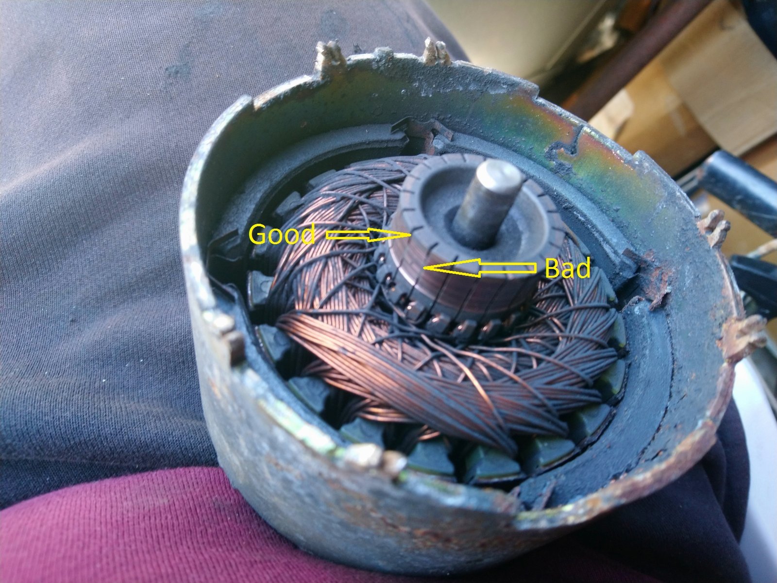

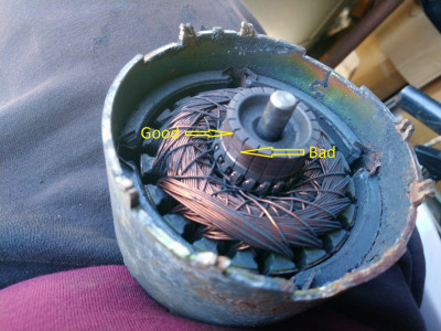

The commutator doesn't look so good in your photos. Did you clean between the segments? There should be a gap between the segments like you can see at the top and the bottom. The segments might be shorted out.
