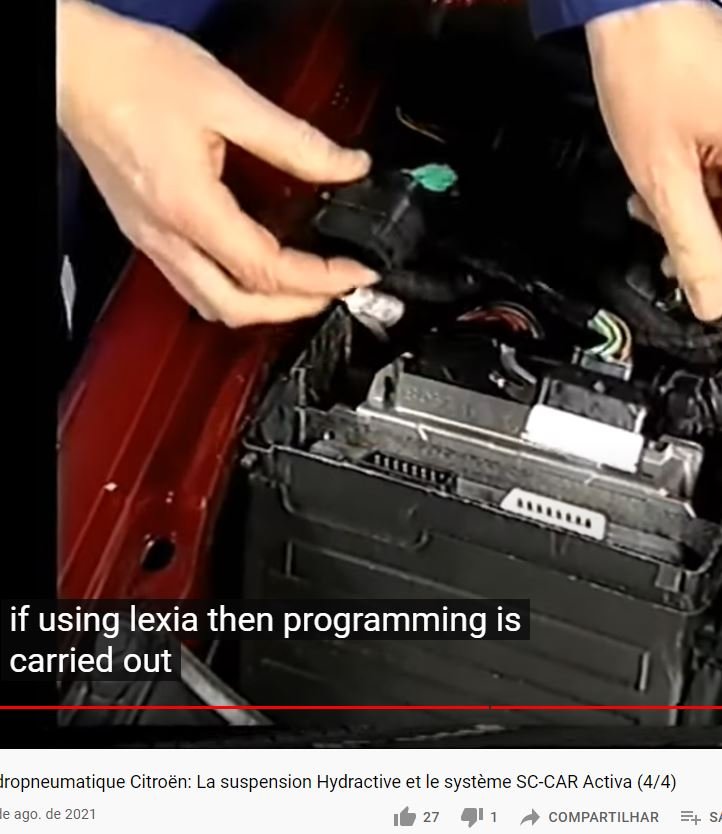

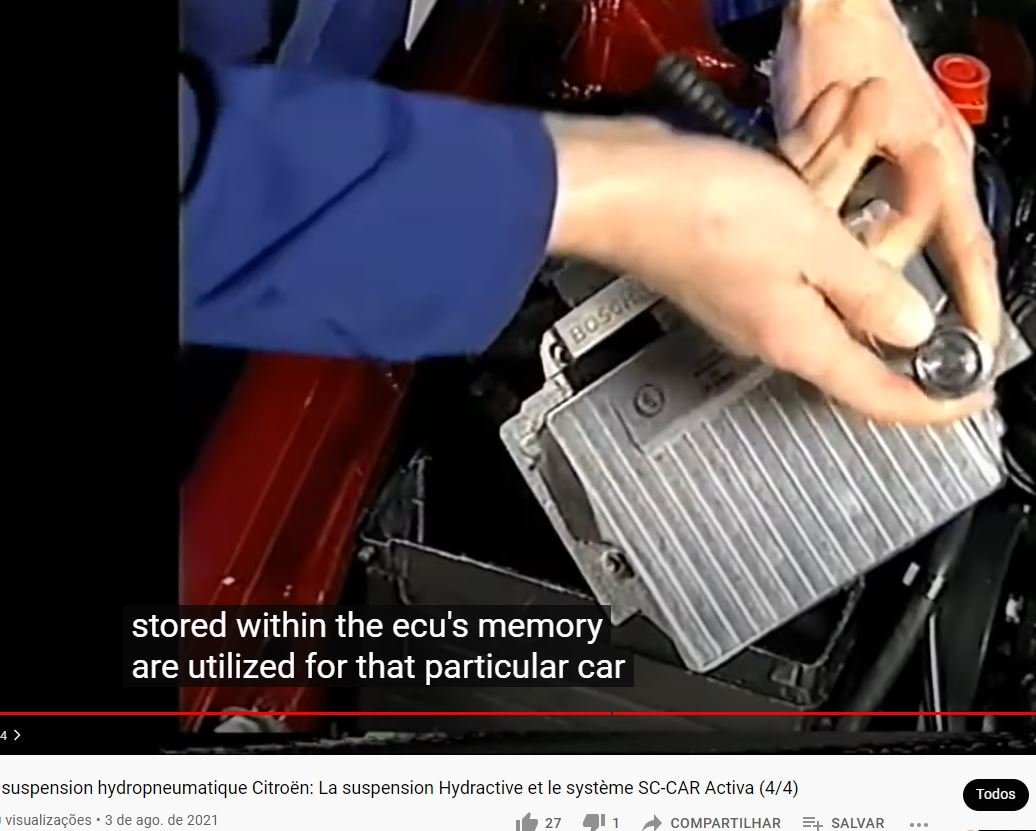

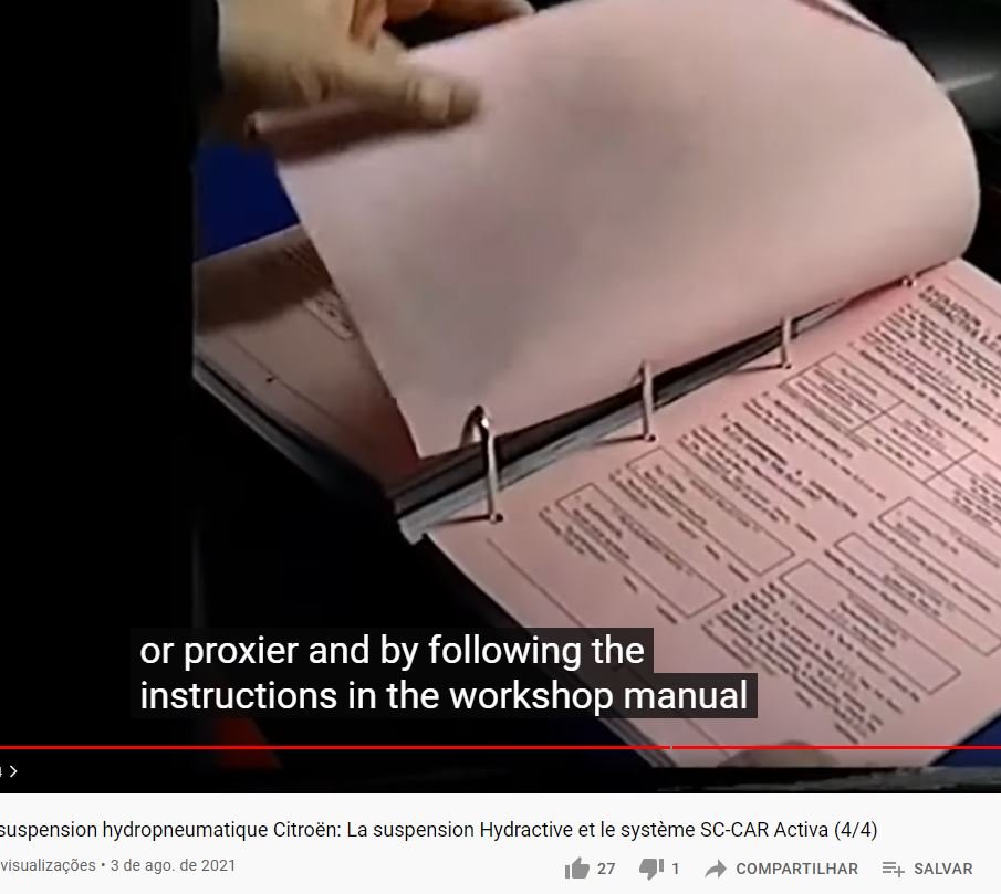

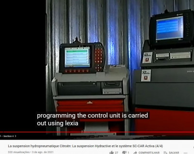

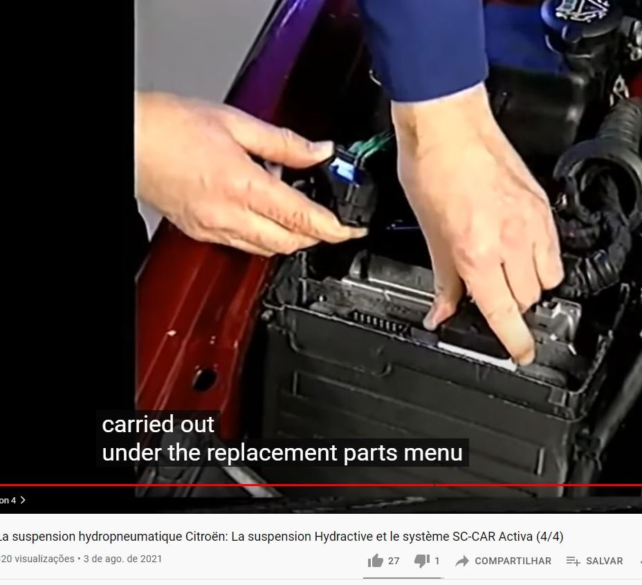

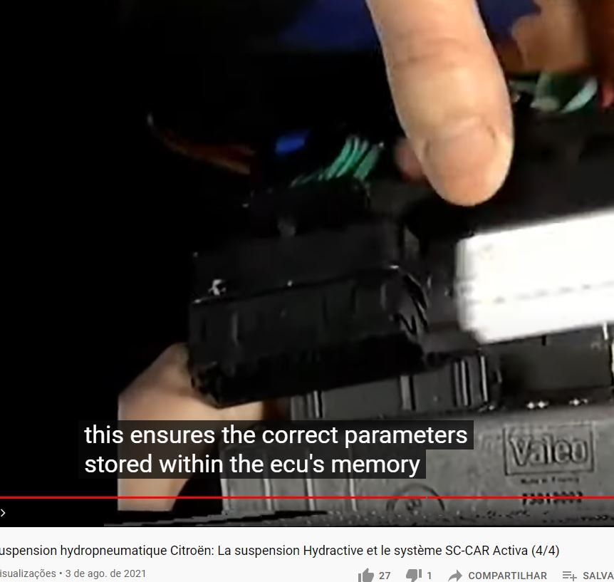

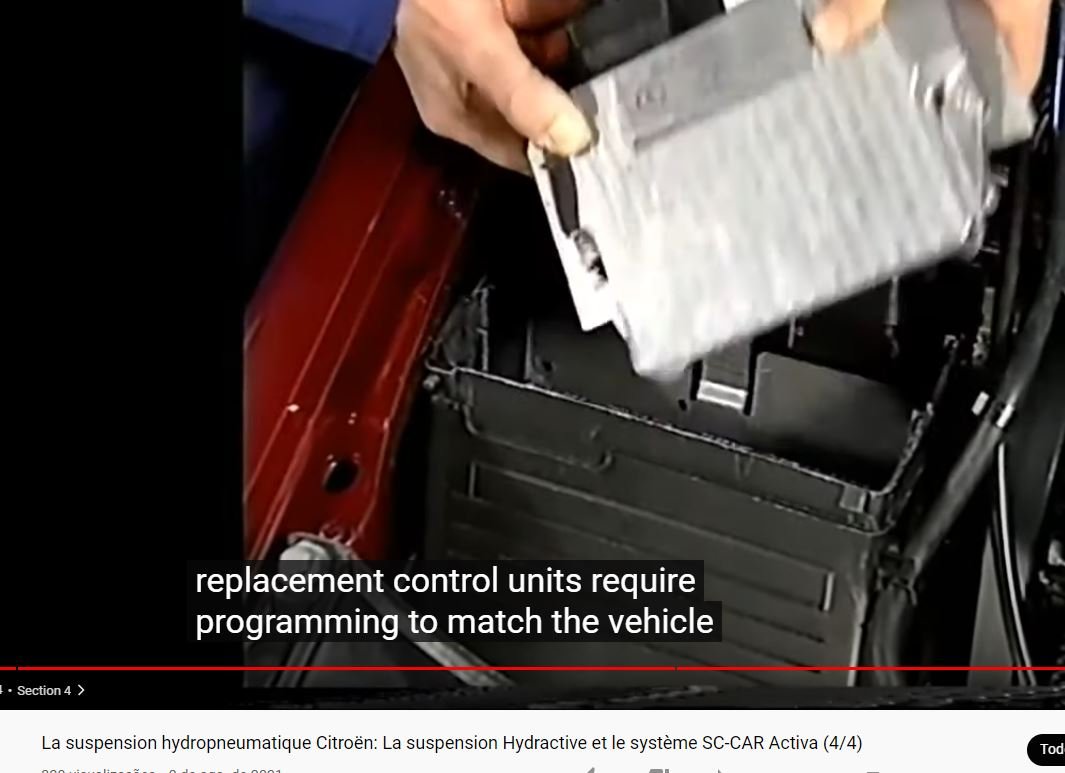

I was watching this video when I came across a very relevant information about Suspension ECU Reprogramming. Check with me.
Could someone send me the Worshop Manual pages that refer to this "Suspension ECU Reprogramming" in the "Replacement Parts" section of the menu?
I believe that with this I can program my Brand New ECU with my vehicle model. I would like to do this with some instruction, in the correct way, as it is only possible to do this once!

That is my understanding, too. Late-type (H5 iirc) ECUs need to be initialised with the vehicle type: XM, Xantia, or Activa. This operation can only be done once, and is not reversible. I think I read that the units were standard (non-Activa) XANTIA by default. I don't have the procedure pages, I'm afraid.
