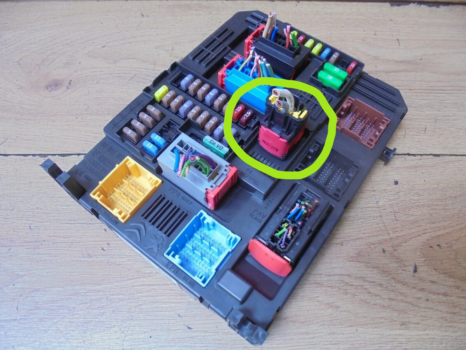

It will be a large 2 pin connector plugged into the BSI & will have 2 very thick wires coming from it.
This may not be your exact BSI but will look something like this.

Yes slightly different from mine , but yes I’ve power at this point , as you say 2 heavy wires
