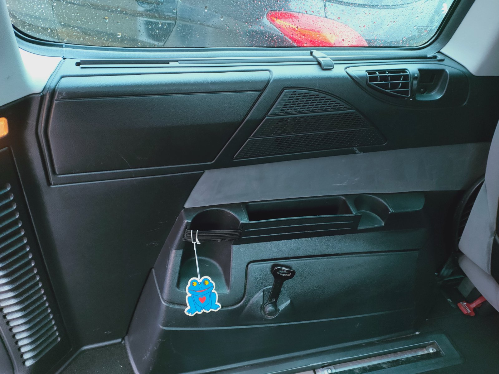

I want to take the rear right and left trim out so I can check the wiring as I have a few loose wires that I need to chase back
Hopefully the picture makes sense.

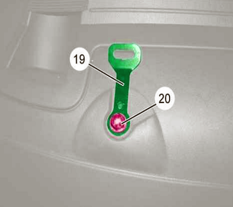

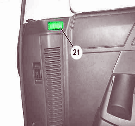

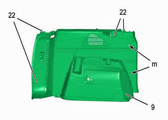

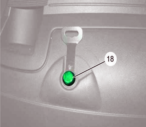

Here you go. You'll need the usual set of trim removal tools:
Rear Wing Trim Removal
| Remove the rear parcel shelf. Detach and remove the cover 18) using trim tools. | Remove:
| Detach and release the lamp (21) using trim tools. Disconnect and remove the lamp (21). | Remove the bolts (22). Detach the rear wing trim (9) using trim tools. Remove the rear wing trim (9). |
