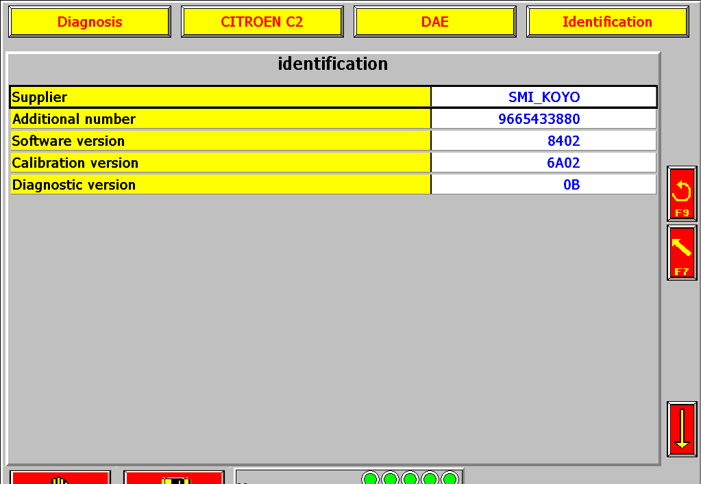

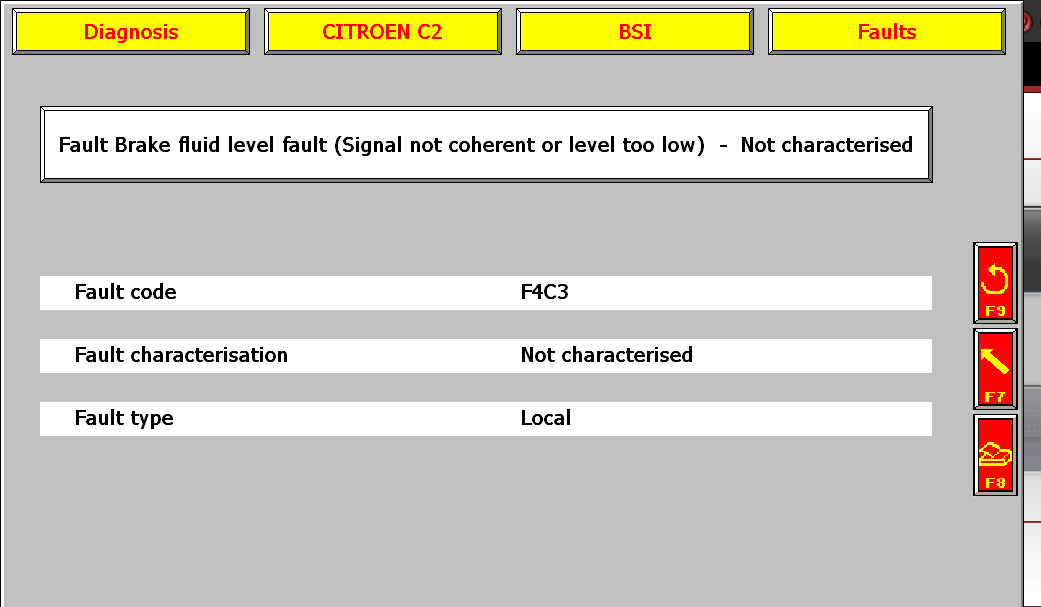

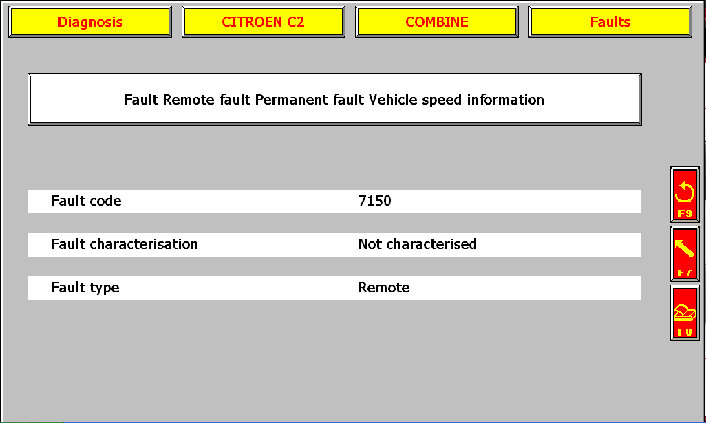

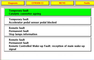

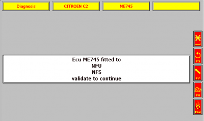

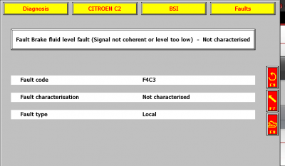

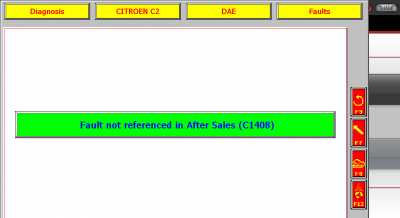

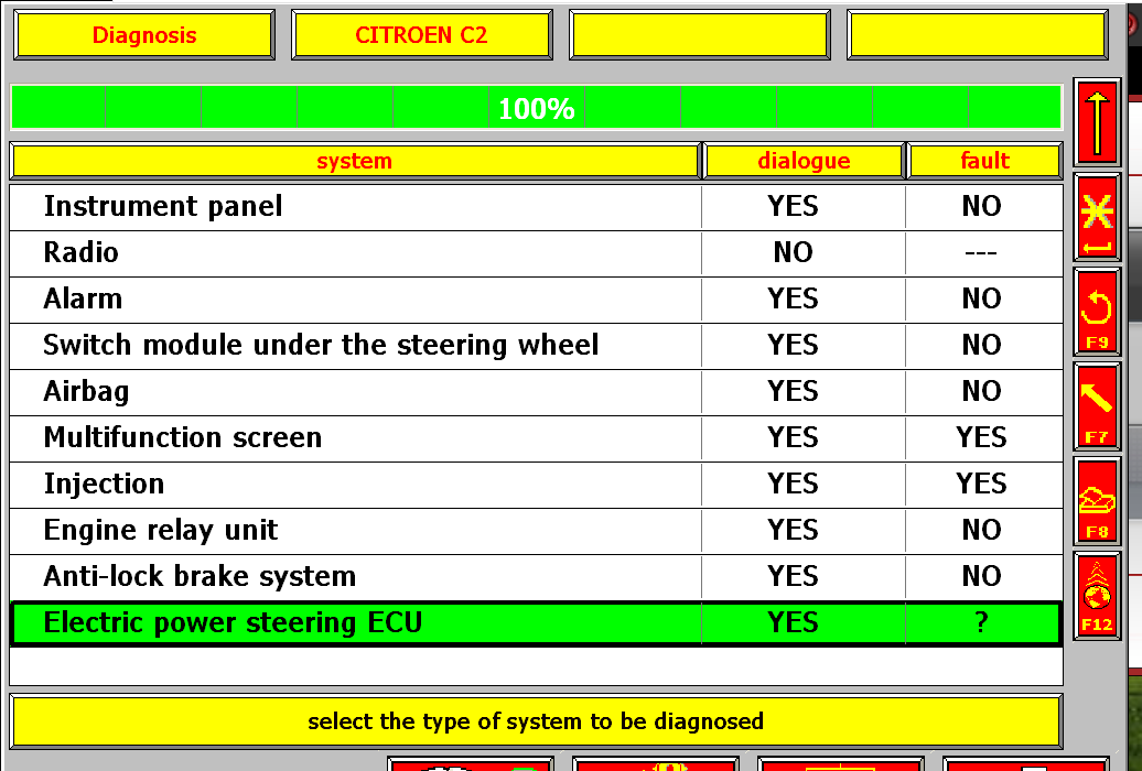

Got my Diagbox plugged in today.
Did a Global Test.
Have attached Screenshots with captions.
Did a Global Test.

Ok first up looks like there is an after market radio fitted.
Go into LEXIA and 'remove' the radio altogether. That should fix the radio error and the multi function screen error. Go into the BSI (in LEXIA) to remove radio references.
Check the brake fluid level. Top it up to the 'full' level if it isn't already.

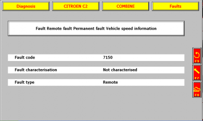

Most ECUs are whinging because they aren't getting speed information.
Catalytic converter gone. Is it OEM or after market?
Two of the other engine ECU faults appear to be physical faults? The throttle peddle, and 'brake light' switch are wired directly to the engine ECU. I'm not sure what the 'wake up' fault is about.
There are two sets of switches in the brake lamp switch. 1 set is used for the actual brake lamps and the second set is used for the engine ECU to tell if you are braking and ECU changes modes. It's also used by the engine ECU if you have cruise control. If you push on the brake it drops the cruise control out. The throttle peddles are almost bullet proof. I would look at the engine ECU electrical connectors for both of those faults. HOWEVER, the stop light switches can be dicky. The switch can be pulled apart and the contacts cleaned.
HOWEVER, THERE ARE NO ABS ECU FAULTS!!! What?!
HMM, problem; no speed info but the ABS ECU is OK?

I found this weird, I had to do Global Test a couple times as was exploring the software which crashed when I clicked check battery voltage, a couple times when I ran the test there was no Dialogue with ABSozvtr wrote: 12 Feb 2021, 19:28 The other three engine ECU faults appear to be communications faults? Very strange. The ABS ECU might be corrupting the CAN BUS info from the engine ECU after all?

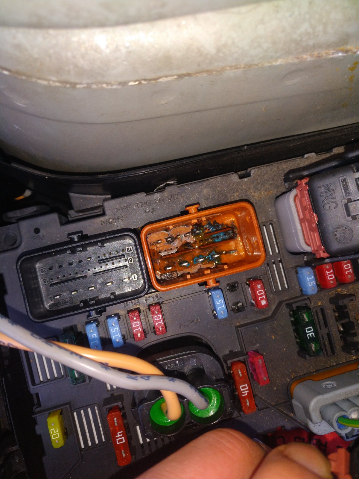

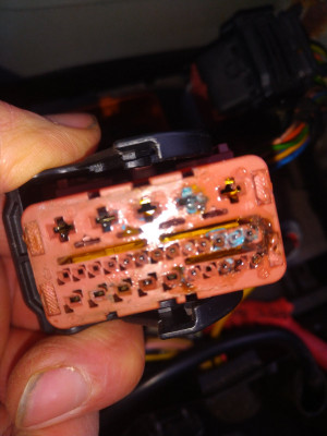

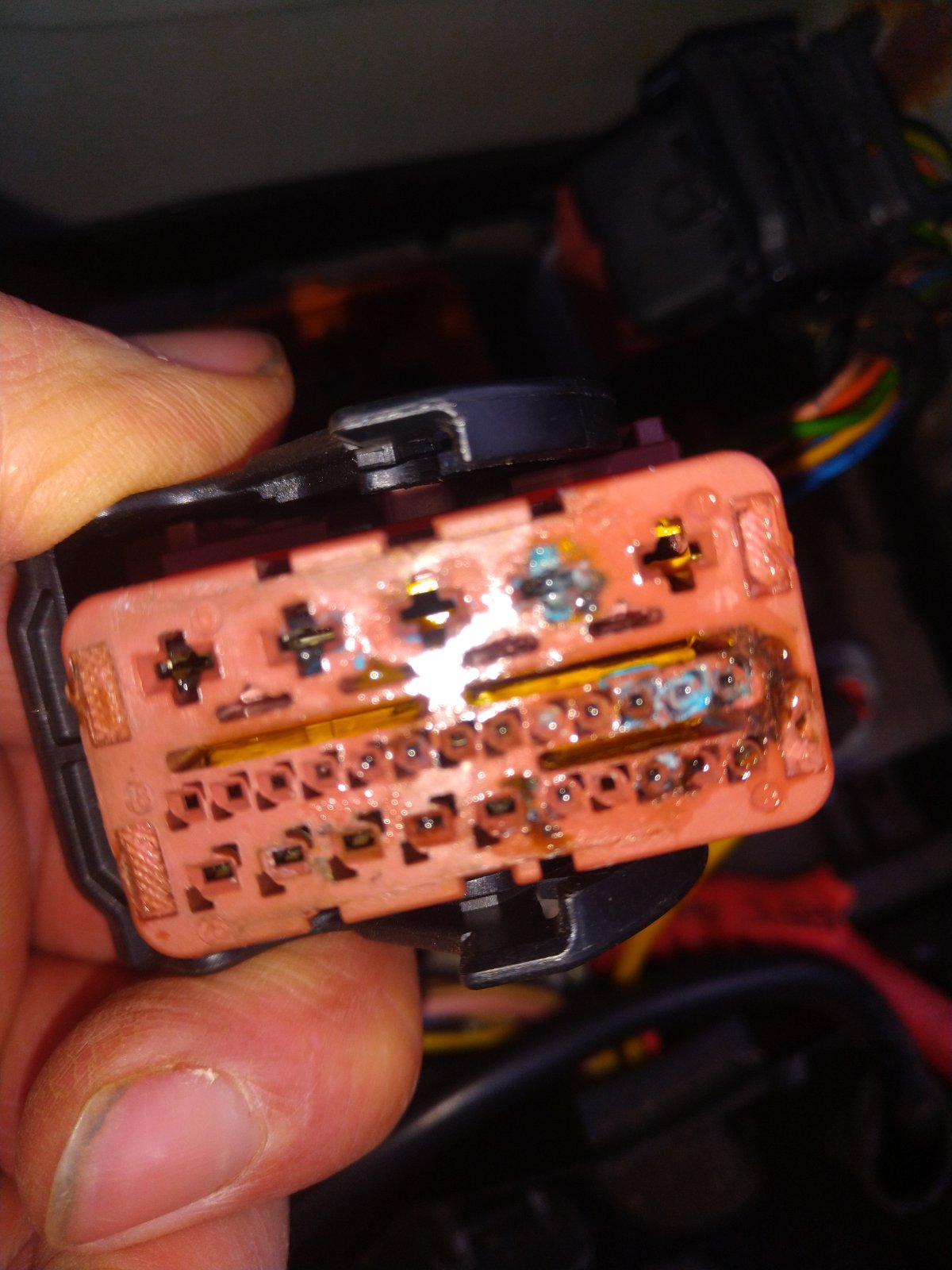

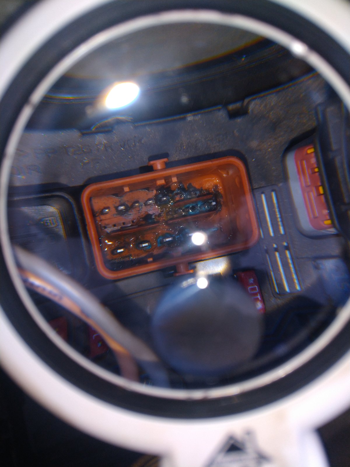

Think I've got the problem, brown connector on PSF1 (28 WAY) BACK MIDDLE OF FUSE BOARD
Water ingress pin 19 snapped
All other connectors are fine, how to I separate top layer of fuseboard
Will upload all other pics and stats later

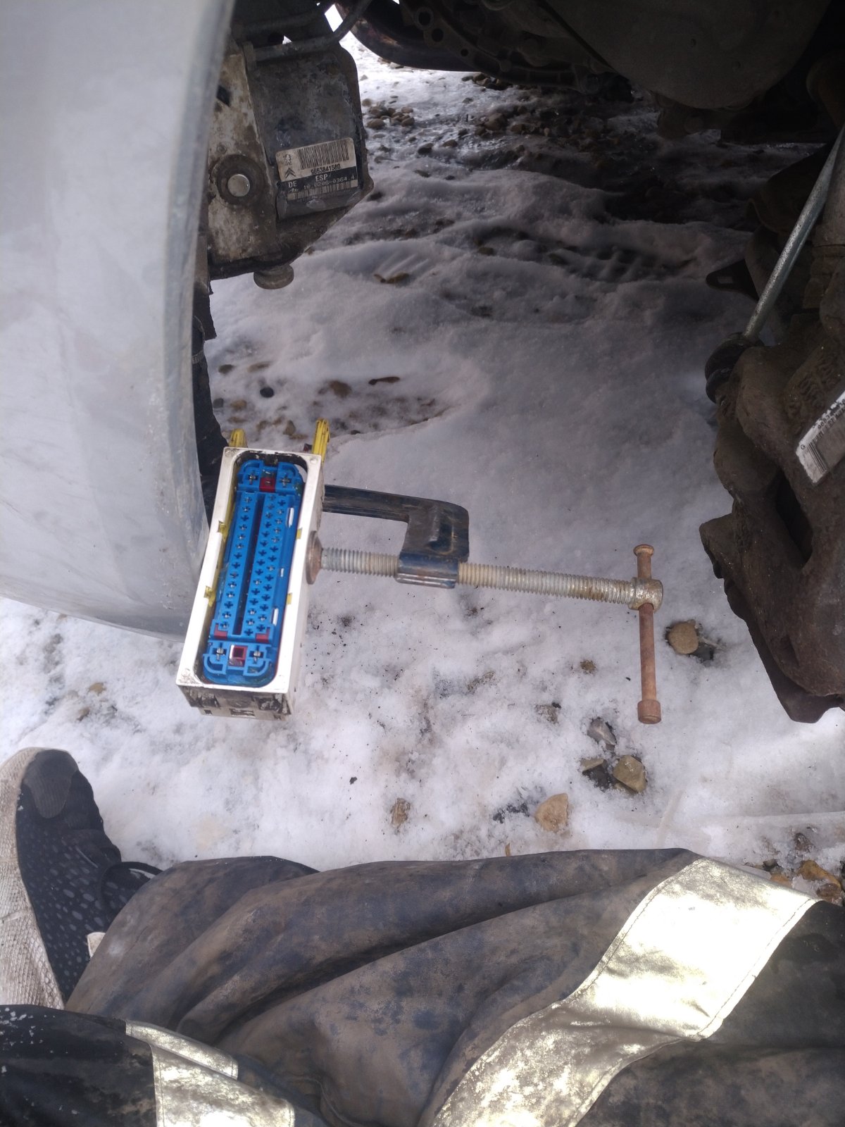

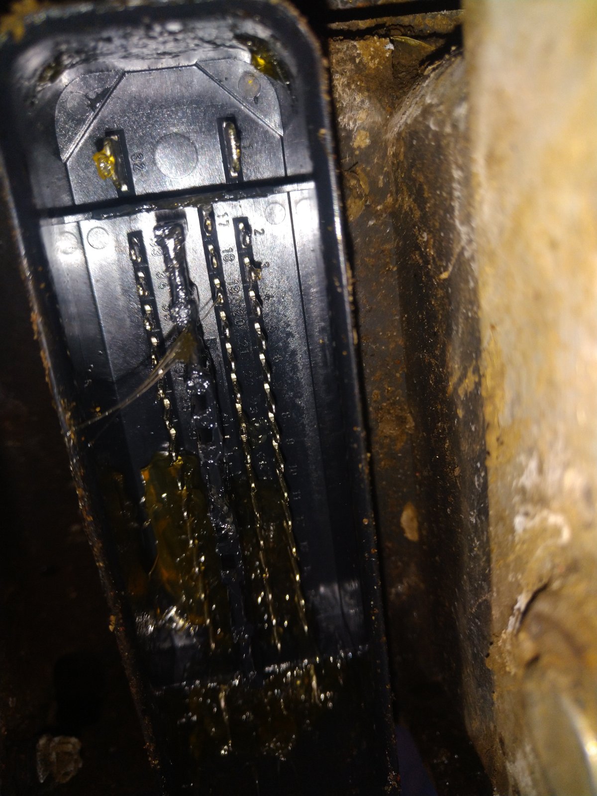

Took ages to get connector off ABS, found an easy way to just pull little yellow tabs at the bottom with pliers Clamped to side of car to make it easier when probing.
Battery before starting 12.42 V
ESP 7800 (ABS module)
with reference to Ground (Battery Negative):
Pin 1 (connects to PSF1 Black 8-way PIN 3): 12.42V
Pin 32 (connects to PSF1 Black 8-way PIN 2): 12.42V
Pin 12 (Intersystem Can Bus HIGH) to Pin 13 (Intersystem Can Bus LOW): 121.7 Ohms
Pin 11 ( Intersystem 2 Can Bus HIGH) to Pin 14 ( Intersystem 2 Can Bus LOW): 121.8 Ohms
I could not figure out how to take the ABS sensor off wheel to check, it seemed pretty stuck on there after undoing bolt. (FRONT LEFT)
Tried to check resistance on Pins of ABS/ESP connector for each sensor, just read 0 Ohms, tried measuring AC voltage while spinning FRONT LEFT wheel hub, read a little <1V but gave up on doing that and decided to test other things since voltages on 1 and 32 seemed ok.
The socket side of connector seemed completely fine, no corrosion, can just see grease in image: Thought I'd start at top of list of pins

Pin 8 (connects to PSF1 Brown 28-way PIN 19):
Opened up this connector and voila problem found: I opened other connectors on this board and all the rest were ok (couldn't get the front most grey one out though!) completely dry

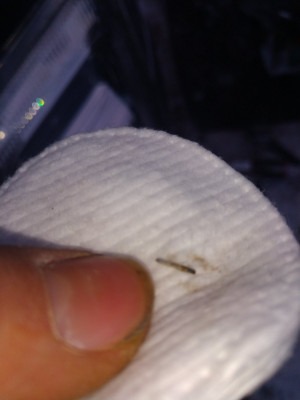

Put my little magnifying glass on to find where Pin 19 was supposed to be, was not there because it was floating in the little water inside the connector, some of the pins were very brittle and loose and had a blue substance on some of them.
Couldn't figure out how to look inside this board so unsure if any damage underneath.
I used cotton buds/swabs/Q-tip (if you're American) to clean up inside and some WD40 Specialist contact cleaner (which I've used on my Xone 92 DJ mixer, so should be fine for a car connector), found that quite a few of the pins were brittle and moving about lots when cleaning.
Put everything back together, ran Lexia again and same faults appeared so no new faults.

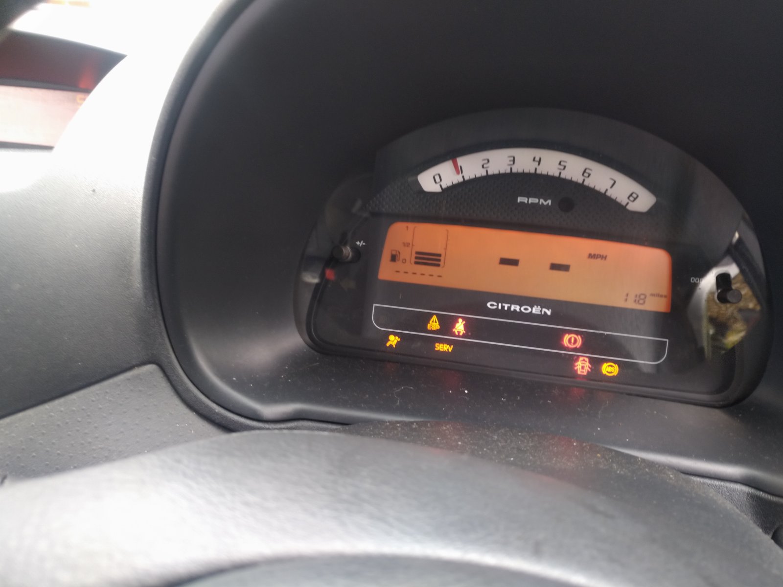

Have found the lights on dash were permanently on rather than intermittingly
So.........
- Can this connector be replaced ?
What is the part number for this connector?
Does somebody have wiring diagram for the 28 Way Brown connector, I would like to see what else uses this
