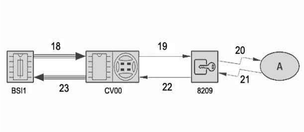

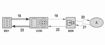

For locking / unlocking remotely using the fob, there aren't any CAN / VAN multiplexed links from the fob board - which just transmits the lock / unlock signal via a 'Hertzian link' using one of the FSK / ASK frequency modulations (20) & (21) in the diagram below. Getting the wrong combination of transmission protocol / frequency is why they won't work.
For the Ignition key transponder authentication shown here, the multiplexed connections are only between the vehicle ECUs - shown here by (18) BSI to Switch Module CV00 and (23) Switch Module CV00 to BSI. Note: I haven't shown the additional communication between the BSI and the Engine ECU here, this is just relevant to the key / fob authentication.
Components
AIgnition key with integral transponder
BSI1Built-in systems interface
CV00Switch module at the steering wheel
8209Transponder coil
Connections
No. of linksignalNature of signal
18Ignition key transponder authentication requestBody CAN
19Ignition key transponder authentication requestAnalogue
20Ignition key transponder authentication requestHigh frequency
21Transmission of the ignition key transponder’s authentication calculationHigh frequency
22Transmission of the ignition key transponder’s authentication calculationAnalogue
23Transmission of the ignition key transponder’s authentication calculationBody CAN

Yes, the FACT that the multiplexing bus structure of the ECU interconnection in the car is CAN or VAN is irrelevant. HOWEVER it IS a delineator as to the way the central locking transmitter is interrogated during the synchronization of the keys in the key coding phase. We are talking about one very specific part of the security of the central locking structure of a VAN bus car. The VAN BUS cars just so happen to have an extra layer of security for the central locking, not because it uses VAN BUS but is co-incidental to it! We are talking about what a brand new key needs to be and why OLD keys will or wont work. I am talking about, known or assumed, serviceable keys. If a key is broken...well then its broken and that's why it doesn't work!
GiveMeABreak's diagram is referring to the immobilizer circuit only. We are talking about the central locking circuit. The receiver for the central locking transmitter resides on the "HF module" in the top of COMs unit. The receiver antenna for the central locking and the immobilizer coil are physically two different things. The transponder coil sits around the ignition lock and the central locking antenna is etched into the HF module circuit board. However they are both connected to, and decoded by, the HF module. The HF receiver (for the central locking) does not "talk back" to the fob...as a rule . However a "virgin" central locking chip is "locked"...once...by magical unicorn dust!! Sorry, but I don't know how the central locking transmitter chip in the key is locked...but it does get locked.
By the way the COMs unit, CV00, is on the BODY VAN1 bus (18 and 23 in the diagram) for a VAN BUS car (the C3 that we are talking about) not CAN. But that's just being picky on my part. :-D
The immobilizer operation is EXACTLY the same for either the "CAN" or "VAN" cars and uses an RFID transponder protocol. Finding and coding in a new transponder chip to run the engine is a piece of p!$$ for either system. So making a "valet" (or whatever you might call it) I.E. no central locking, key is easy for either. Well...relatively.

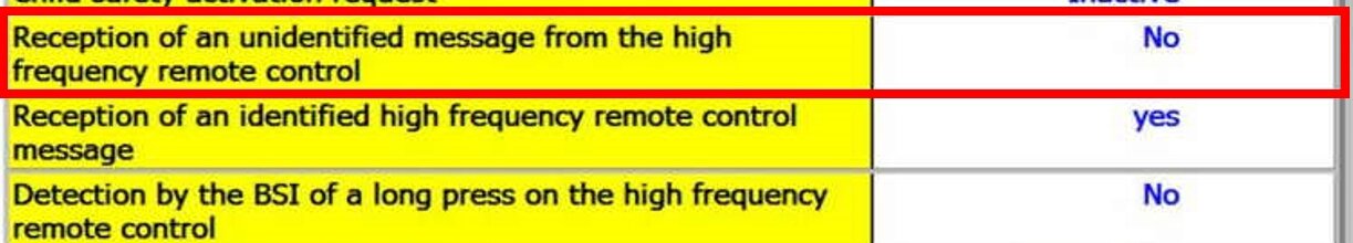

  • The BSI is acknowledging the chips in the keys for starting authentication, so the transponder chips in the fobs are coded correctly and are handshaking - fact.
  • As far as the Remote functionality goes, Lexia clearly states that it is receiving gibberish from one of the remotes - Fact
Therefore whatever is being transmitted by the dodgy fob is unable to be interpreted and therefore the locking / unlocking request is being rejected.

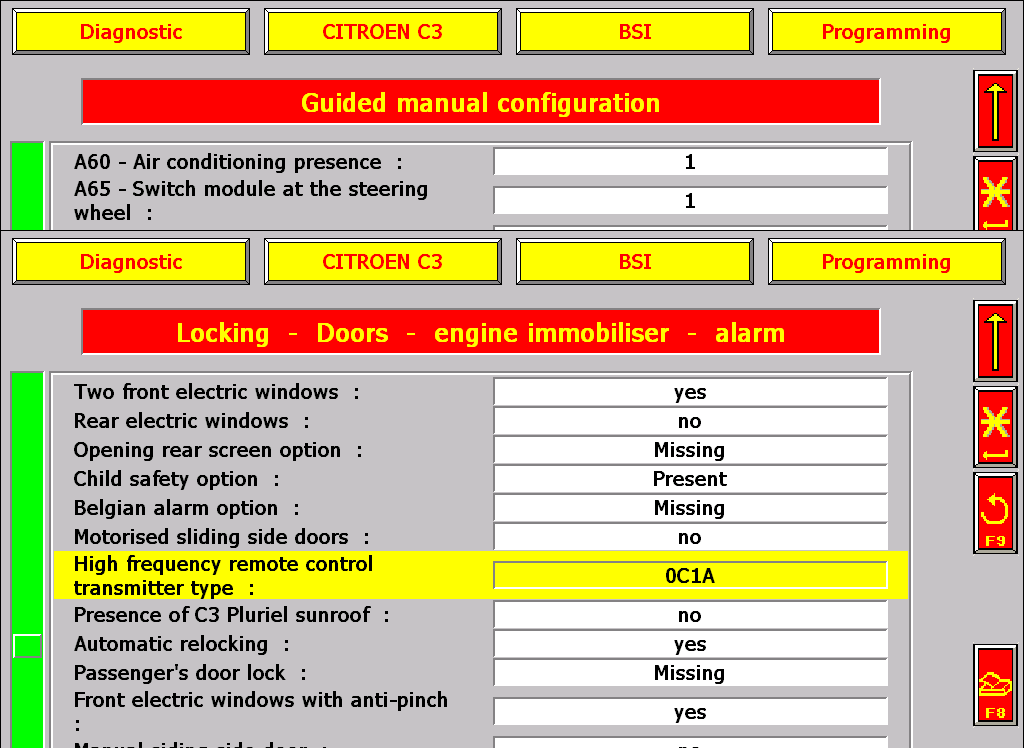

The bit that I'm most curious about is the BSI status screen that shows only one RCL module programmed. Somehow, I need to make the lower field read 2
If I went to a dealer and said I've lost my spare key and need a new one, they would be able to produce one for me. Obviously the price would be a significant proportion of the value of a 2003 C3 these days, which is why I don't propose to do it, but ultimately, the question comes down to how they would configure a new RCL fob to work with the car, and is that course of action available to anyone with a Lexia ?
At one point, while I was searching around BSI-related screens in Lexia, I found one called Guided Programming, which has this interesting line:
This is a configurable field, but when I dug deeper, it asked me for a 4 digit code and the one I used for programming the immobiliser (the one on the card that comes with a new car) didn't work, so I'm wondering whether there is a dealer ID that allows some parts of the cofiguration to be updated. In any case, to be of any use, we would have to convince ourselves that encoded within "0C1A" is the number of RF remotes........

That's LEXIAs BSI configuration area. Look at the yellow boxes at the top of the screen caps.
The steps are; Citroen-vehicle-LEXIA-RPO-DIAG-global-BSI-config-manual config-config(again)-locks,doors,engine.

I am using diagbox 7.57
I cannot find the same screen as per the original poster
Trying to find the “high frequency remote control transmitter type” setting as in the screenshot

The 'high frequency remote transmitter type' is only relevant to the small vehicle platforms from 2002 to 2005 (like the C2 and C3). You will NOT find it on any other platform. That particular remote central locking system was a bizarre system only found on the CAN-VAN systems.
What vehicle and year is this about, and again, what are you trying to do? I.E. what is the problem?
It sounds to me like the vehicle you are working on is NOT running the CAN-VAN system and that's why you can't find those options!
