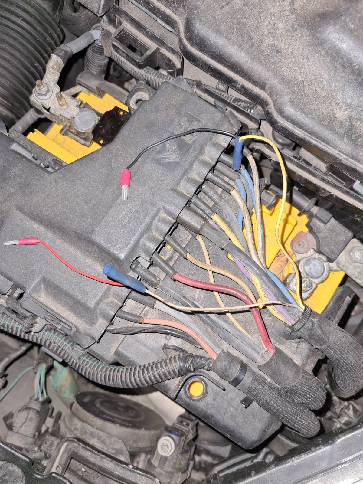

In the pic provided you can see the 2 wires which have been joined to additional connectors I have got a clue where they are for or if its anything to do with the ongoing problen
x 6945
Re: U1218 on Citroen C5 X7 1.6 HDI
Neither of those connections look official to me. Both the black and red wires look to have been 'spliced' into those yellow / cream wires and secondly, those cream wires themselves don't look right - even though they appear to come from inside the sleeve - they look far too thin to be attached to the supplies and protection unit which is where all the others go. So I wonder whether the cream wires have been added previously and then somebody has spliced off those....
In either case, they shouldn't be flailing about like that. I would get them separately insulated at the ends with some insulation tape and tie them out the way of anything else with a cable clip for now.

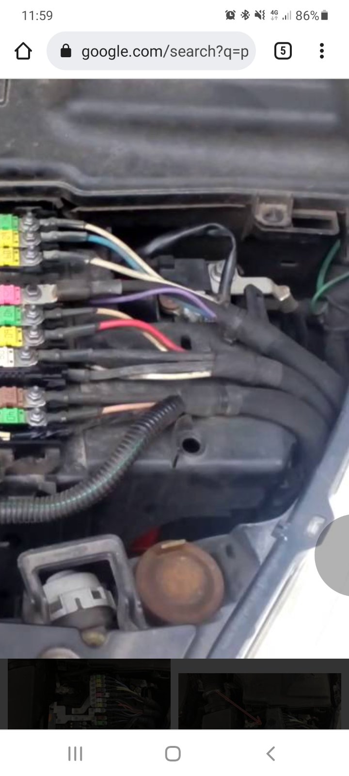

Sorry for asking so many questions but they wouldn't be anything to do with negative start stop black terminal on the battery as I don't have any wires going into it as I have seen on other images that ther is a wire sleeved in black as in the image below

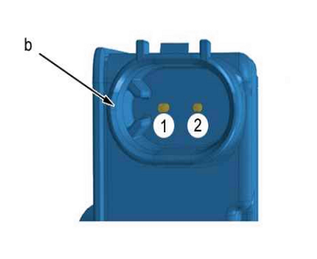

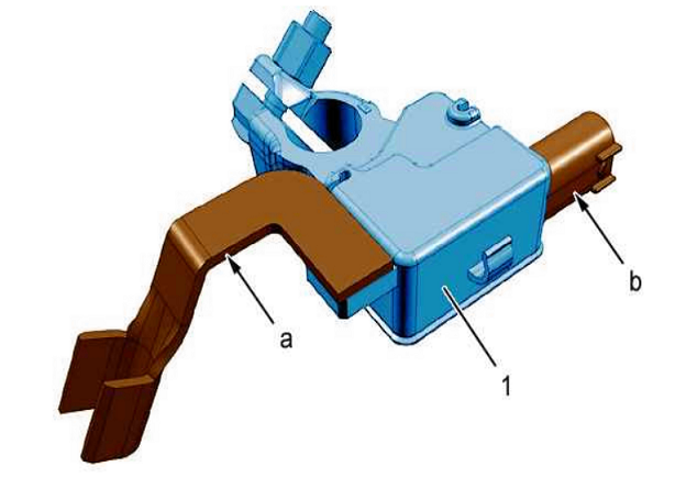

So here is the Battery Charge Status Unit. It is attached to the earth negative terminal of the battery.
Here is the 2 pin electrical connector:
Pin one is the LIN (Local Interconnect Network) and pin 2 is the battery positive supply.
So as the LIN network sends packets of data between a master ECU and other slave ECUs on the network, this is probably why there are faults as the master is not getting any info from the BCSU.
