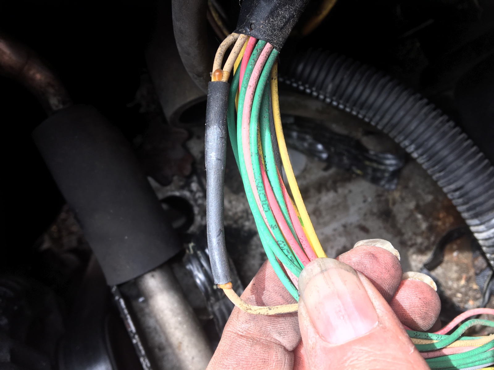

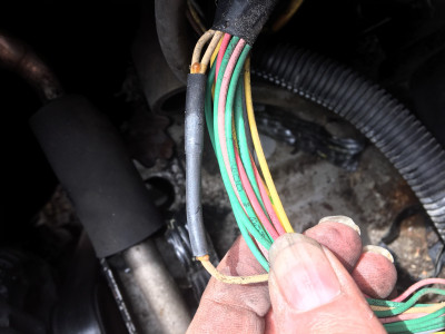

Just revisiting your posts, Wheeler.wheeler wrote: 17 Aug 2020, 13:22 Here is the Injection & immobiliser diagrams.
Id maybe check the communication wires between the Injection ECU & CPH.
pin 7 of yellow connector on the CPH to pin 66 of the ECU
pins 6/19 of yellow connector to pin 36 of ECU.
I would volt drop check them under load.
I had meant to check the serial input line and output line before.
Need to firstly pick your brain on this a bit more. Not sure if you have access to the Diagnosis Manual, mine is for December 1997 on so I hope there were no changes after.
In Diagnosis Manual, I've been through it with a fine tooth comb, under Fault Code 6 (presumably this would be an Elit Fault code?) key not recognised it states there are two types of code:-
a fixed identification code
an authentication code which changes each time the ignition is switched on.
Fault code 1 deals with resupply to the engine ECU and that appears to be something to do with locking to/from? Pins 7 to 66.
Fault code 2 deals with no response from engine ECU and commands from CPH for unlocking and locking to/from? Pins 19 and 36.
Fault code 3 deals with engine ECU locking problem and commands for unlocking, locking and initialisation to/from? Pins 6 and 36.
Now as Lexia reports Unlocked when key is in ignition am I right to assume that it sends the identification code from the transponder to the CPH and then onto ECU which responds via either line 36 or 66?
But when the key is turned, Lexia reports No response from Engine ECU.
Now! I am surmising but the engine ECU has received the identification, it confirms it is OK, and sends some kind of code to the CPH between, I assume, pins 7 and 66 and the transponder tries to confirm the code and sends the authentication code back along either Pin 6 or 19 back to the ECU which then gives, "No response" either because a wire is broken or the code is not recognised for some reason.
As the wires from Pins 6 and 19 are spliced, I am thinking the one of the wires either has high resistance or is broken between splice 820 and the CPH module. One wire from one pin (say Pin 6 for argument's sake) for the identification code and one wire from the other pin for the authentication code (say Pin 19 or vice versa).
My questions are:-
a) Does the above seem a reasoned understanding of how the system works?
The manual indicates that Pin 19 deals locking / unlocking. Pin 6 for locking / unlocking / initialisation and Pin 7 for resupply to engine ECU.
As the relay seems to click once the in-tank pump has primed, I assumed that this was normal though I am not sure it is.
I think now (despite what I have said above) that the CPH is probably relocking the ECU via Pin 7 and 66 because of it not receiving the authentication code (however that is generated) and then perhaps switching (what I call) the primary side of the double relay off through Pins 1 and 29 of the relay (unless my car does have the resupply relay somewhere as described in the Diagnosis Manual) which supplies the fuel pressure regulator and the inertia switch.
b) How would you perform a voltage drop test specifically on such fine wires?
I have an H4 bulb but it would surely melt the wires. If you could be prescriptive it would be a great help. Despite my current level of understanding of diagnostics, don't be fooled. 9 months ago I would have no even entertained looking this deep into an electronics issue.
I feel so close now. I hope it will be rewarded very soon.
I hope this makes sense Wheeler (and anyone else that might like to add) and that you are able to confirm or deny the above.

OK What exactly goes up & down the communication wires is a bit above my head however what your saying seems perfectly feasible.Rhothgar wrote: 18 Aug 2020, 14:59 My questions are:-

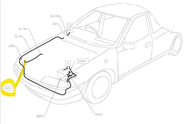

Looking at where splice E820 is located I'd say its definitely worth a check. Splices can & do rot, You can usually see the giveaway green/blue powder, Give the wiring a good tug at the splice & they sometimes just break off, if any doubt re splice it.
To check the wires have both the CPH & injection ECU disconnected. Do a resistance check between 19 & 6 then separately between each of those pins & pin 36 of the injection ECU. If all of those checks are less than 1 ohm check that there is no continuity between any of those pins & earth.
Do a resistance check between pin 7 on the CPH & pin 66 of the injection ECU, If that's ok again confirm there is no continuity to earth.
Normally I wouldn't regard a resistance check alone as a good indicator of wire condition but as this wire will carry virtually no load it should be ok.
If you did want to be thorough you could load check the wires, as the circuit does not carry any real load you would need to add your own load in the form of a bulb.
you will need to improvise some wiring/connections. The wiring should be fine as you will only be loading is for a few seconds but you don't need anything as big a an H4 bulb, A 21w will be fine.
Again both CPH & ECU disconnected
Send 12v straight from the battery down one of the wires (ECU side would be the obvious choice here), at the CPH end connect the bulb & earth it, compare the brightness of the bulb to direct connecting it to the battery, if there is any volt drop you will see a difference in brightness.

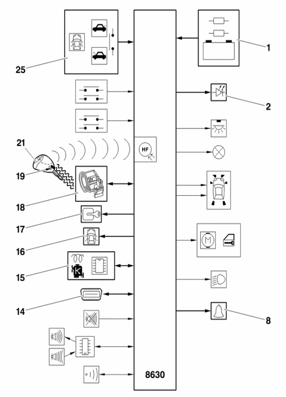

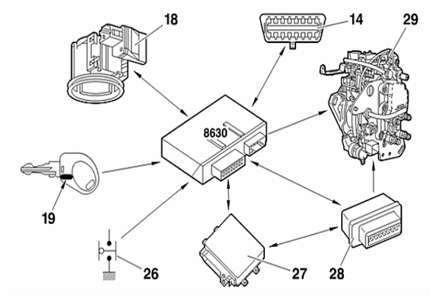

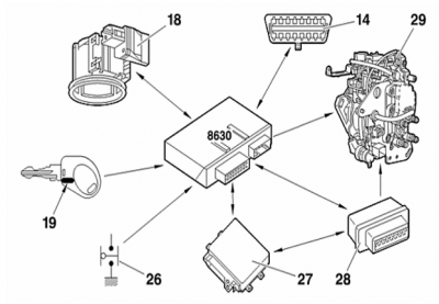

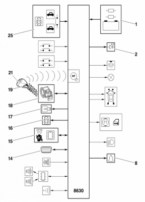

I'm just going to chip in here with some additional info as if and when you are testing there are specific events that take place after a certain time lapse that you may / may not be aware of and that may throw you off-track when you are testing. Pay specific attention to the door opening and timings and the consequences:
Other stuff is for reference.
Further on down, is some detailed info on testing that you might find useful.
Transponder Operated Anti-Theft Device
Operation
Detecting a key left in the ignition
When the ignition switched supply is cut off and the driver’s door is opened, the body computer performs a search to detect if the key has been left in the ignition.
If the body computer detects a key with a recognised transponder code:
The audible signal will continue to sound for 30 seconds after the ignition is switched off if no action is taken.
Unlocking the fuel injection ECU
When the ignition key is in the "ignition on" position:
If the key code is not recognised by the body computer (command to unlock not accepted by the ECM, or if no information is received about its state): The warning lamp on the instrument cluster flashes at a frequency of 2.5 Hz and the audible warning emits a continuous signal either until the ignition is switched off or for 30 seconds.
Locking the fuel injection ECU
The body computer automatically initiates the locking procedure:
Locking procedure:
If the ECM is "locked":
Anti Theft Function Checks
Part (1) Checking the Engine ECU Lock
A) By Using a Key Shield
A metallic shield inserted between the analogue module antenna and the electronic device located in the key prevents the former from reading the latter . A faulty key can be simulated in this way. This shield can be made by drilling a 8 mm hole in the centre of a suspension sphere thread protection cap (1).
Procedure:
Procedure:
Procedure:
Note: The time that the warning lamp is on for also depends on the type of engine ECU fitted to the vehicle, Certain ECUs respond faster than others.
Using the LED for vehicles fitted with an alarm
For vehicles fitted with an alarm, and depending on the CPH configuration (programming), the alarm LED can also be used to check the state of the engine ECU.
Part (2) Symptoms related to the immobiliser function
Part (3) The diagnostic equipment cannot communicate with the CPH
When carrying out a diagnostic check of the CPH with diagnostic equipment, the vehicle lock motors are not activated; The diagnostic equipment reveals a communication failure with the ECU
Part (4) The engine ECU is not locked (vehicle not protected)
The door-open warning lamp does not come on if only the driver’s door is open
Opening the driver’s door will cause the door-open warning lamp to come on
(*): If the initialisation procedure has been interrupted, the number of keys memorised may not be zero even though the CPH is not initialised.
Part (5) The engine will not start
When ignition is switched on, the transponder warning lamp in the instrument panel flashes, and the audible warning emits a pulsed sound
When ignition is switched on, the transponder warning lamp in the instrument panel does not come on. When trying to start the engine, the transponder warning lamp in the instrument panel flashes and the audible warning emits a pulsed sound
When ignition is switched on, the transponder warning lamp in the instrument panel does not come on. The vehicle cannot be locked using the plip.
Part (6) The engine does not stop When ignition is switched on
Part (7) The transponder warning lamp in the instrument panel does not come on when the ignition is switched on
Key
| (14) Centralised diagnostic socket . (18) Transponder analogue module. (19) Integrated transponder. (26) Driver’s door switch. (27) injection ECU (petrol or diesel). (29) diesel injection pump. (28) Injection double relay (supply to the ECM). (8630) Body computer (CPH). |
- The key in ignition audible warning is activated and generates a signal
- The signal is initially fixed for 0,6 seconds, then pulsed at a frequency of 2 Hz
- The red LED goes out (unless the alarm is armed), and the unlocking warning lamp on the instrument cluster comes on
- The system reads the key code
- The ECM informs the body computer of its current state (locked or unlocked)
- The warning lamp on the instrument cluster goes out
- The vehicle can be started
- The body computer recognises the key code
- The body computer transmits a command to the ECM to unlock
- The ECM replies by relating its new state
- Either 5 minutes after the ignition is switched off
- Or 10 seconds after the driver’s door is opened (if the ignition switched + has been cut and if the door is opened within 5 minutes after the ignition is switched off)
Locking procedure:
- The body computer resupplies the ECM via the injection double relay ( 1), or the anti-theft relay (2)
- The body computer cuts the supply to the ECM (resupply relay)
- The alarm LED flashes at a frequency of 2 Hz
- The body computer transmits a command to the ECM to lock
- The ECM informs the body computer of its current state: The alarm LED flashes at a frequency of 1 Hz
- The frequency with which the LED flashes changes from 1 Hz to 2 Hz
- The lock command is repeated every minute
- If the ECM is still not locked after 4 new attempts, then the body computer will cut off its supply (supply restored when the ignition is next switched on)

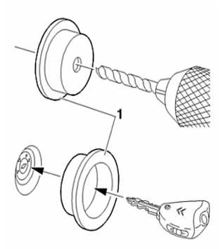

Procedure:
- Switch off the ignition, Open the driver’s door and wait for 10 seconds (the key-in-ignition audible warning stops).
- Insert the ignition key into the 8mm hole drilled in the shield.
- Switch on the ignition using the screened ignition key, The transponder warning lamp in the instrument panel flashes, and the audible warning emits a pulsed sound.
- If the ECU is correctly locked, the engine cannot be started.

Rhothgar
- (Donor 2026)
- Posts: 2432
- Joined: 22 Nov 2004, 00:21
- x 221
Re: Xantia 2.0HDi Non-Start - Lexia Observations and NOW Screenshots!

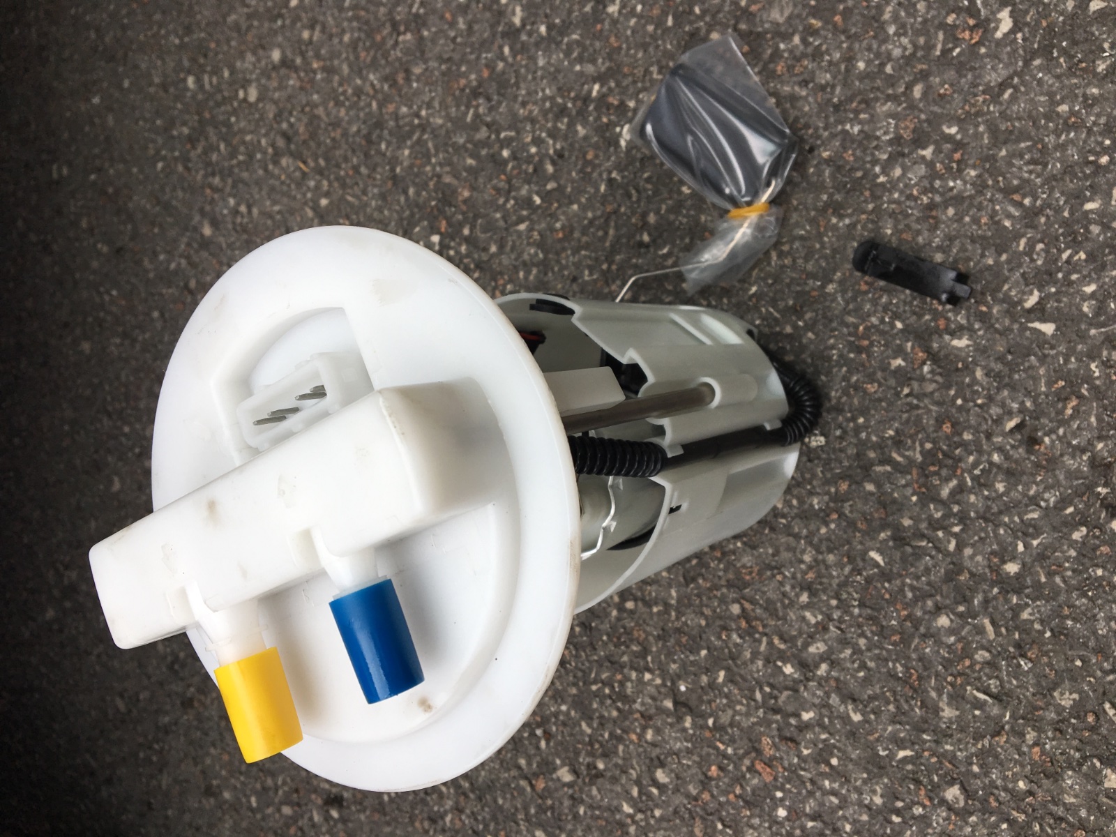

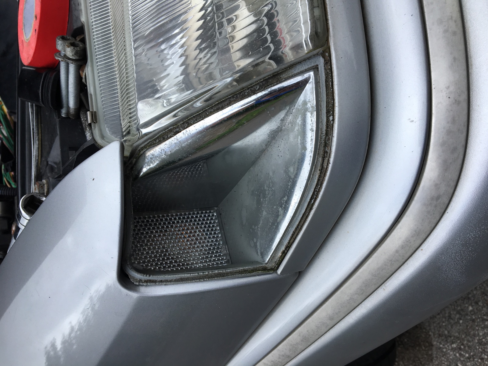

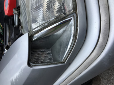

Well that did turn out to be a disastrous late morning and afternoon.
Check IC60 and that is all fine. Not load tested it as yet but will do. No variation in the reading on the Lexia when the wires were agitated as per the Info'Rapid tech doc.
Next I moved to trying to start the engine on carb and throttle cleaner as a volatile compound instead of easy start. Can't see any reason why this would not work in place of easy start?
Anyway, no joy. Problem there is as I have to switch the ignition off because the relay is cutting out when the ignition is on, Lexia then goes back and you need to press the Return button 3 times to validate it and get back into Parameters 1 screen which if the car doesn't start cannot show if the fuel rail pressure has increased. It was worth a try.
So then I turn my attention to splice E820. That looks 100% fine.
I disconnect ME15A earth next to IC02. IC02 internals all look fine.
I drop the bolt into the the gap by the headlight. Forget how to get the indicator out and start to pry it from the side. Indicator lenses came away. Managed to get indicator out. Tried to superglue lenses back on. That didn't work so hit it (more in anger than trying to get glue to work) broke said indicator lenses. Found bolt and put that all back together.
The transponder and alarm system is working exactly as per Marc's post although I couldn't get the LED to go at 2Hz under any circumstances only 1Hz. Not sure if that is a clue to anything.

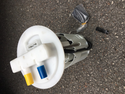

I admit that I also thought hang the expense I'll buy the in-tank pump from ECP. Despite being well packaged a part had broken off somewhere along the line. So that needs to go back. I tried it. It make a slight difference to cranking pressure. I saw 63 bar max instead of 47 bar.
One other thing I did notice was when I put the pump in, I couldn't get the plastic 'nut' to engage right because there is half a tank of fuel in and it was trying to float the pump whilst I was trying to screw it in.
I think I cross threaded it and it was not sealed properly.
Is the green O-ring there to prevent diesel spillage from the tank or to create an air-tight seal? I am guessing but this is irrelevant because the in-tank pump sits in the fuel and pumps it up into the feed so this should not affect booster pump pressure even if the booster pump was not to be locked into place fully.
Managed to get the old pump in again and the 'nut' straight.
This is turning into a right nightmare.
I would rather test the pressure with a gauge before even swapping the HD Pump out as then if I can prove it has gone I could decide to buy a brand new pump and do cambelt at same time. As it is, I am looking for a 2nd hand pump and won't be changing the cambelt unless I can get the engine started ever again.
Rhothgar
- (Donor 2026)
- Posts: 2432
- x 221
Photos of today’s fun and games!

As for the relay, Roger, if I read this correctly then yes, item (2) below:
