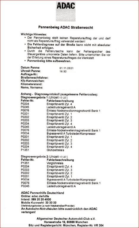

Hello everybody.
Guys! Please give me a hand, too !!! I need to recover my beloved C8!!!
Engine was running and suddenly stopped.... I didn't succeed to restart it since... I replaced a lot of sensors, the injectors, the pump, etc... NOTING!!!
