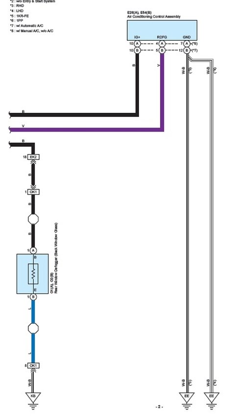

Hi - GiveMeABreak
Please look attachment.
Wiring are the same like in my car Citroen C1.
NO control, timer. Nothing. Only switches.
