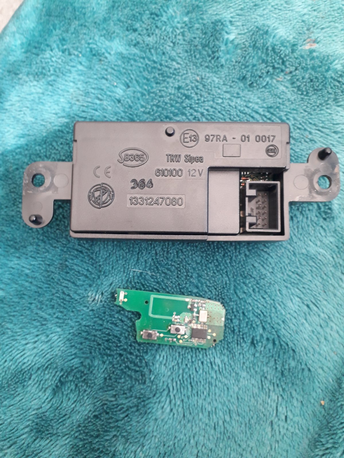

RF reciever and paired key fob chip

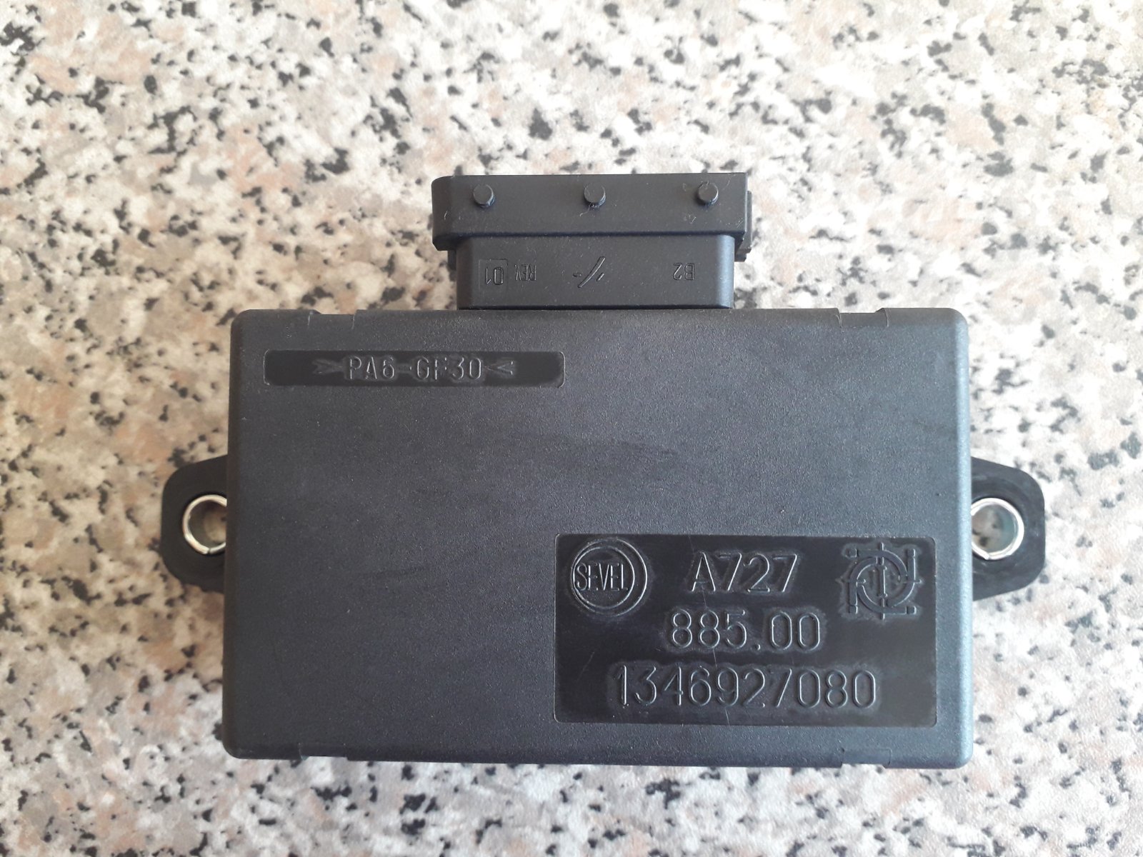

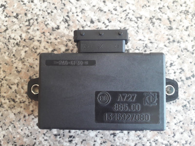

Central locking control unit

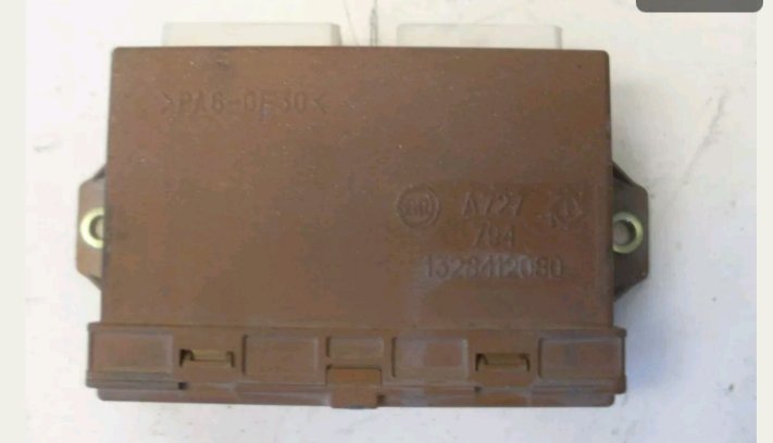

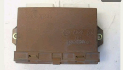

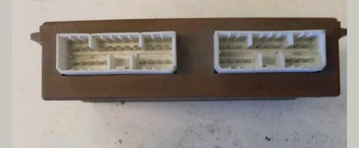

Electric window control module
Part number 1328412080
bnd
Posts: 90
Joined: 30 Jun 2016, 17:15
x 2
Re: 2004 Citroen Relay Key Infra Red Transponder / receiver unit Location
Unread post by bnd »
The electric window control module is behind the dash board, drivers side just above the right hand side of the drivers foot well.
