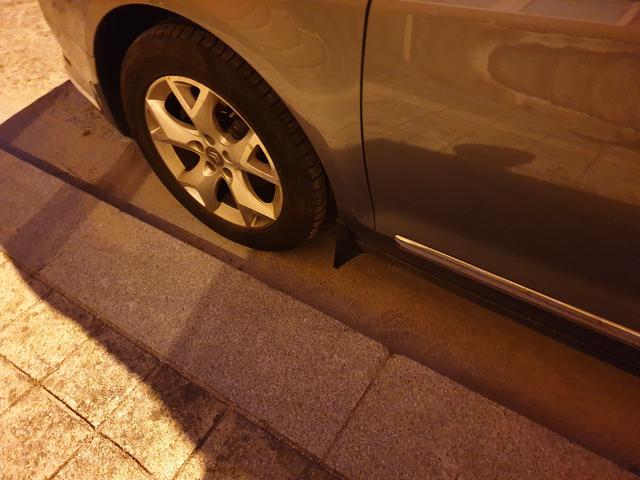

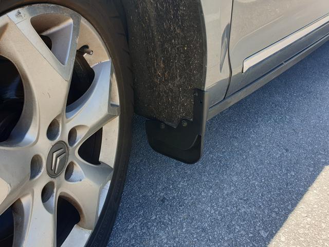

The front mudflaps were dead easy, as two of the holes in the mudflap corresponded to existing screws that hold some exterior trim/wheel arch lining in place:
Just as user Steveo suggested in a thread where I asked about mudflaps (viewtopic.php?p=643008#p643008), I had to drill some new holes in the mudflaps to avoid drilling into the actual wing.

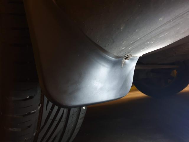

The rear flaps were a bit more of a hassle, what with the wheel in the way and such. I managed to get the job done without taking it off and here's how. First, I made a new hole in the plastic flap's rear, and bolted it to the car using an existing screw, as you see here below:
This way, I was able to align the flap properly, and had it held in place so I could apply the remaining screws.

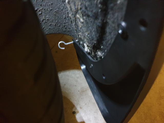

Using a screw-in hook, I made holes in the wheel arch lining, otherwise the crappy screws supplied with the flaps wouldn't puncture the wall.

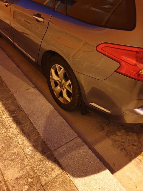

The final result is quite pleasing, since they are very discreet. I do apologise for the terrible quality photos but I haven't had much luck getting around to photographing the car during the day. I park in an underground garage so the light's even worse.
