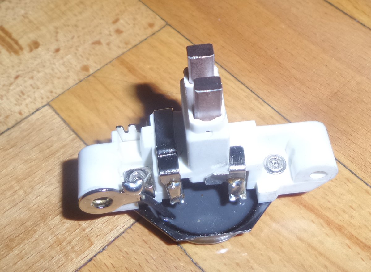

I disassembled inlet manifold, throttle body, oil vapor hoses, the whole intake system, fuel line and oil filter to gain access to the alternator!

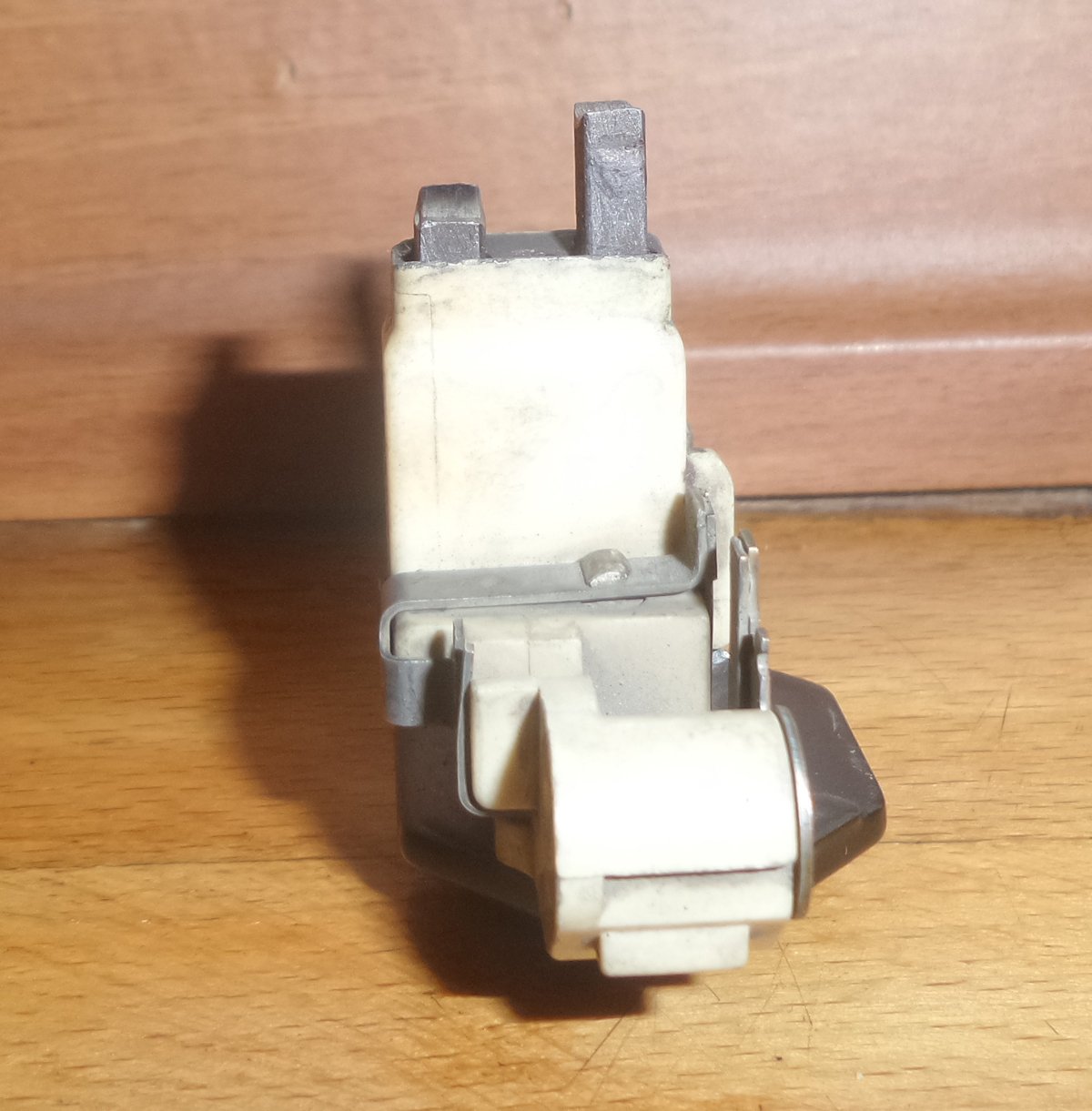

I opened alternator cover and removed voltage regulator. I found the problem. One of the brushes had worn out but the other one was quite healthy.
I suspected the springs behind brushes. I pushed them with my hand and I felt that one of them was weaker than the other and this can be the reason for contact failure between slip rings and brushes. What do you think?

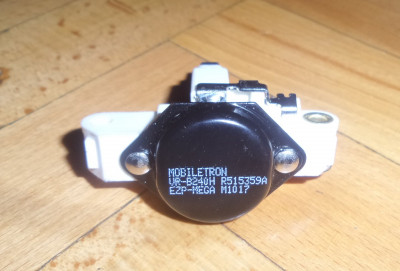

I couldn't find my original Bosch voltage regulator but after searching for a while, I found a Taiwan based company named Mobiletron (Automotive Electronics Manufacturer) which had a website in which they had stated a list of regulators. I found a model that was the alternative of my Bosch regulator with exactly the same serial number.
I checked the spring pressure of the new regulator and both springs had equal force. I installed it on the car and assembled all the parts back. I charged my battery and then started the engine. The battery warning light disappeared and now the voltage is around 14.2V with the engine idling (no load).
The attachments are the pictures of my Bosch and the new regulator I bought.
