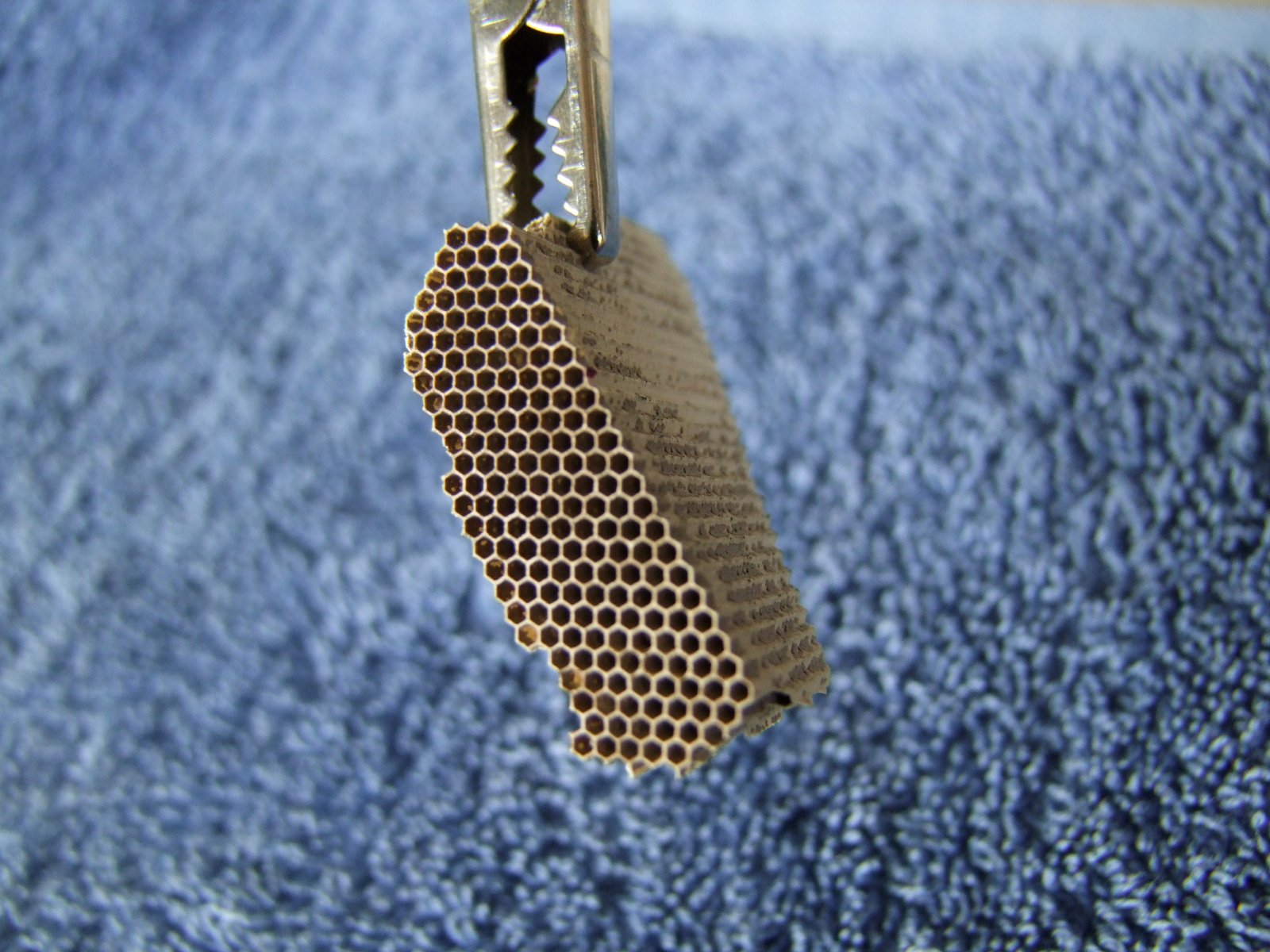

I had a Nissan with a kind of similar fault, it would start and run perfectly for around 3kms and then it ran like a dog. I could get it to go if I floored the accelerator but anything else it would miss, judder and throw different engine faults at me including the occasional limp mode. If I stopped and rested for a while it would start and run fine and then around 3km later.....
A dozen garages gave a dozen different answers. It wasn't until I took the exhaust off (getting ready for a strip down and rebuild of the head) and took the exhaust to a friend to get some fused bolts out that we found the cat had partially collapsed. Cleared it out, reattached and the problem disappeared.
- x 1746
Re: Lack of power (max 2700 rpm)
Had the same on our RAV4 D4D a long time ago. Engine ran out of puff, and struggled to reach 3000rpm. Started and idled ok.
Swung the exhaust to one side, after the downpipe, and the car ran perfectly - and amazingly quietly, since the turbo smooths out the exhause pulses.
Found that the cat ceramic honeycomb was largely blocked with soot/carbon.
Cleaned out (don't ask) and full power returned.
