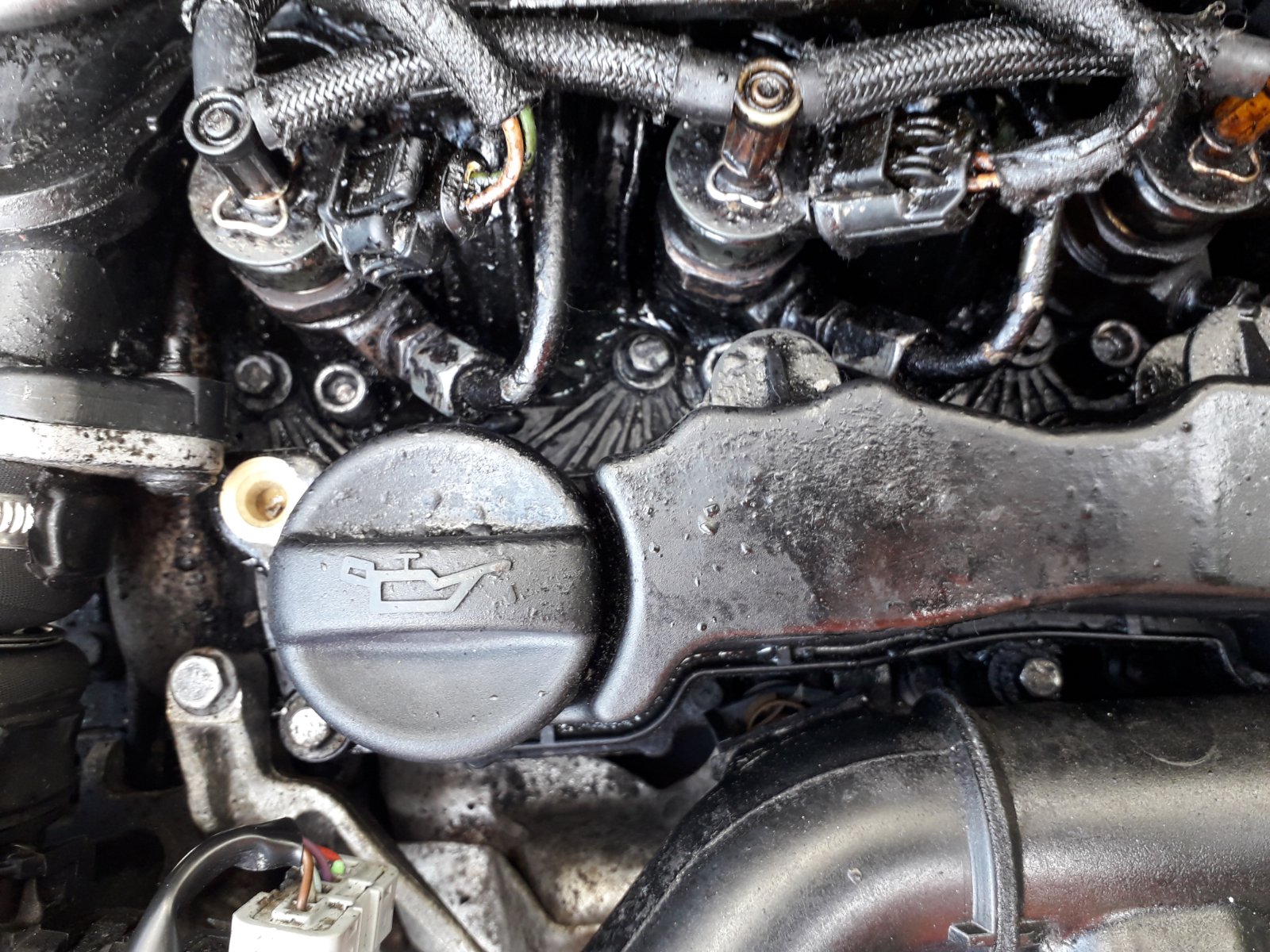

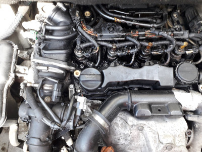

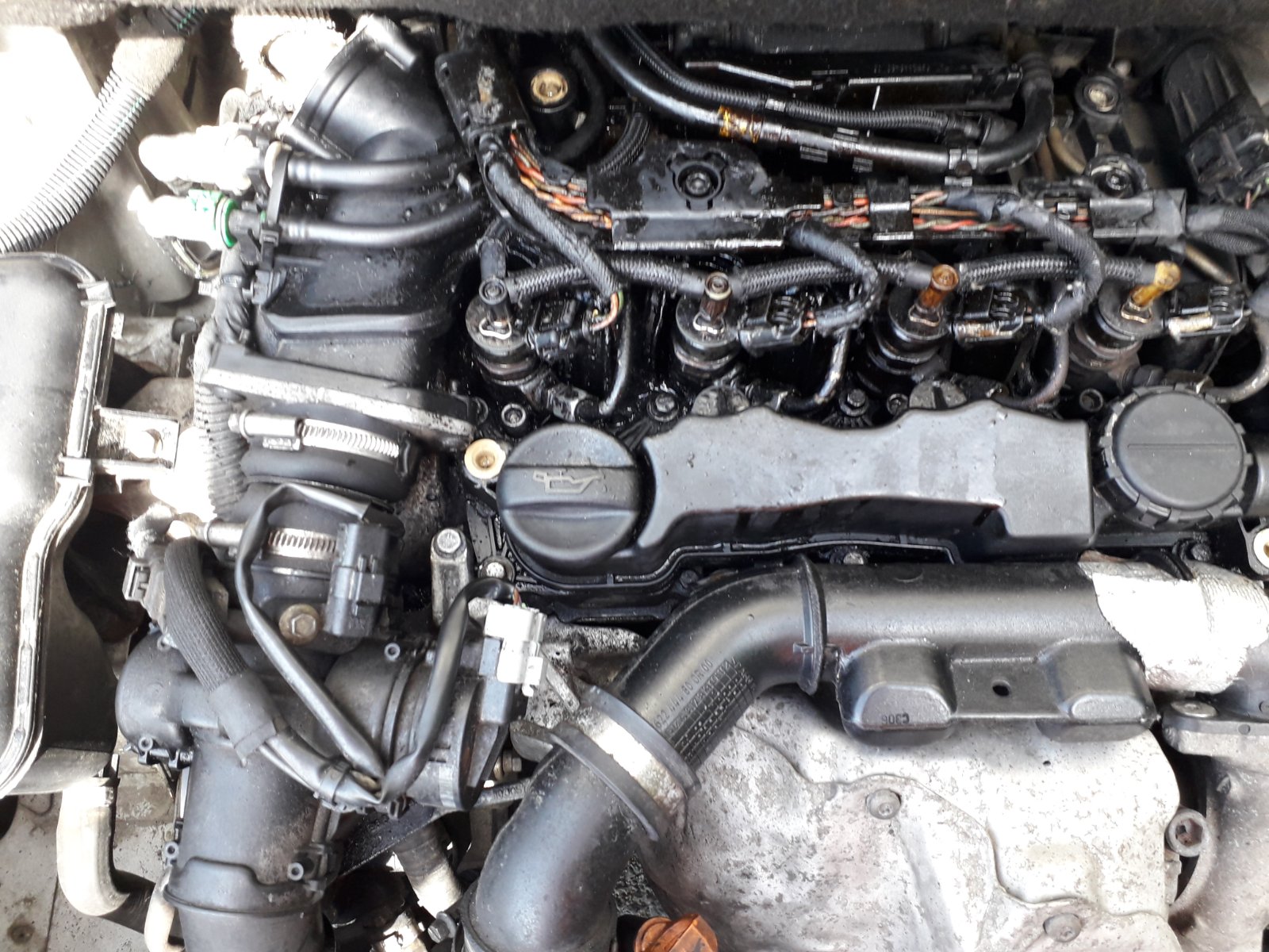

GiveMeABreak wrote: 27 Apr 2020, 11:51 Have a look at this video - it shows where oil can be leaking from the crankcase breather:
Just a heads up guys,
Gave it a decent clean to start off with were it was possible to get to,tooth brushes & then a slight jetwash looks tonnes better,
Seen that video mark(ordered 2 o rings) good price £4.73p inc vat)
Seen a guy and he tighten up,between 2-3 injector,still a slight leak but he said it might settle in a few days
Told us they can be a hand full,if they don't come out first time,& cost a lot off cash to renew,
But thanks for all your input guys..

Just a up date guys,your advice was spot on
Minuscule spray but hardly noticeable.
Seems to be running better also, plus with changing the o- ring t(its still spotless)
