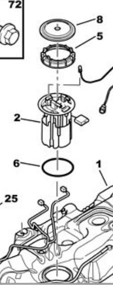

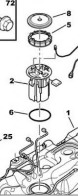

Its seems to be coming from the black capping on and between the sender unit(yellow unit)

Might be worth removing all the bits #8,5,2,6... and cleaning up with alcohol and drying off, and reassembling with the O-ring and surfaces coated with Hylomar Blue, which is fuel-proof. Hylomar Blue available on Amazon.

Apologies - I never updated this when I fixed to explain how I did. Yes so I did eventually get the black cap off and inspected the black O-ring. it had to be replaced as it was a tiny bit kinked, New ring sorted the problem. But my god I was lucky to get away with the hammer an chisel approach to the black cap ring..... It hasn't many notches left on it and it will be pretty hard to remove it again!
