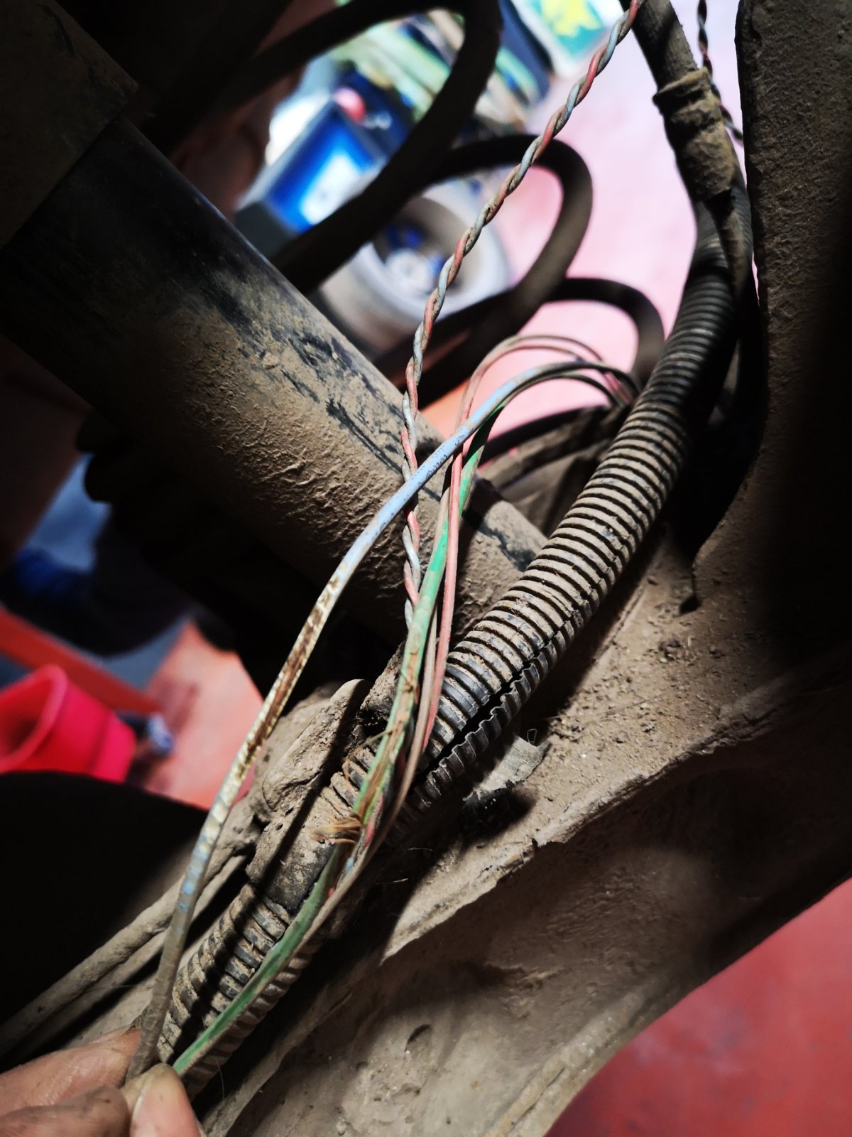

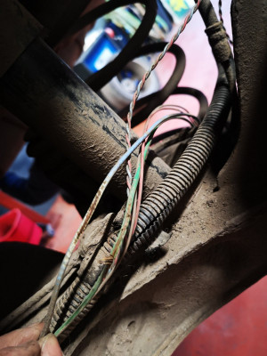

Hi
My handbrake didnt work and ABS lights are on.
I checked the cables and found that there was wires corroded. see attached picture(wiring):

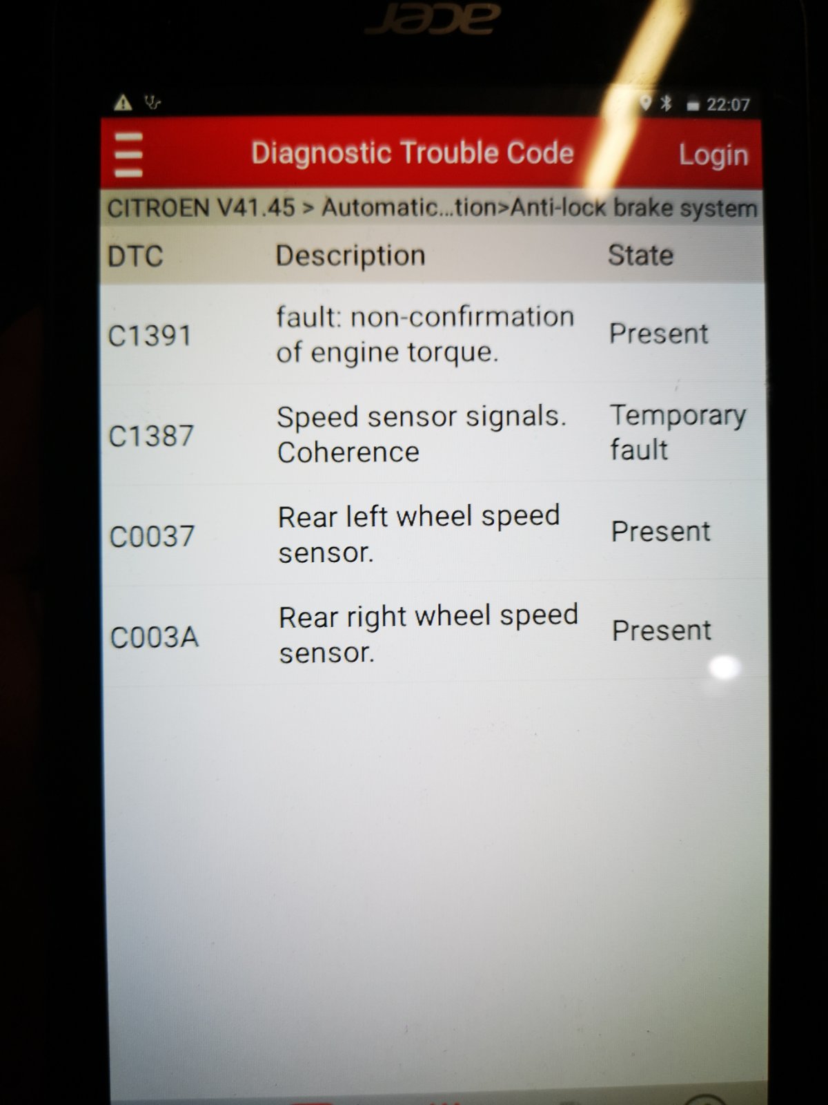

The hand brake is now working as expected but i am still getting C0037 + C003A
Anyone know what the issue may be ?

Got a reply on this issue so i will continue to check the wiring:
GiveMeABreak wrote: At present with only the error codes you have supplied, they be
C0037 01 Rear left wheel speed sensor : Malfunction of the circuit
C0037 11 Rear left wheel speed sensor : Short circuit to earth
C0037 12 Rear left wheel speed sensor : Short circuit to positive
C0037 2F Rear left wheel speed sensor : Signal incorrect
C0037 62 Rear left wheel speed sensor : Lack of coherence of the signal
C0037 68 Rear left wheel speed sensor : Air gap problem (clogging)
C0037 95 Rear left wheel speed sensor : Non-coherent type of wheel speed sensor
C0037 96 Rear left wheel speed sensor : internal fault
It's the same as above for the rear right.
So I would focus on the wiring and connections / harness, and to make sure you haven't knocked or damaged the speed sensors if these have been removed - as they are ultra sensitive to knocks.
I suspect it is wiring / connection related as unusual for 2 sensors to go at once.

I had repaired the wiring my self to fix the handbrake issue. However after a few weeks of working it is now failing again and i suspect the cabling is corroded further up to where i fixed it.
My ABS is still failing and i suspect that i will need to replace the whole harness going to the back to fix the ABS issue and the the handbrake.
Does anyone know where i can get this harness and how difficult is it to replace?
