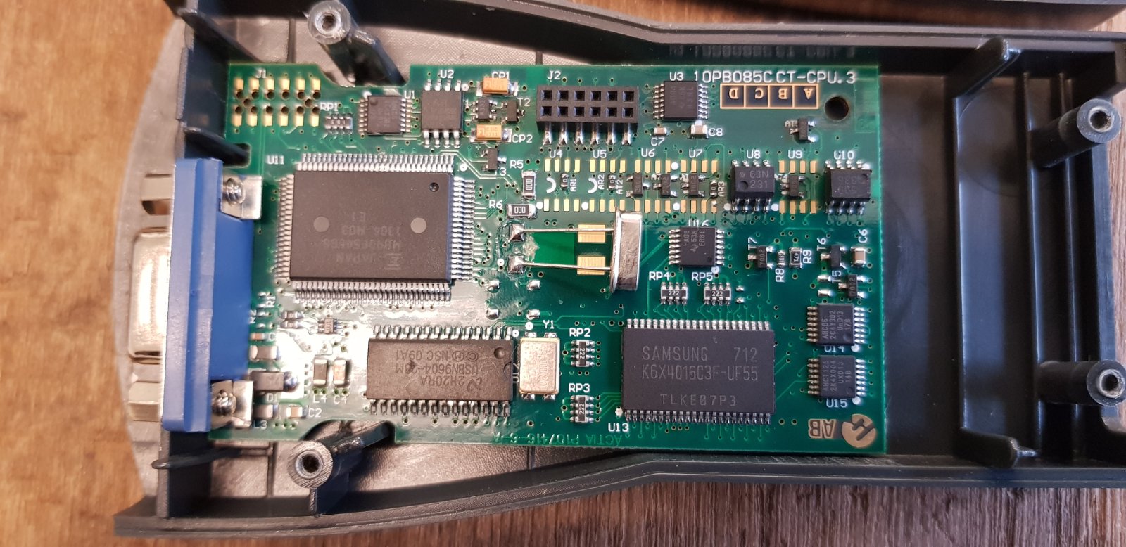

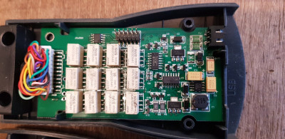

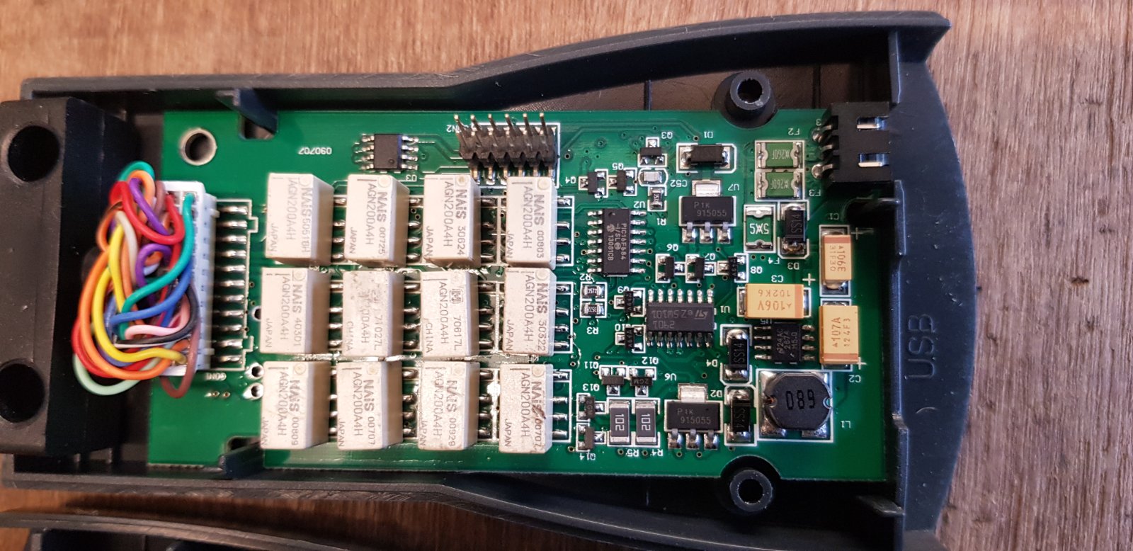

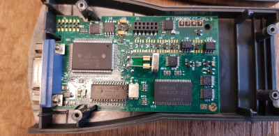

It seems the problem might lay with my clone interface not being full chip. The van is in for MOT on Wednesday and they are going to try and code in the new DPF with their Snapon machine.
I've ordered a new interface that is full chip and I'll see if the option is there even if they manage it at the garage.
Mike.
Mike.
