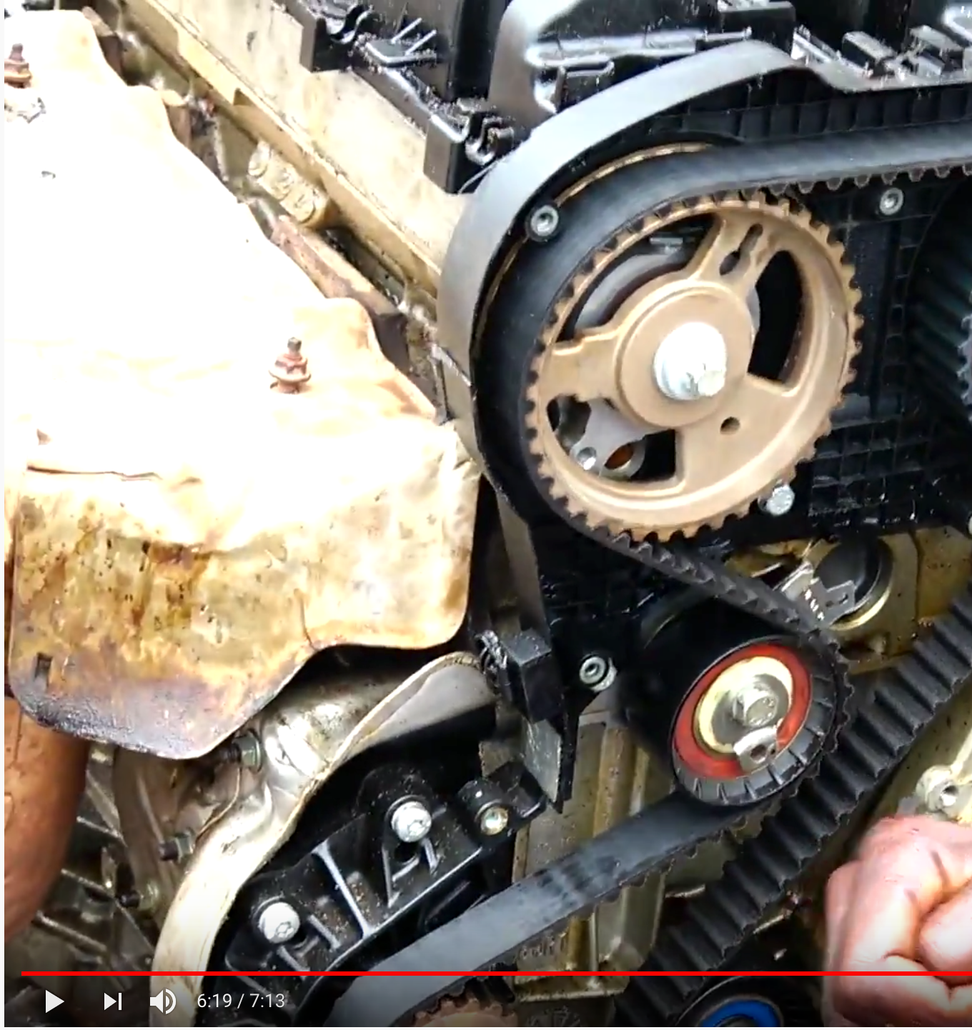

It looks like a "heat shield cover".doctle wrote: 16 Feb 2020, 11:52 I would go with fitting the new pump if the bearing is grumbling it will have to be done very soon anyway. What manual do you have? You seem to have access to engineering tools and machines if it were me I would ignore the manual and take everything off. Is the shield some kind of a blanking plate or protective cover?
I have the Service Box...ehmm...cough...original...cough... but it doesn't show the shield on the drawings.
Anyway.. what i guess and hope, is that it is held by the same screws that hold the pump body, so now i'll go back into the garage and try to reach those screws... if only my hand could be smaller !!

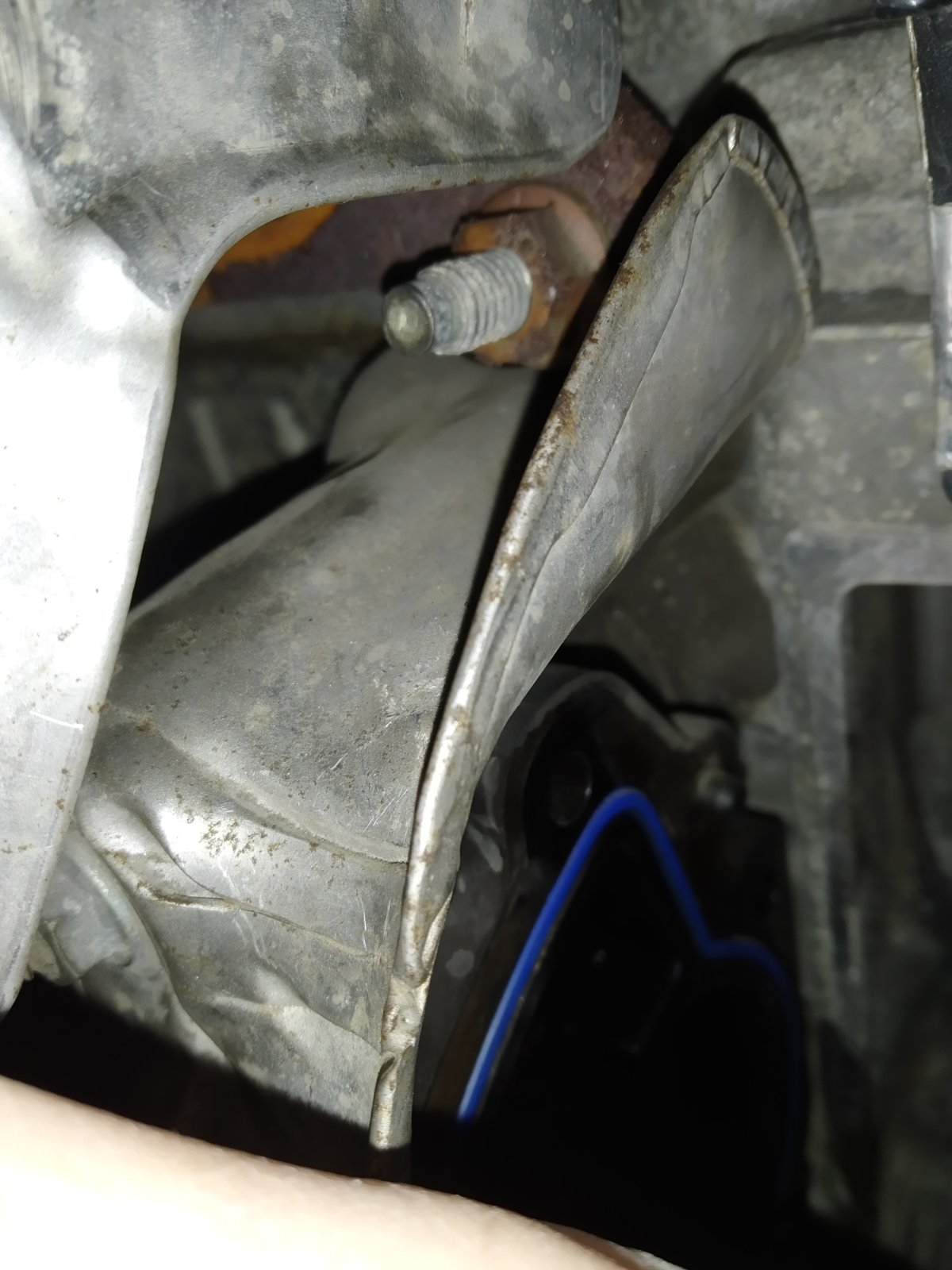

I was able to remove only 2 out of 3 screws that keep this metal shield in place.
The last one is the one in the picture (i was able to insert my phone here and take the picture), and the harder to reach. I have tried with differenty type of keys, i have also lost 2 keys somewhere into the engine...
I admit i start to be discouraged by now... i regret having choosed to change the water pump...
I hope that Givemeabreak can join this thread and give some hints
EDIT : This one is the screw that hold the exhaust pipes... i don't have to remove it.

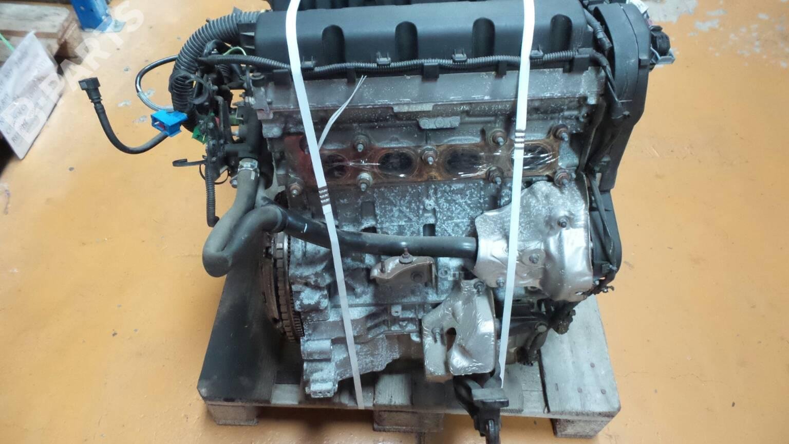

I have found a full picture of the engine on google, with the damn metal shield position.
Looks like there is one more screw to remove

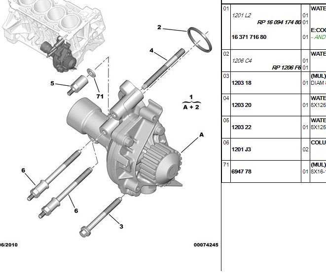

Re: Timing belt replacement, need help
PSA only supply the pump as a complete unit, so it does look like taking the whole thing off is the intended replacement method:
The heatshield 'just' appears to be held on by 3 nuts on the WP bolts - which will then need to be removed to get the pump out. The top stud looks like it will also need to come out, appears to have an E spline fitting on the end to allow this
Edit: Can you access from underneath? Maybe it is one of those things where you need to pull the drive shaft....it may appear drastic, but in fact the time taken will be saved several times over in fighting to get access....

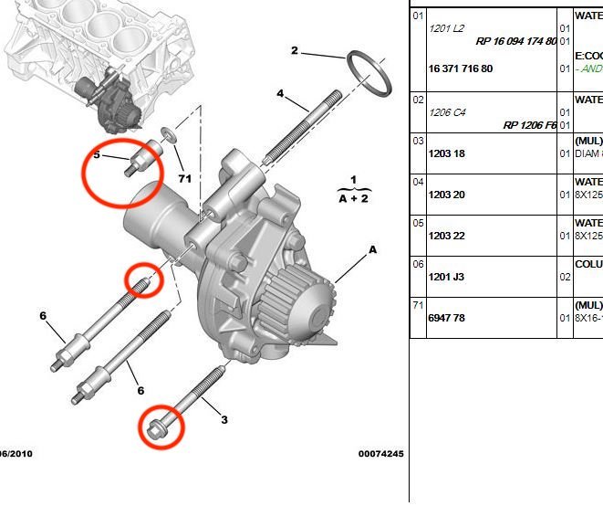

After looking again at the pictures i have took, and the reference images found on youtube and google, i'm 90% that i was able to remove the 3 nuts circled on the image. The one lower left i removed the nut from the engine side.
So i still only need to find the last one and this pump should go away. I'll try again with some contortionism to reach it, without touching the driveshaft.
