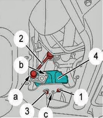

As for the height sensors:
I suggest you try bleeding the system:
- Apply a pressure of 0.5 bar in the LDS fluid reservoir.
- Start the engine.
- Wait for the vehicle height to stabilise.
- Place the suspension height control in the "HIGH" position.
- Place the suspension height control in the "LOW" position.
- Turn the steering from lock to lock in each direction.
- Stop the engine.
- Check the LDS fluid level.
Continue turning from lock to lock slowly about 5 times. Then check fluid.
Start the engine and out the suspension control to normal - but it can take a few minutes to start raising - but you may need to apply some pressure into the tank to get it started. Some use a bicycle pump and a makeshift cap to introduce a little pressure.

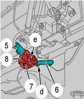

| Front Height Sensor | Rear Height Sensor |
| Disconnect the connector (1). Disconnect the rod (2), as "a". Peg the height sensor at " b" using a 4 mm diameter rod. Remove:
Refit the height sensor ( 4). N.B. : The positioning of the height sensor on the subframe is done with the aid of the pin " c". Refit bolt (3), tighten to 0.4 ± 0.1 daN.m. ESSENTIAL: Remove the setting rod from the height sensor. Connect the connecting rod ( 2), as "a". Reconnect the connector (1). Check the heights of the vehicle. | Disconnect the connector (5). Disconnect the rod (6), as "d". Peg the height sensor at " e" using a 4 mm diameter rod. Remove:
Refit bolt (7), tighten to 0.4 ± 0.1 daN.m. ESSENTIAL: Remove the setting rod from the height sensor. Connect the connecting rod ( 6), as "d". Reconnect the connector (5). |
- x 2941
Re: C5 height sensors
I think the lock pin on the sensor is there to set the arb clamp, different to the earlier cars that required the height to be set by measuring the subframe to floor.
But don't take my word for it, I just can't see any other reason for it being there.
- x 6954
That measuring procedure still applies on all versions of C5 Gibbo - for fine tuning via Lexia. This locking pin I think is to make sure the height sensor retains its position setting when disconnected form the dog bone.
